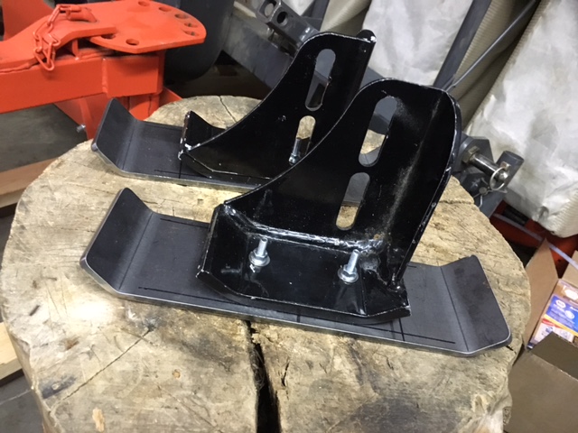

Yours look like they should do the trick. I also have a gravel drive. Here's what I made for my Pronovost Puma snow blower...
   / Quick and dirty mod to my Pronovost snowblower #14
When I had a 3-point blower, I was always "feeding the bushes". At least until the driveway got good and hard. You know, its a lot more work grading the gravel back out of the driveway ditches than it is to blow it there.
