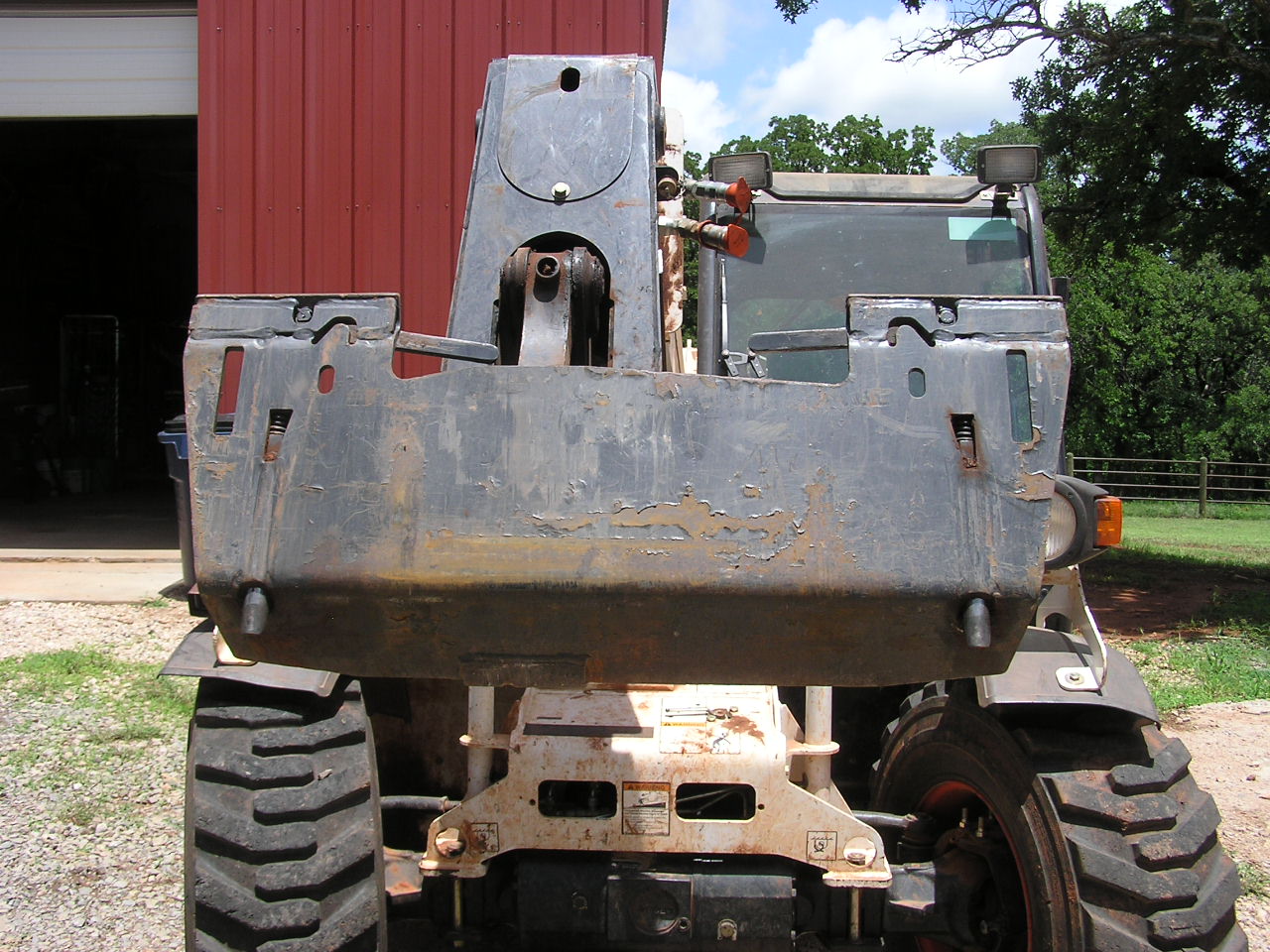

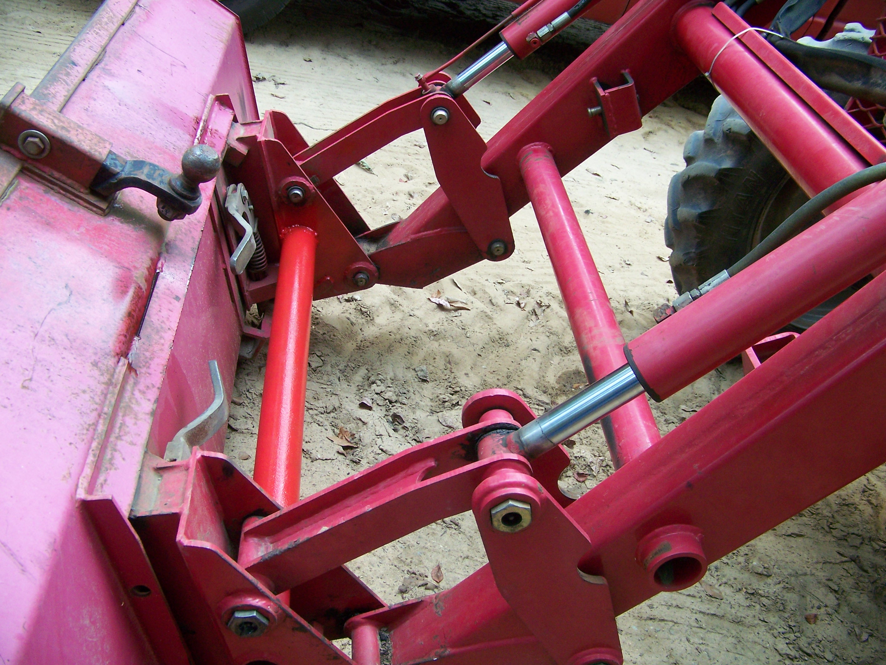

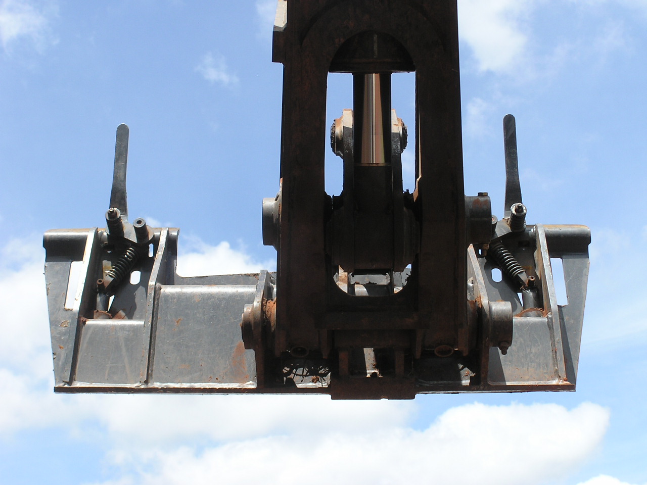

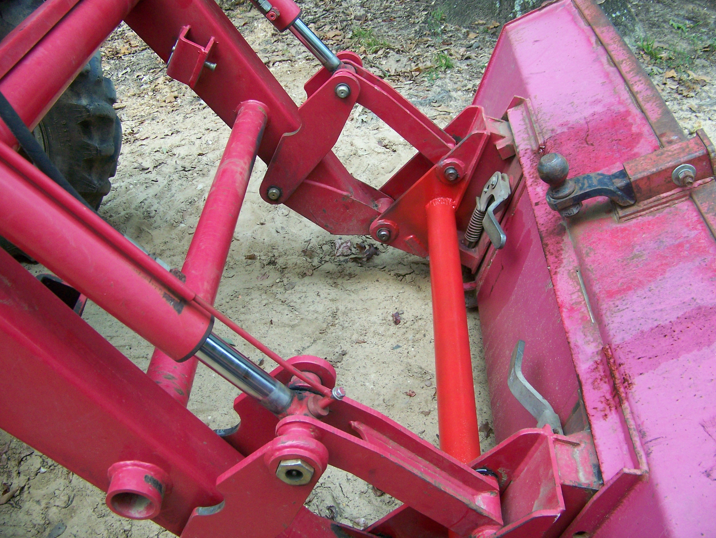

Just posting others pictures and experiences. I add arrows and text to the pictures.
