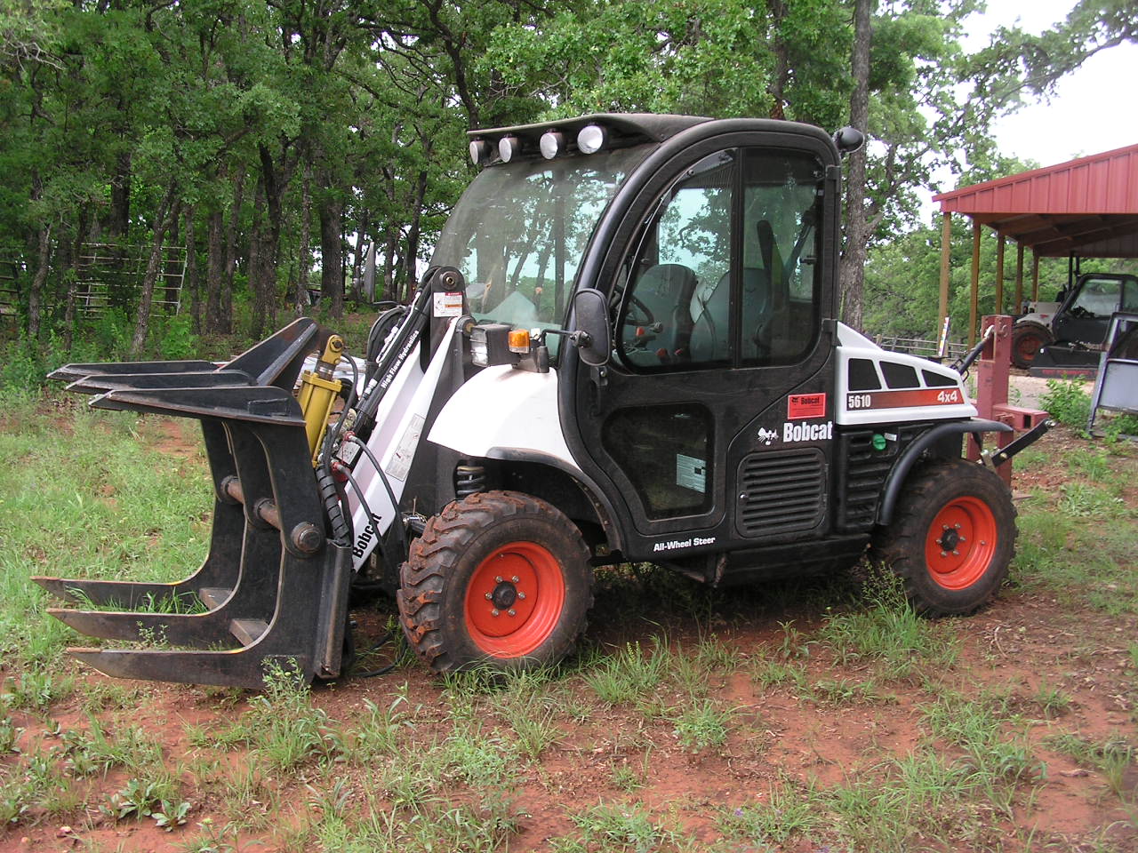

What will you use the forks for?

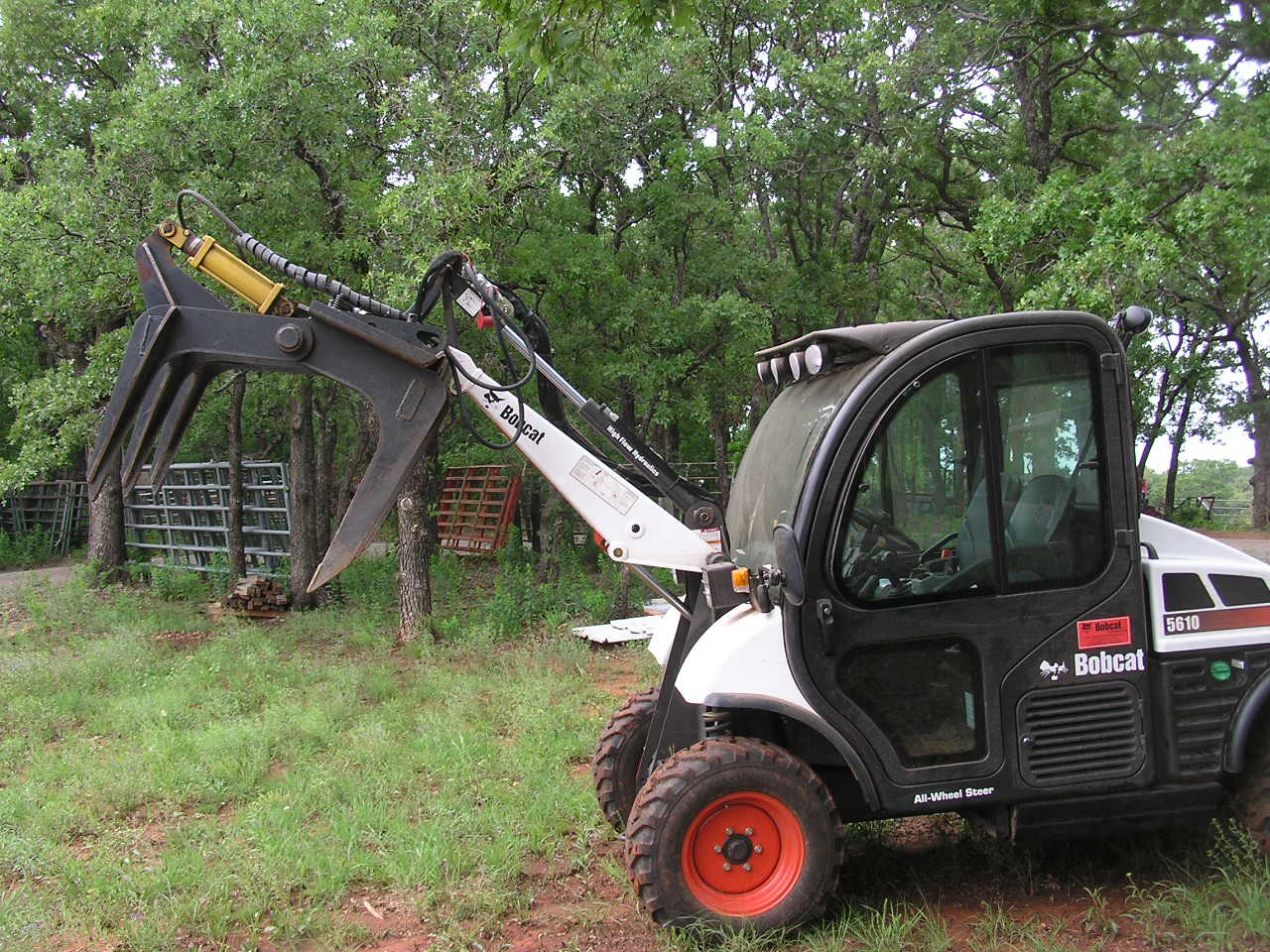

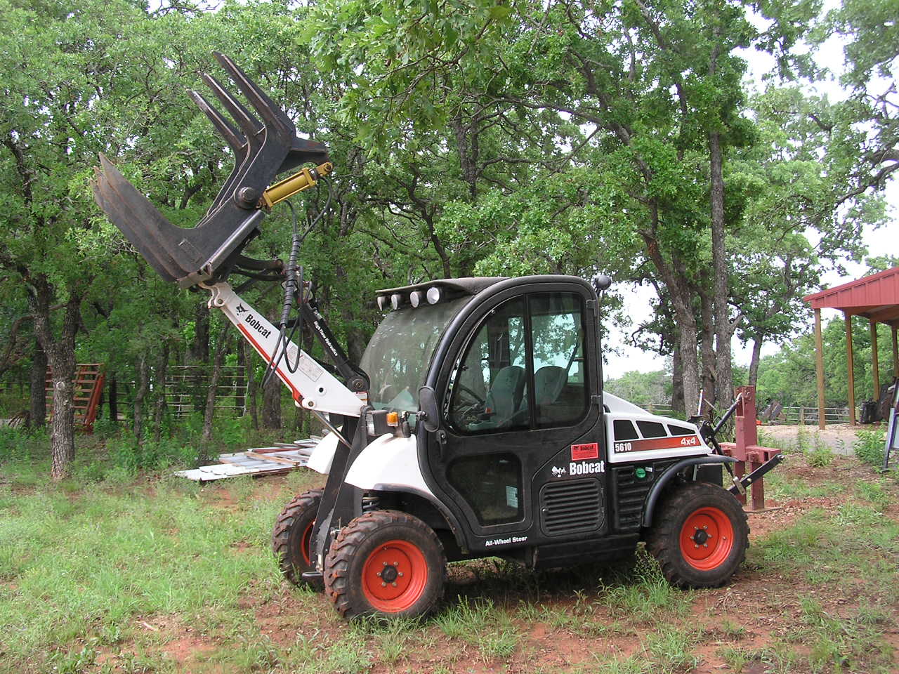

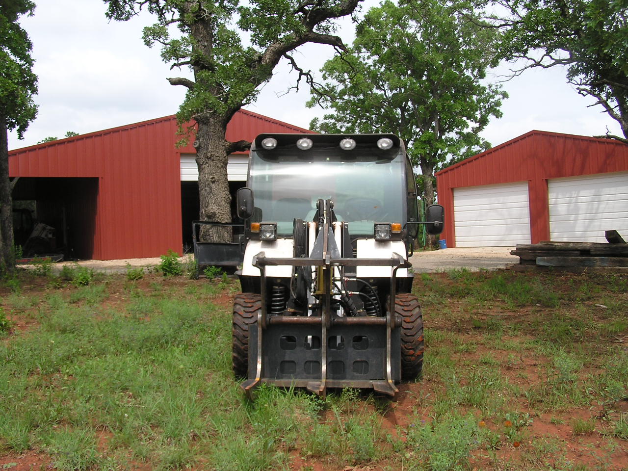

A grapple is very handy.

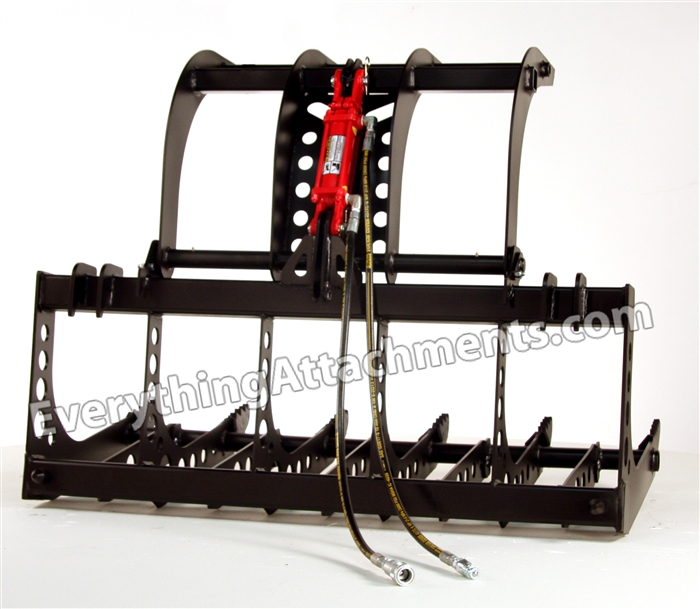

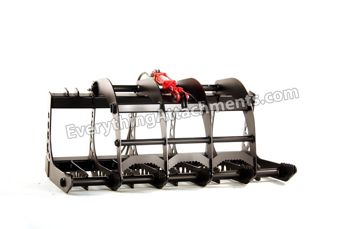

There a lot of homemade grapple threads to give you ideas, if you want to make your own.
If not, check out this one: Everything Attachments Compact Utility Root Grapple 50"

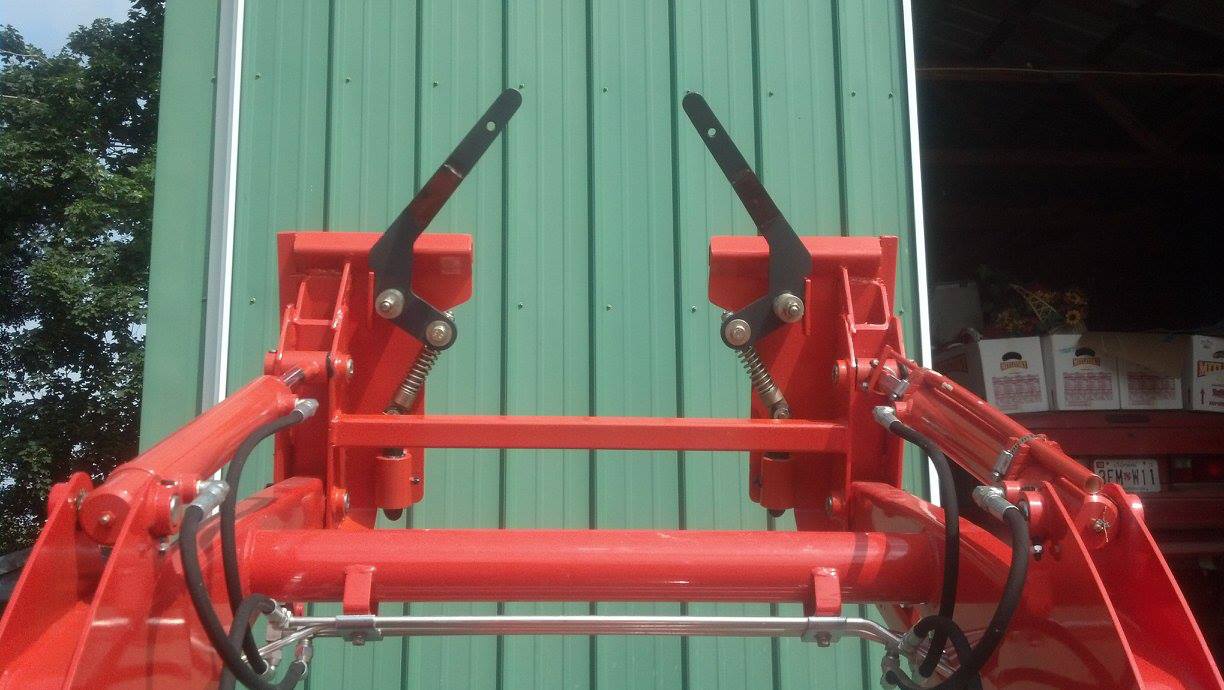

I used those exact plates to build mine,its still quite a bit of work.

Thanks Bandaidmd. They look great! have the held up to your expectations? I don't mind the work just want the best possible attachment method. About how much did yours turn out weighting the way you built them? Have you noticed any power difference after converting from pin to quick attach? sorry so many questions just trying to get as much info as possible.
   / Quick attach for my Mahindra #16
They ended up about 60 lbs, haven't noticed any difference in performance. I thought i could mount my pins closer to the back of the bucket but it wouldn't clear the plate where the lock pin goes in when dumped so i added a piece of square tube as a spacer. If i hadn't had the clearance issues i might have shaved off 30#
Those pin mounts on the buckets are a real PITA to remove, I would just cut thru the back of the bucket and use the two cutouts for additional welds on the adaptor plate if i was to do another one.
