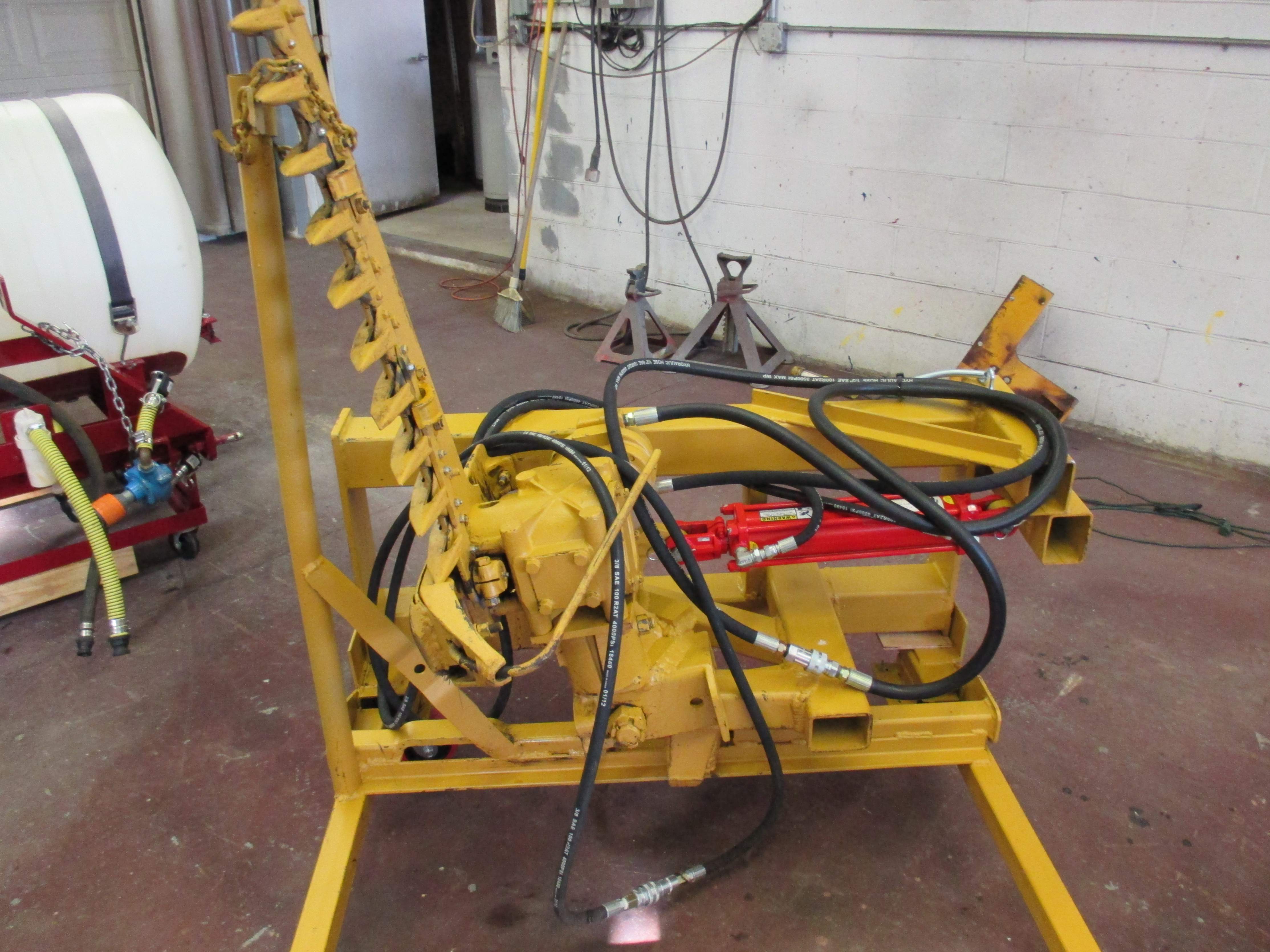

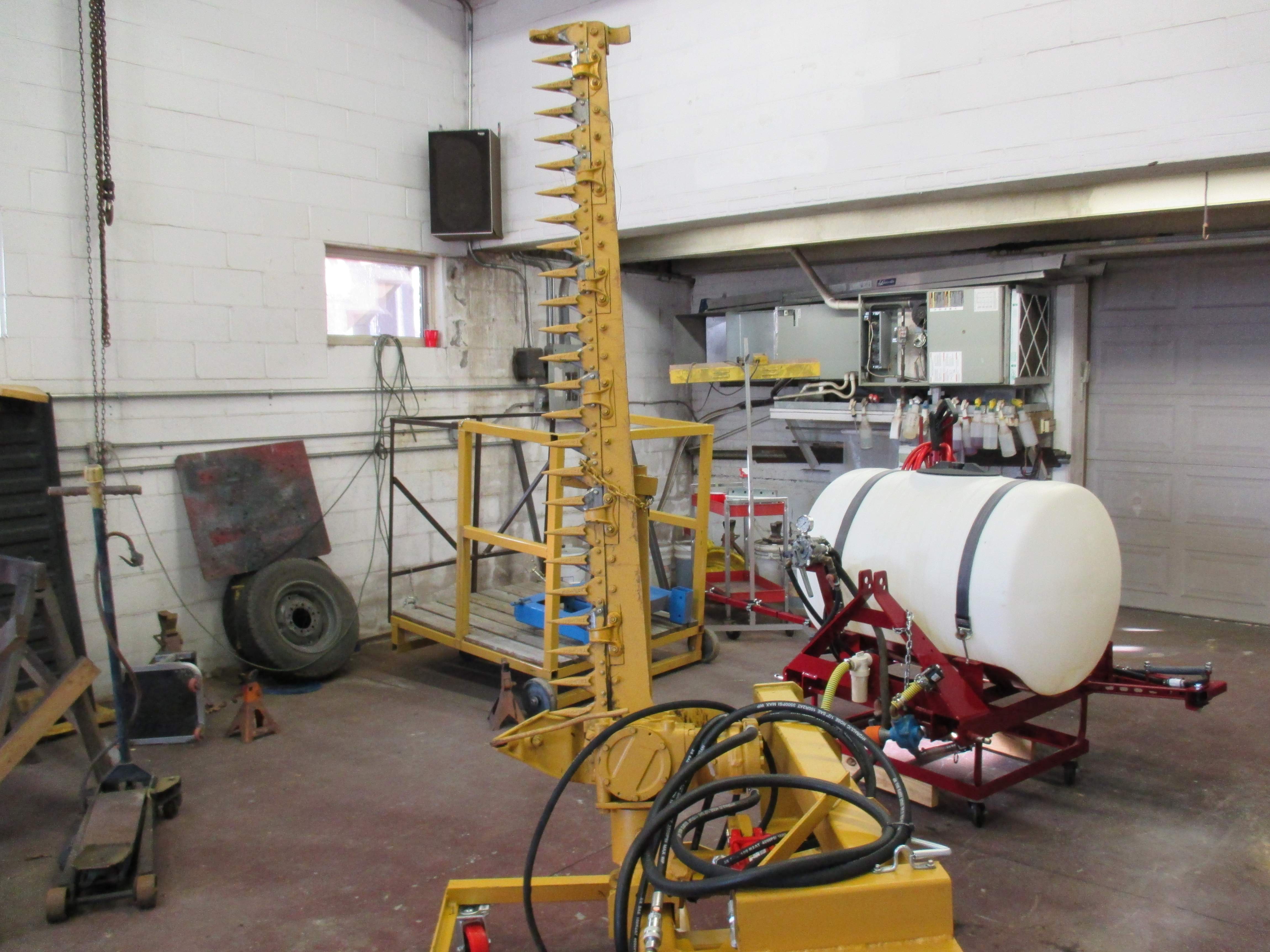

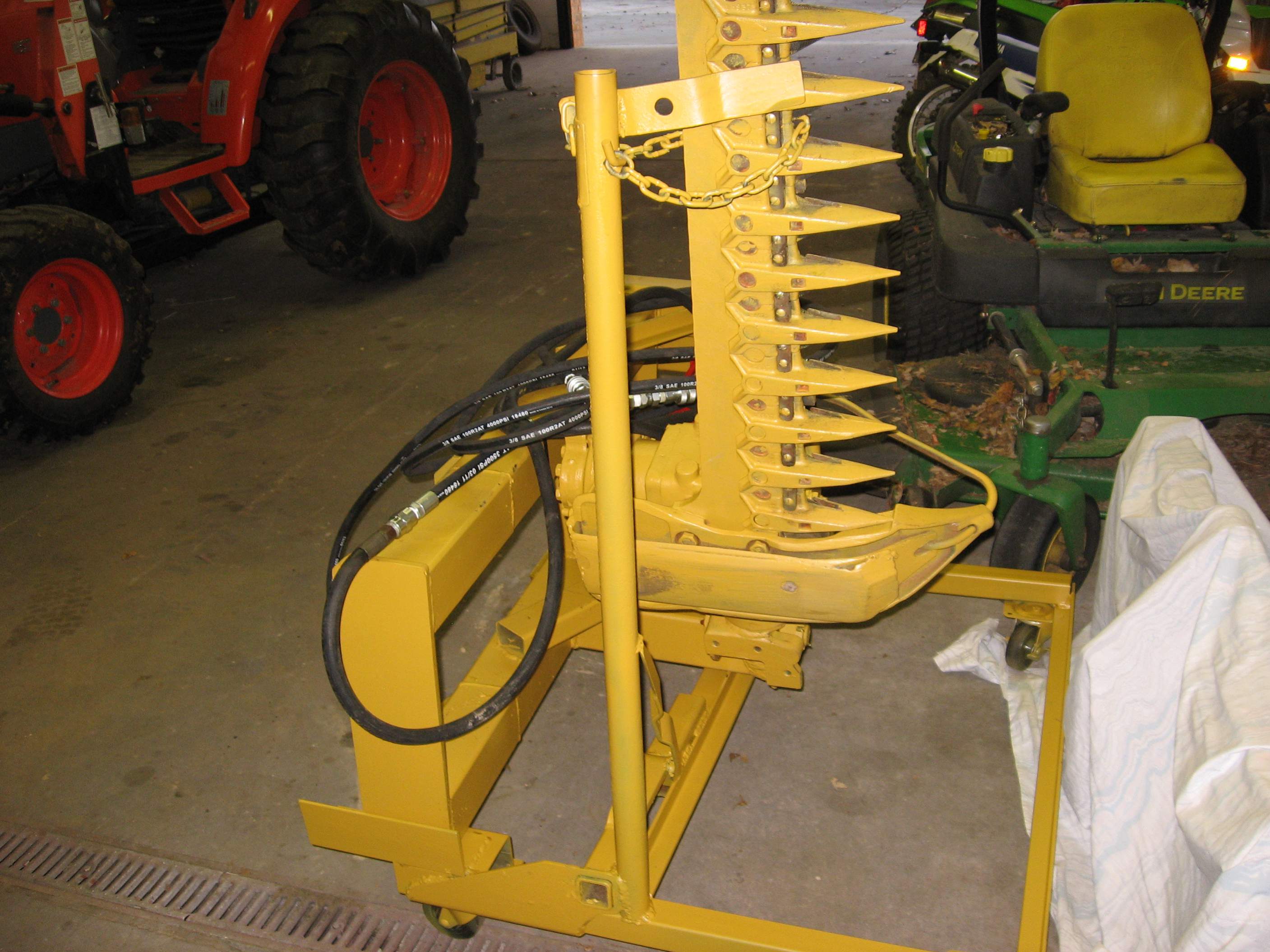

Naplen Yes it does work vertically and way down also. Part of why I made was trimming 100s of feet of treeline around pasture. Also the down position will work for driving across the top of pond **** and cutting low side.
Tom, It was made by Triumph Machinery in N.J. They got bought out by another company cant remember there name. I spent a cold day in the rain to get it for $ 100.00 at auction. Had no idea if it worked or not. When doing research on it after getting it home I saw one on Ebay with bid of one dollar. Never followed up on what it sold for did not want to know. Triumph made commercial mowers and a lot were sold to State Governments I think. Try a e bay search for Triumph. The original design looked completely different. It was a mid point hook up and 2 hydro cylinders for cutting adjustment. Weight was a concern for me it would have been easier to use more of the original mower but I was trying to keep it as light as possible. The 45 seems to handle it fine.
Grapeboy. There is a Utube video of a guy who owned a Vineyard and made something very similar to mine.
Hope this helps everyone. I know there are people a lot smarter than me on this sight and I sure have learned a lot from them over the years.

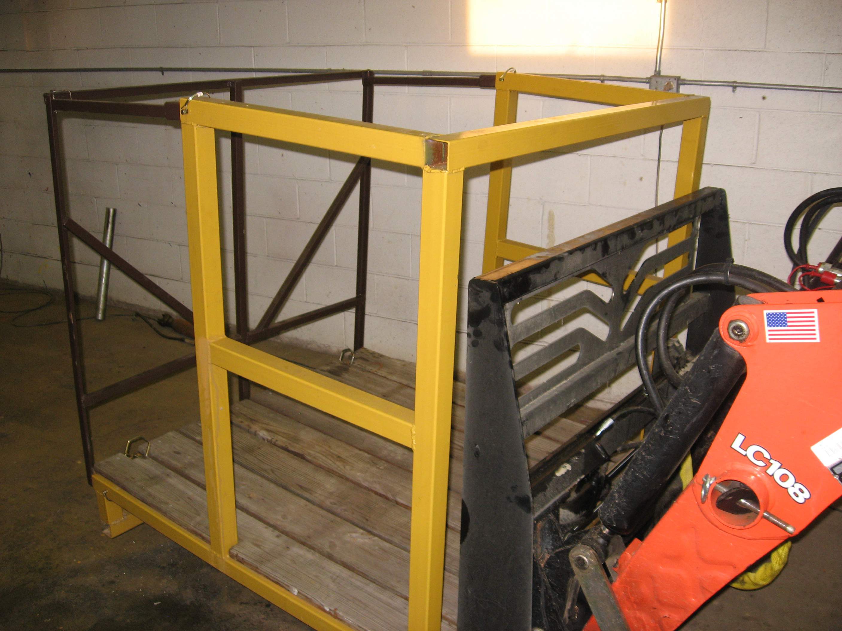

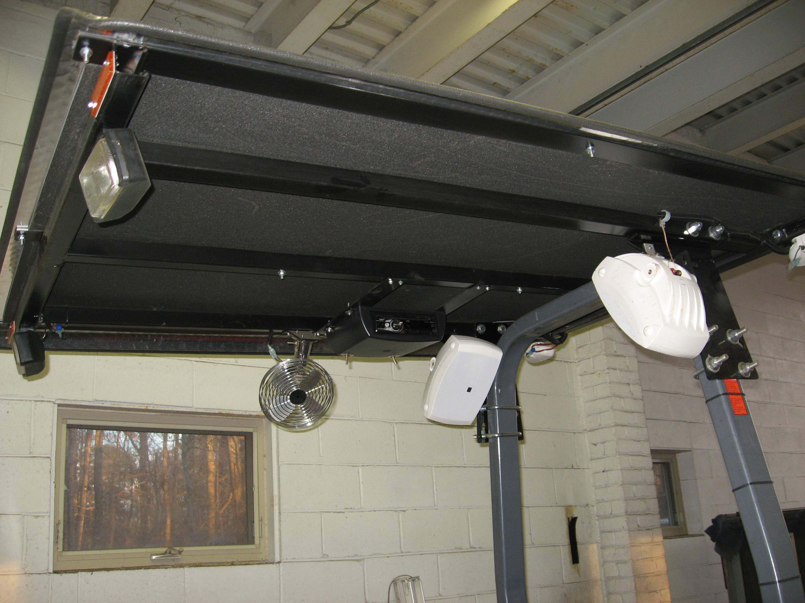

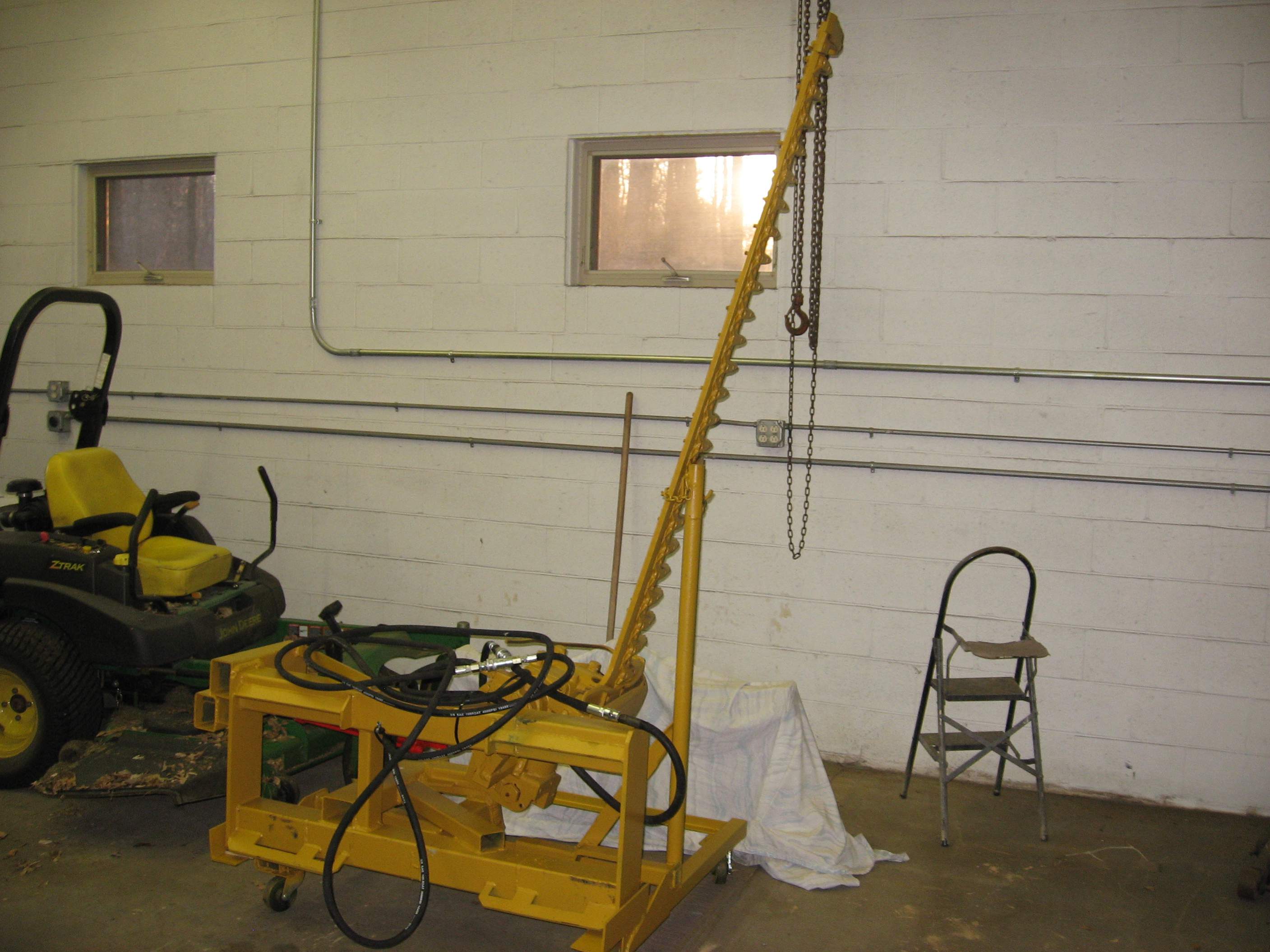

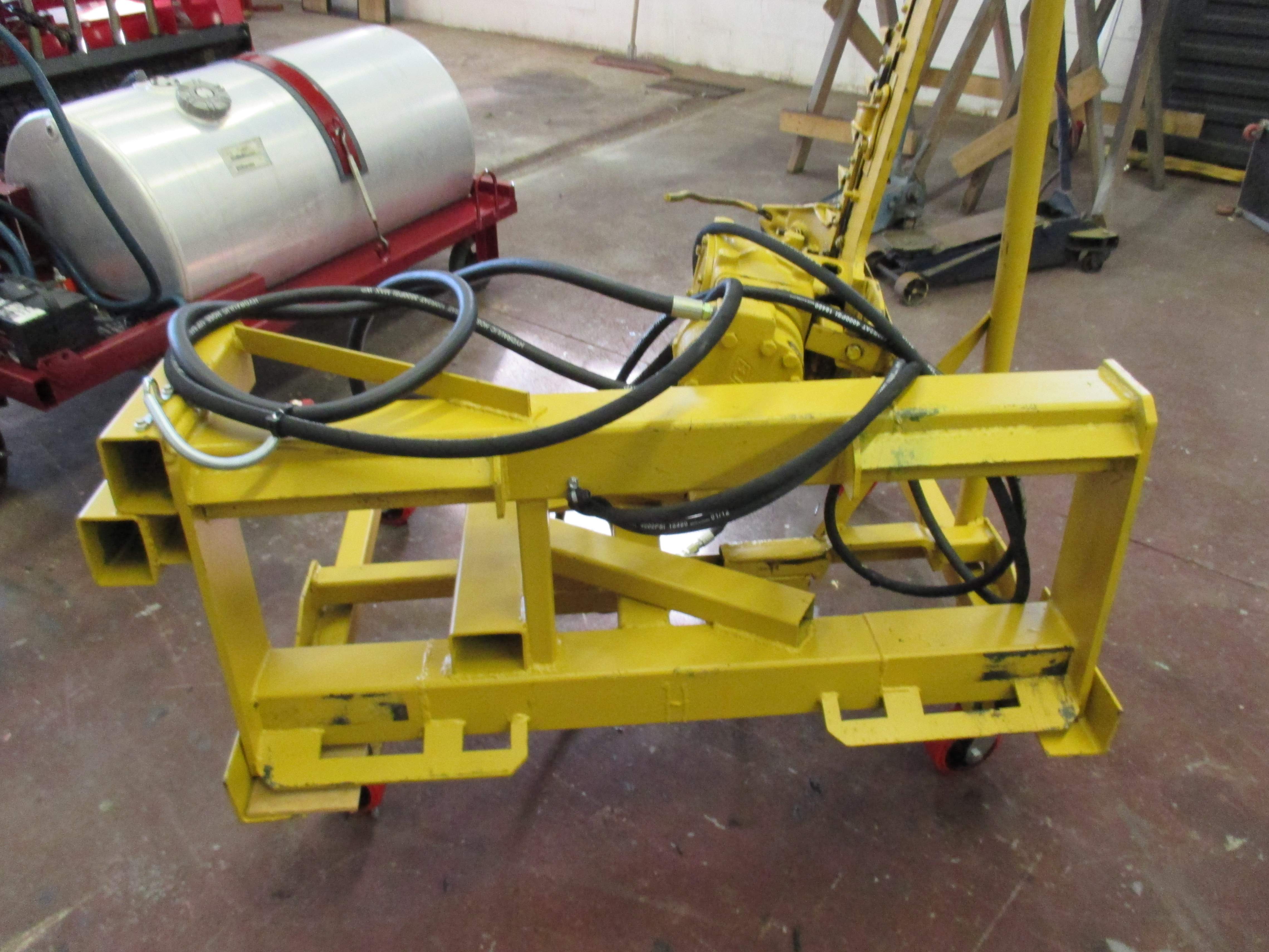

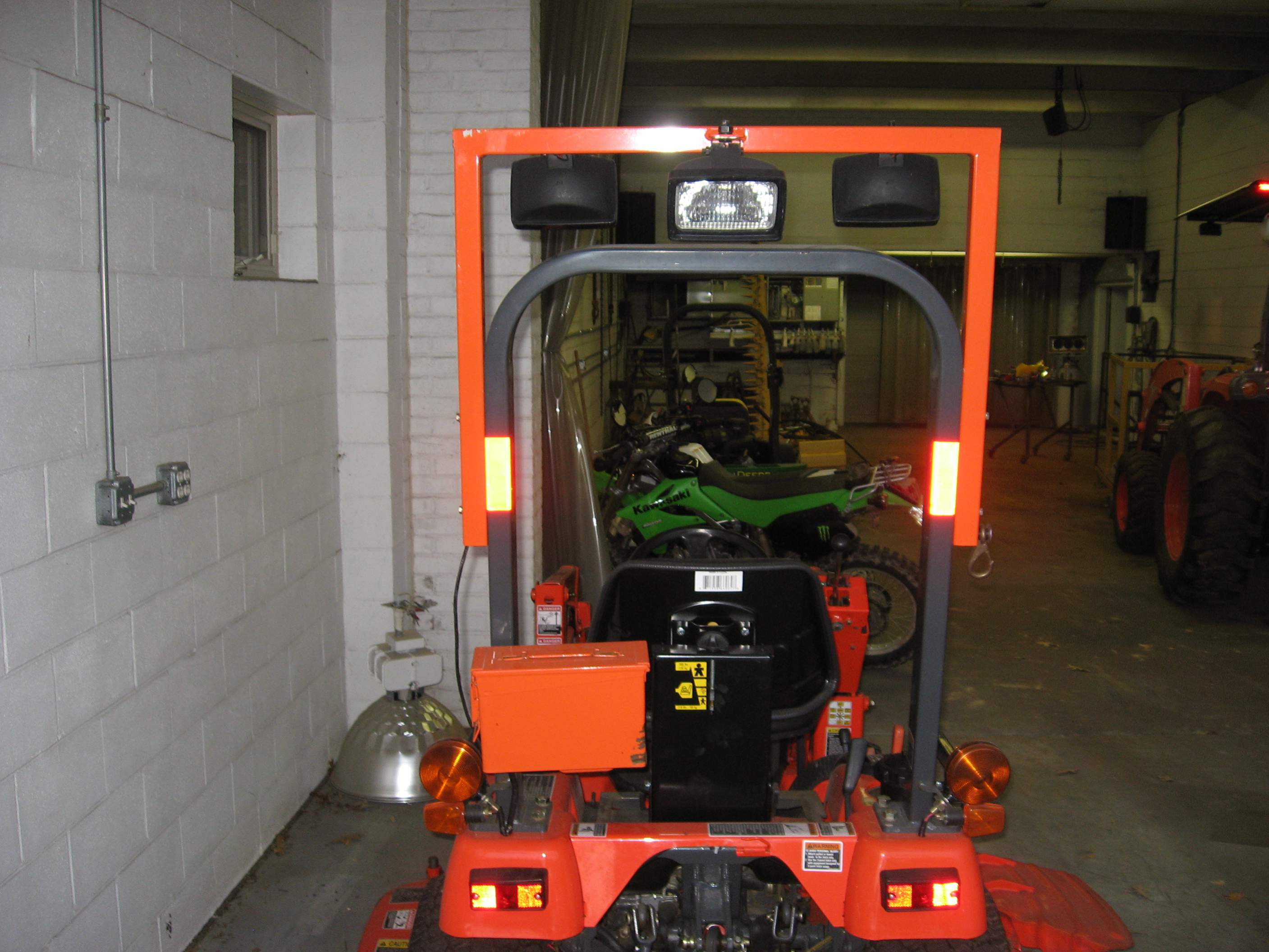

I wanted to add pictures of dolly to move it. And a few other projects I have done
1 Man cage with removable front that also works as storage for pallet forks.
2 Aluminum canopy for Kioti 45 with Radio and fan
3 Light bar for my Kubota. Best thing about it is brass hook for Lowes/ Target bag to pick up trash tractor att 014.jpgtractor att 015.jpgtractor att 009.jpgtractor att 010.jpgtractor att 017.jpg wile mowing

I wanted to put this up for new post looking for font end mower. Sorry could not copy and paste it direct into a reply. I am not a big email-er. Hope it helps

It was made by Alamo who bought out Triumph. They still have most parts for it I bought several from them. The don't have the sickle hold downs anymore so I bought 20 of each on ebay just in case. Everything else can be bought and is stocked by Agri Supply. I have the original owners and parts manual also. I took some pictures of it on tractor showing full up and down motion plus height and length when I brought it back from farm. It seems that my computer ate them. I will post them when found or hook up again and take more and post them.
Scott
I do have a few after 2 years of use and a good pressure washing.
