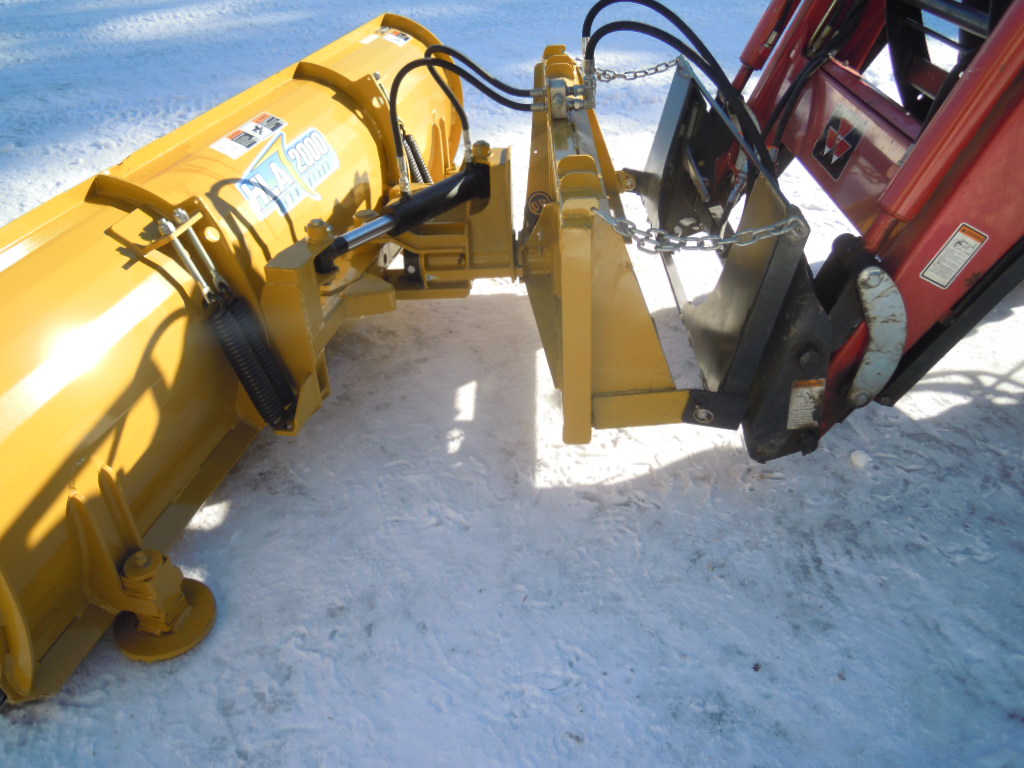

Almost 3 years ago I bought a front mount, hydraulic angle plow and quickly discovered it did not work well on my long, winding, up and down gravel driveway. So I came up with a temporary solution to make it float. I figured if the temp solution didn't work I could return the plow to it's original state and sell it. However the temporary solution worked better than expected and I am still using it today.
I agree with the person that said fixed plows work well on relatively even / flat surfaces but not on undulating surfaces. My driveway is one mile long, narrow, steep and gravel with a lot of twists and turns plus it rolls up and down. Using the plow in a fixed position was scary and did not work well, no matter what I tried or how hard I focused on keeping it at the right height. After adding the float, it works very well.
The plow I have is an HLA 96" plow with hydraulic angle and rotary oscillation (this allows it to follow the cross slope on the driveway). With my solution I also get the benefit of having a fixed plow by simply tilting the fel forward, which forces the rear mounting plate to contact the plow mounting plate. When I do this I can easily lift the front of the tractor off the ground, if I desire, without causing damage to the plow system. The disadvantage to this mounting system is that it moves the plow slightly further forward. I'm guessing about 6".

Mr. Hilbilly, your plow seems somewhat unique with the rotary connection.
It would be good to put a post over in the long running "Show Your Snow Equipment" thread.
It seems like a solid, efficient set-up.
