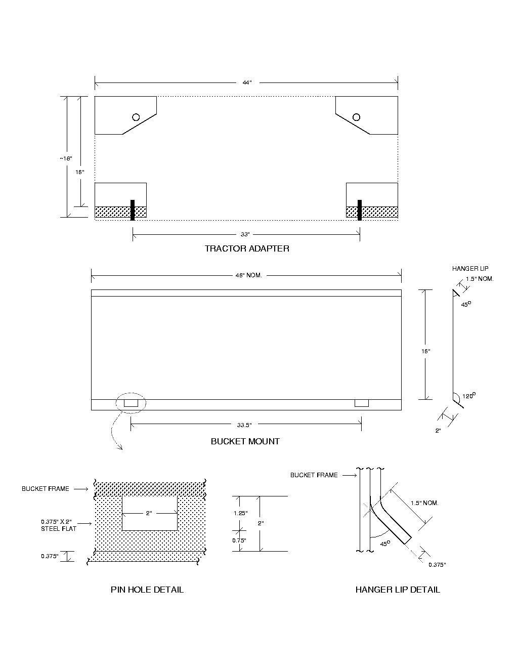

Digging further there actually is a document available for purchase:
http://www.sae.org/servlets/productDetail?PROD_TYP=STD&PROD_CD=J2513_200006
Note this describes the attachment side only. I'm not too motivated to
pay $60 to get the definitive spec of where to cut two holes and weld a
strip of steel.
Attached is a quick & dirty drawing taken off of my TL1709 and
bucket. Pardon the low res. I had to stomp on it to get under the
100K attachment size limit.

SAE J2513 covers the attachment side of the quick attach, in other words, the bucket portion. There are no current specs/standards for the "male portion" of the QA.
Grand L loaders with QAs were the loaders that have the compatibility issues and not the L48. Your TL1709 QA should be fine unless the attachments are out of spec with the SAE J2513. The "A" on the TL1709A QA is most likely a vendor change.
