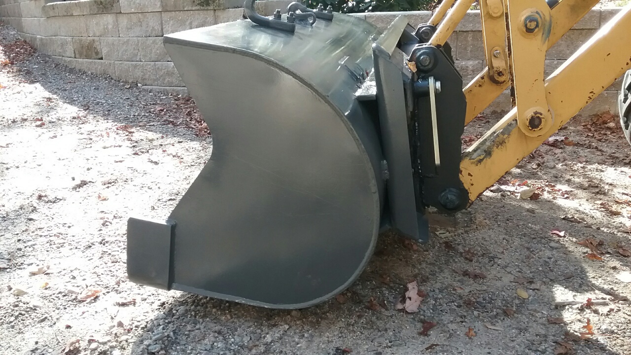

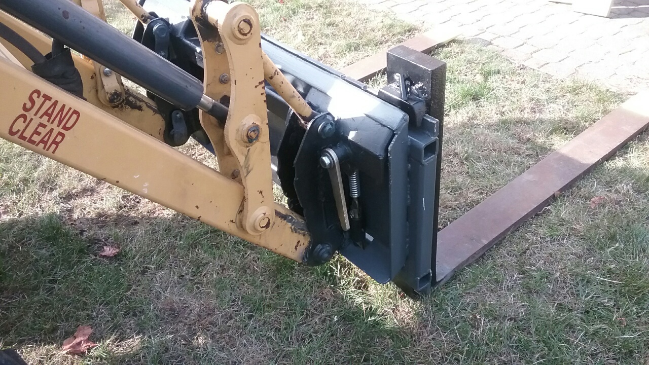

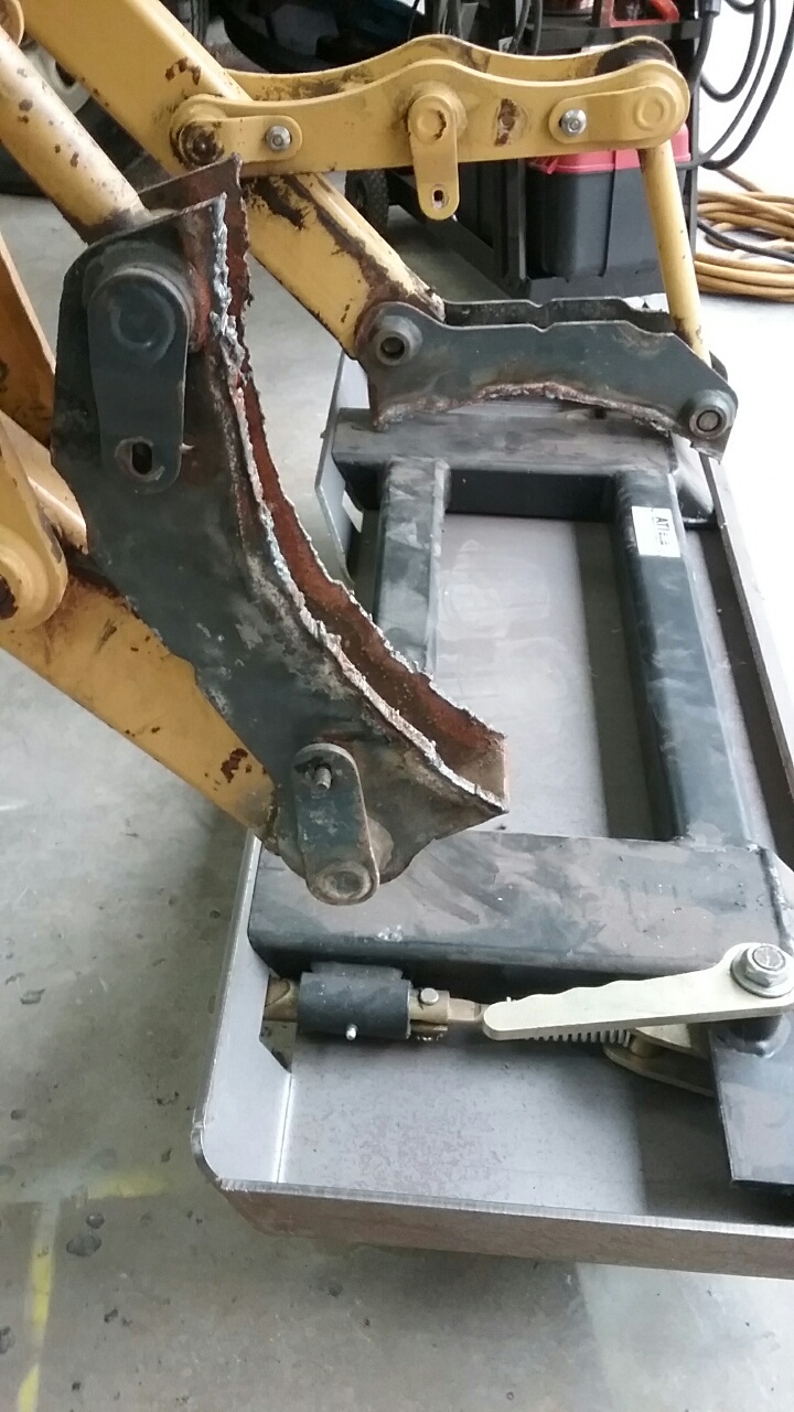

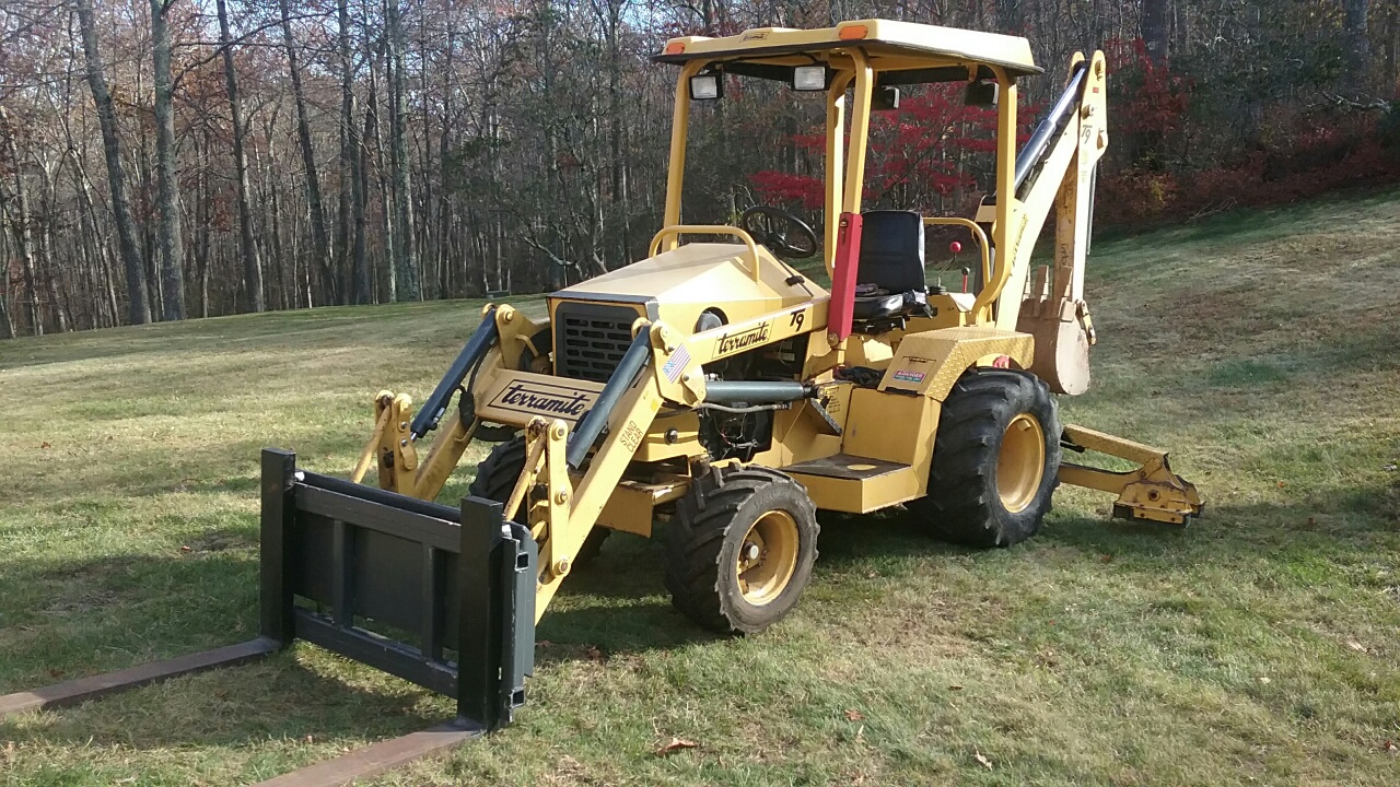

I made the switch and installed a quick attach made ATI that I had purchased a year ago. It had to be custom fit because they don't make one ready to mount. I think its been worth the effort.
20161022_154426_resized.jpg 20161104_125835_resized.jpg 20161110_134739_resized.jpg 20161110_134803_resized.jpg
