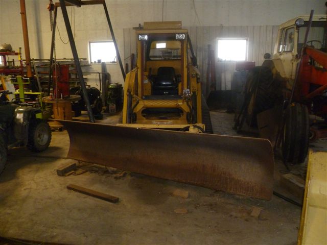

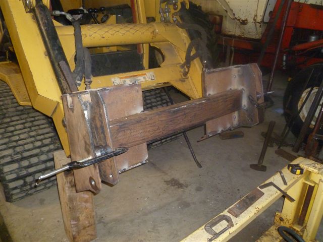

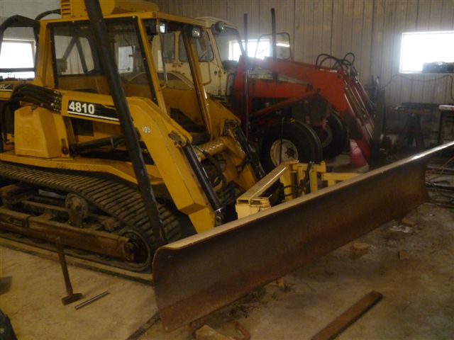

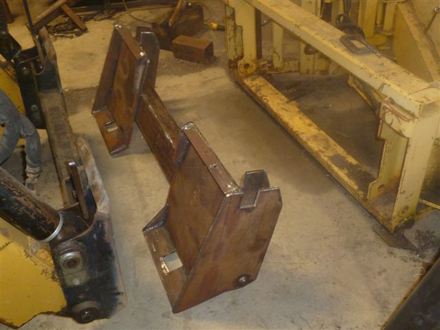

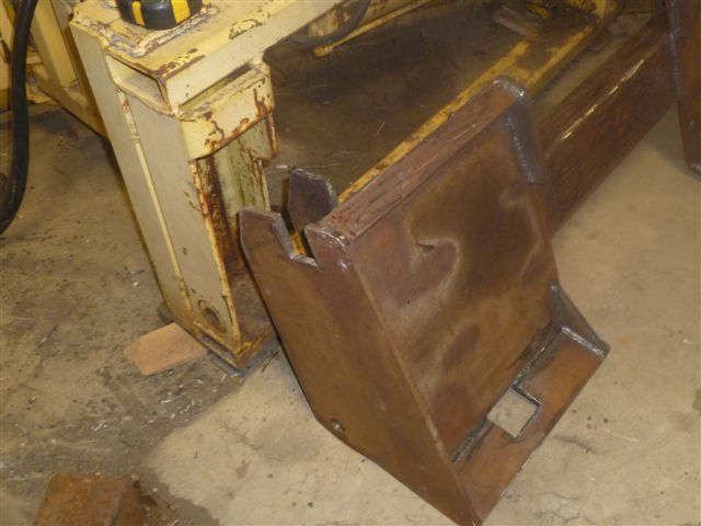

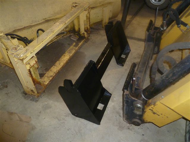

I build this 10' snow blade a number of years ago for use on my Waldon compact articulated loader.
I build my own style quick attach on the loader for it as well but since i got myself also a track steer with universal quick attach i made this in between adapter so i can use the blade on both machines.
The Adapter is made from 3/8" plate.
The blade is hydr angle and can be turned top down to scrape snow and stuff away from doors and walls
