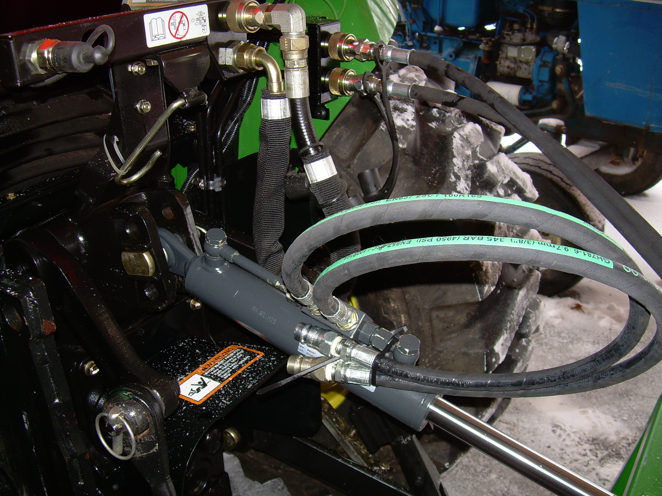

/ Quick Connect Fitting Help #5
The way I did it was get the male plug from the dealer you got the female couplers from then get your hose to match that, anywhere that makes hose will be able to connect that male plug with their hose, using one of their many types of fittings that they stock.
Seems like your trying to find a male QC to match a specific hose end, the hose is the easy part, start with the matching male plug.
Good luck, JB.

/ Quick Connect Fitting Help #7
JB, nice thread. I think I did read that one a while back. And nice HTL set up. I did get to my local dealer and it took them a while but they found the right male quick connect fittings so I picked up four of those even though I'm just adding the HTL for now. Not sure what I'll use the second set of remotes for at this point, but I'll have the correct fittings when/if the time comes.

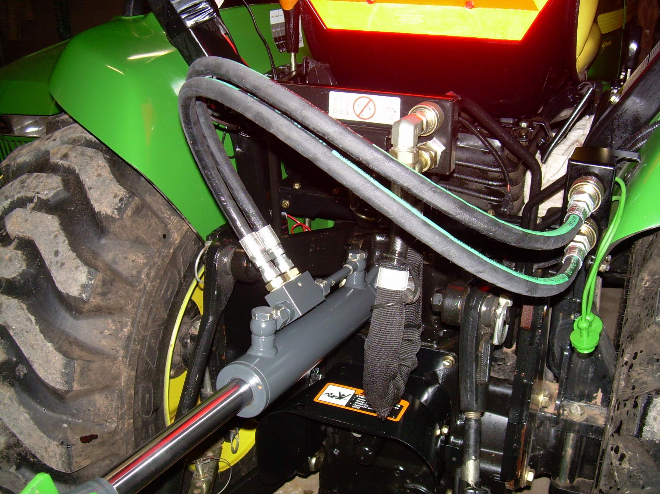

I bought a swivel eye cylinder from Surplus Center for my B7100:
https://www.surpluscenter.com/item.asp?UID=2009040617542246&item=9-7258-10
It works fine, but I can't tilt with it. There isn't enough length between the swivel eye hole and the body of the cylinder. I had to put the rod end up at the tractor, and the body end in the implement, all of mine have enough clearance that the body of the cylinder goes partially between the mounts on all my implements, and provides no room for it to angle when tiling the implement. This is OK is you are not going to use tilt at all. This is how mine is currently configured. I have the top and tilt cylinders on order with CCM now and will probably sell this cylinder. BTW, I got the 10" X 1.5". It is 17 1/4" retracted, and 27 1/4" extended. The outside diameter of the body is 2". Make sure that all your implements have at least that much room at the top pin mounting location, or this cylinder will not work for you.
As for your hydraulic question, if you have a 3/8 quick coupler on your remotes, you'll need this size for your hose. Just buy a 3/8 X 1/4 bushing to mount it on your hose.
I use the following couplers:
https://www.surpluscenter.com/item.asp?UID=2009040617450375&item=9-7381&catname=hydraulic
Use the following bushing to put the male coupler on your 1/4" hose:
https://www.surpluscenter.com/item.asp?UID=2009040617450375&item=9-5406-6-4&catname=hydraulic
If you use the swivel-eye 1.5" dia cylinder from surplus center, you'll need one the following fittings to connect to the cylinder:
https://www.surpluscenter.com/item.asp?UID=2009040617450375&item=9-6900-6-4&catname=hydraulic
https://www.surpluscenter.com/item.asp?UID=2009040617450375&item=9-6901-6-4&catname=hydraulic
Good luck with your project.
Regards,
Jay

CHDinCT -- here is what I was talking about with regard to clearances with the swivel eye cylinders from Surplus Center:
As you can see, the body of the cylinder is too close to the eye. I have the rod end mounted to the tractor, because the tractor mounting point is too narrow for the body of the cylinder. You can see on both my trailer-mover, and carry-all, that the body of the cylinder is between the metal of the implements. I can not tilt any implements (side to side) because of this.
If you don't need to tilt, then you'll be OK. As you can see, I am using it with my carry-all to use it to move pallets of firewood.

Jay, your pic's did not post. You do have me somewhat concerned, but from your earlier post, it looks like you bought a larger cylinder with larger swivel eyes so I'm hoping I don't have the same issue. My main use will be for changing the front to back angle of my rake and back blade. I don't do a lot of side to side tilting, other than to keep the implement horizontal to the ground when lowered. If you could repost the pic's, I'd appreciate it. My cylinder has shipped so the die is cast for now, but I'll check all clearances before putting oil in it just in case I need to send it back.
I do wonder why SC doesn't offer swivel eye cylinders with a little more space between the swivel and the cylinder body on the fixed side. They're all welded right to the body which is not ideal for a TNT set up.

Chris,
I can see his pics just fine.
He's showing how he had to reverse the cylinder cause the eye is to close to the cylinder, mine is extended a little, but I guess just enough.
JB.
/ Quick Connect Fitting Help #17
From what I see, you have enough room if you add some spacers or washers to center of the swivel eye. You could also re-drill the hole, or make an adapter to the implement and or tractor.
If your implement is your main concern, cut off the tabs on top and weld some more tabs on the outside of existing frame. On the tractor side, cut some 3/8 plate and drill out 2 sets of holes, and bolt the tabs on the outside of the tractor tabs, and then install your cylinder in the correct position.
/ Quick Connect Fitting Help #18
The picture with the carry-all (yellow) shows how close the cylinder body it on each side to the top-link attachment point. If I tilt the implement, I can't tilt very far at all until the cylinder body binds against the attachment point.
BTW, the cylinder is a 1.5" dia. cylinder as you have ordered, just longer.
J.
#19
Well I see your pic's now. Not sure what happened earlier today. I just looked at my rake and back blade and the top link mounting points don't have the long tabs that your carry-all has, but if I can get the fixed side of the cylinder to mount to the tractor top link bracket, the implement side won't be an issue. If I measured right, the cylinder itself should clear the mounting tabs on the tractor, but we'll see soon enough.
I'm starting to think of some way I can extend the fixed side swivel eye so it's further away from the cylinder - maybe a heavy duty u-bolt would move the swivel eye out some or a smaller pin would allow the swivel eye to be pulled further away from the center point of the mounting holes.
/ Quick Connect Fitting Help #20
Chris just do what J.J. is suggesting here. That's if you have to.
Come to think of it that might be a good idea for me to get some more rearward tilt out of my HTL, have plenty of forward motion but could use a little more back angle.
JB.
