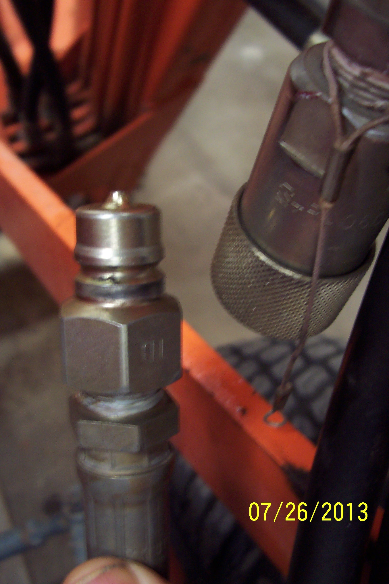

Needing some help identifying this QD male tip. I'm needing a matching set (coupler and tip) so can tap into the FEL power beyond line for power to rear remotes.
The thread in the tip is a 3/8"-14 NPT if that helps with the ID.
Edit: The diameter of the tip is 0.680".

I think it's an A series NOT a B series. Measure from the edge of the tip (not the poppet) to the first ring. A series is 3/8". B series is 1/2"

Thanks guys!!! I can see now that it is definitely the A series. That will get me going.
