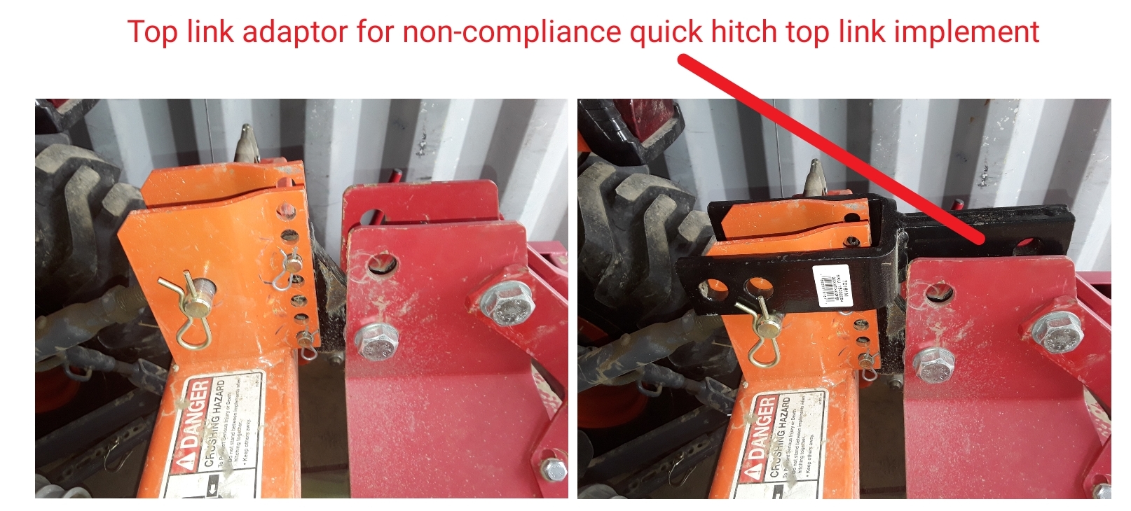

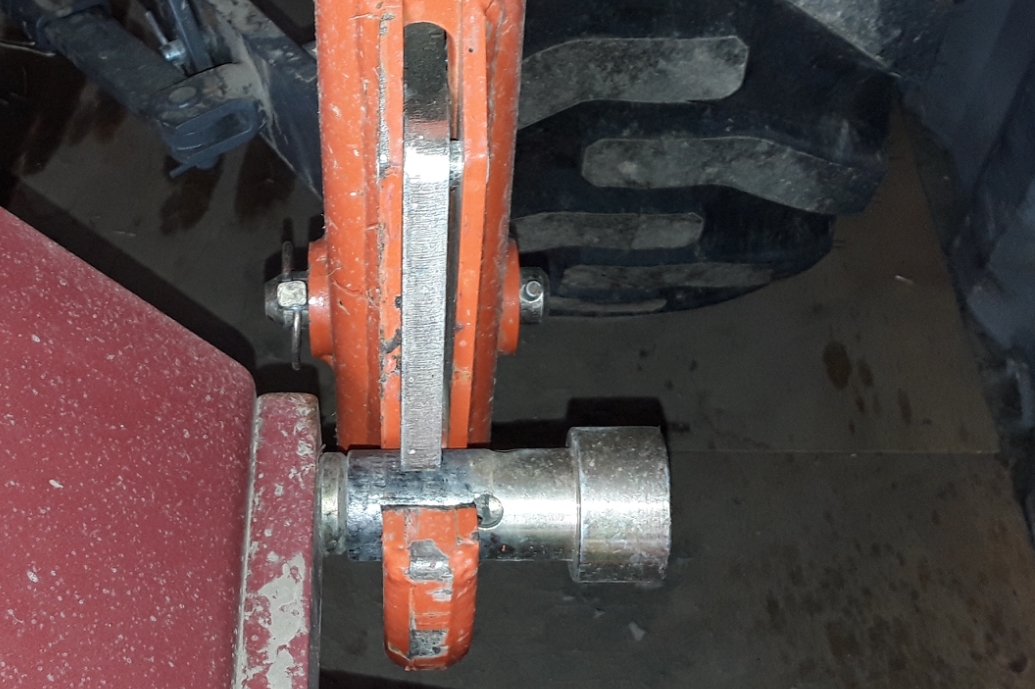

Standard tractor cat 1 Quick Hitches need all cat 1 implement top link and lower pins to be adapted to cat 3 size. Bushing adaptors are easily available. There are some non-standard QHs that use cat 1 lower pin and top link sizes for the implements. These non-standard QHs must still comply to the 3 pt dimensions listed below. Your tractor can lift 3,800 pounds and a HD hitch will be needed. Top link adaptors are available for non-compliance tops but the bottom pin spacing must be correct. Attached are dimensions.
Many of the off brand QHs are the same Chinese hitch with different labels. It will be difficult to find a HD cat 1 QH rated at your tractors 3,800 pounds 3 pt lift but if the HP rating matches probably a non-issue.
