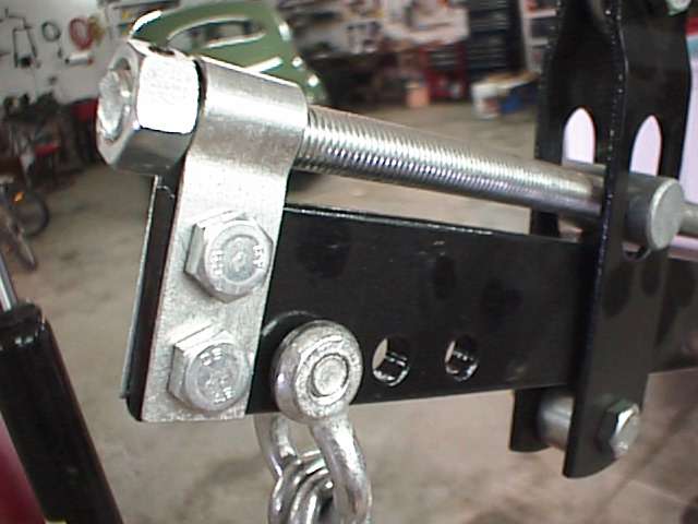

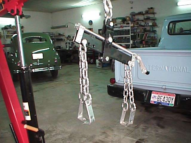

Bubba, any chance of a pic of your setup, would be helpful, thanks very much
   / Quick few questions for those with hoists, please. #13
Hi Mith,
Here's a shot of the overall unit. Keep in mind this is a cheap Chinese leveler made under the Lorcin name.

   / Quick few questions for those with hoists, please. #14
This is a closeup of the transfer bar, and screw drive. The extra holes in the transfer bar let you re-distribute the center of gravity for an out-of-balance load.

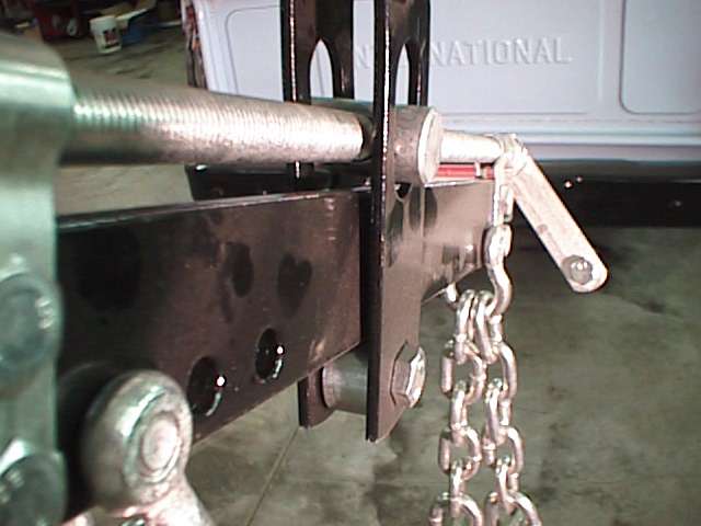

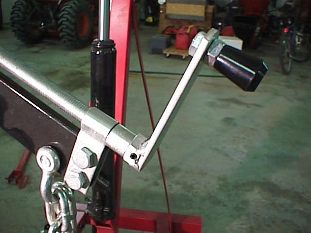

   / Quick few questions for those with hoists, please. #15
Here's a shot of the crank end of the transfer bar.

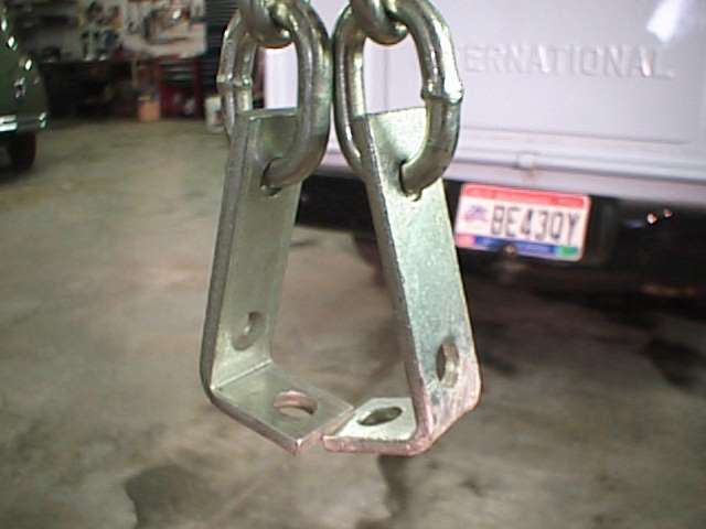

   / Quick few questions for those with hoists, please. #17
Here's a shot of the "L" brackets to attach your load to the leveler.
Hope that helps you out, if you have any other questions, I would be glad to try to answer them for you. /forums/images/graemlins/smile.gif
PS. Most chain that you buy is labled "Not for use with an overhead crane", or something similar. I don't know whether this is a liability issue or if in fact gravity is more efficient when an object is suspended from above. But anyway I would use grade 70 or better chain just for piece if mind. Plus you don't need that much chain, so it won't be too costly.
Have Fun /forums/images/graemlins/grin.gif

Wow man, thanks so much, very VERY helpful. So useful to see how all the bits happen.
Just one question, would you change the design atall to improve it, more length?, more adjustment?, more capacity?

As someone else mentioned, it would be nice to have bearings on the ends of the screw drive to decrease the friction when you crank it. I don't think you will have an issue with it creeping as there is plenty of friction to keep the drive screw in place.
We have an old adage over here that we call Moore's Law. It goes "If some is good, more's better". Depending on your intended useage you may want to increase the capacities of the various components, but there is no point in making the leveler a higher capacity than your hoist, or you may destroy the hoist. This one has enough adjustments to suit my needs, but your mileage may vary.
