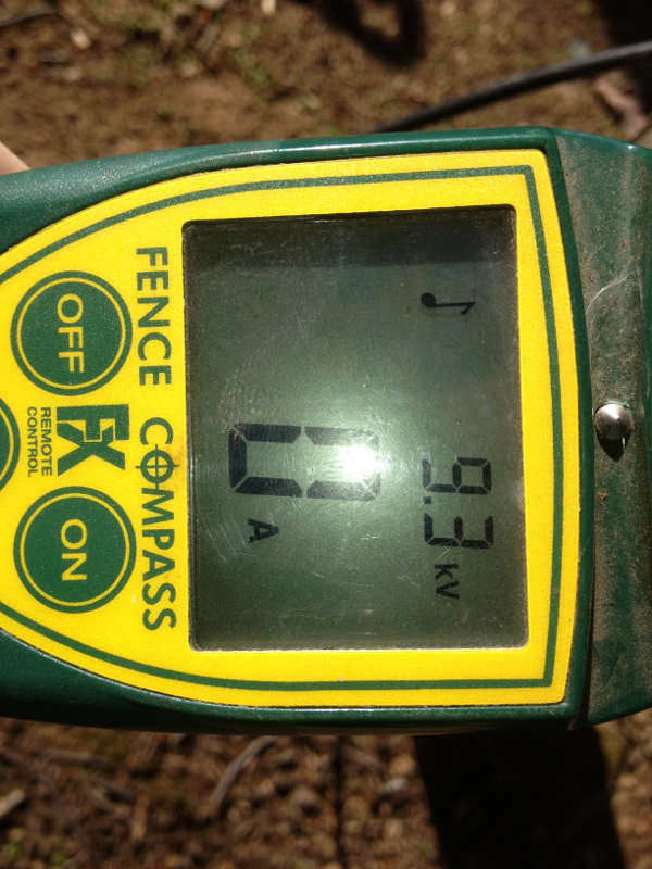

My new charger came with a fault finder / remote control. I can turn the power off from anywhere along the line by touching the remote to the wire and holding down the button. It is pretty cool and very handy!
Is it a Speedrite? I ask because, as far as I know, they're the only ones who have that remote on/off function. I would really love to find someone who made an external box that you plugged the energizer into that would add remote on/off to the fence after the fact. As much as I would like that feature, I can't justify buying a whole new Speedrite energizer just to get it.

If you use an electric fence charger, you need a Smartfix fence tester, by Gallagher. Saves sooooooooooooo much time figuring out where a fence problem is and where to look for the problem. Yes, costs $ but saves soooooooooooooooo much time it's worth it.
It tells you
Voltage on fence
Amps being delivered by fence
Direction of flow of amps.
Using it, you don't have to cut the fence off .... it leads you directly to the short/broken wire....then you can turn fence off (if needed) once and fix it.
Wish I had discovered it years sooner....cuts hours off of my fence fix time...There are some other brands, but be sure to get one that shows voltage, amps, and direction of flow.....those 5 light testers I used for years are stone age compared to the Smartfix.
Just FYI....nobody asked....but you need to know.

Thats the way my old one worked, you are right it is a time saver.
The new one does all that plus cuts the power on/off from anywhere on the fence.

Yes, yes, yes a thousand times yes. If your fence tester does not tell you amps and direction of current flow, you are missing out. It costs maybe $120, but it will more than make it up with the number of hours you don't have to spend walking the fence looking and looking for where the short is. I wrote a blog post some time ago about the difference between different kinds of fence testers. Here's a link:
Electric Fence Testing Meters | Jack-Booted Liberal
The short version is that, with a "fault-finder" tester that shows amp direction, you can simply "follow the arrow" to the location of the short. Just keep walking until the current flow changes direction, and then you know you passed the short. Otherwise, it's just trial and error. I honestly do not know how people maintained electric fences without these.
