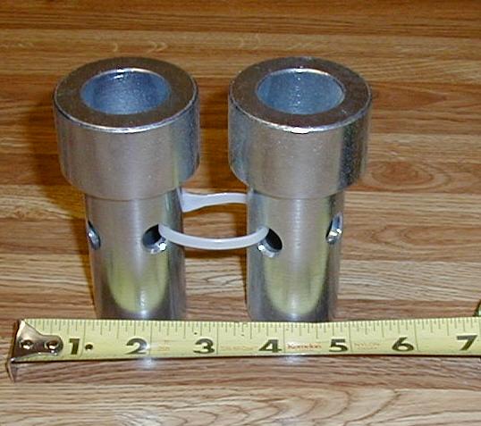

On my iMatch, the bushings (two lower ones) change the size from Cat I to Cat III. That makes the fit right for the lower hooks on the iMatch. The hooks are 1½" diam.
I don't see the real need for the oversize ends on the bushing kit. But I bought the Cat I to Cat III from SpeeCo (#HF 141144) for $12.99. Took me a long time to convince the Farm Fleet store to stock the right bushings for the SpeeCo quick hitch that they sold. But it finally happened.

I wonder if we're talking about the same thing here Mike (?) I pay less than $1 each for generic implement lift pin and toplink pin bushings; under $3 total at NAPA/TSC/RuralKing/et cetera. Are you perhaps referring to the hardware set needed to actually connect the QuickHitch itself to the tractor's lower lift arms?
//greg//
   / Quick hitch and Adapter bushings #13
I think the discussion is the bushing set, as attached. I agree that just straight bushings will work, as I have used them as well. The set comes with a roll pin to hold them in place.
