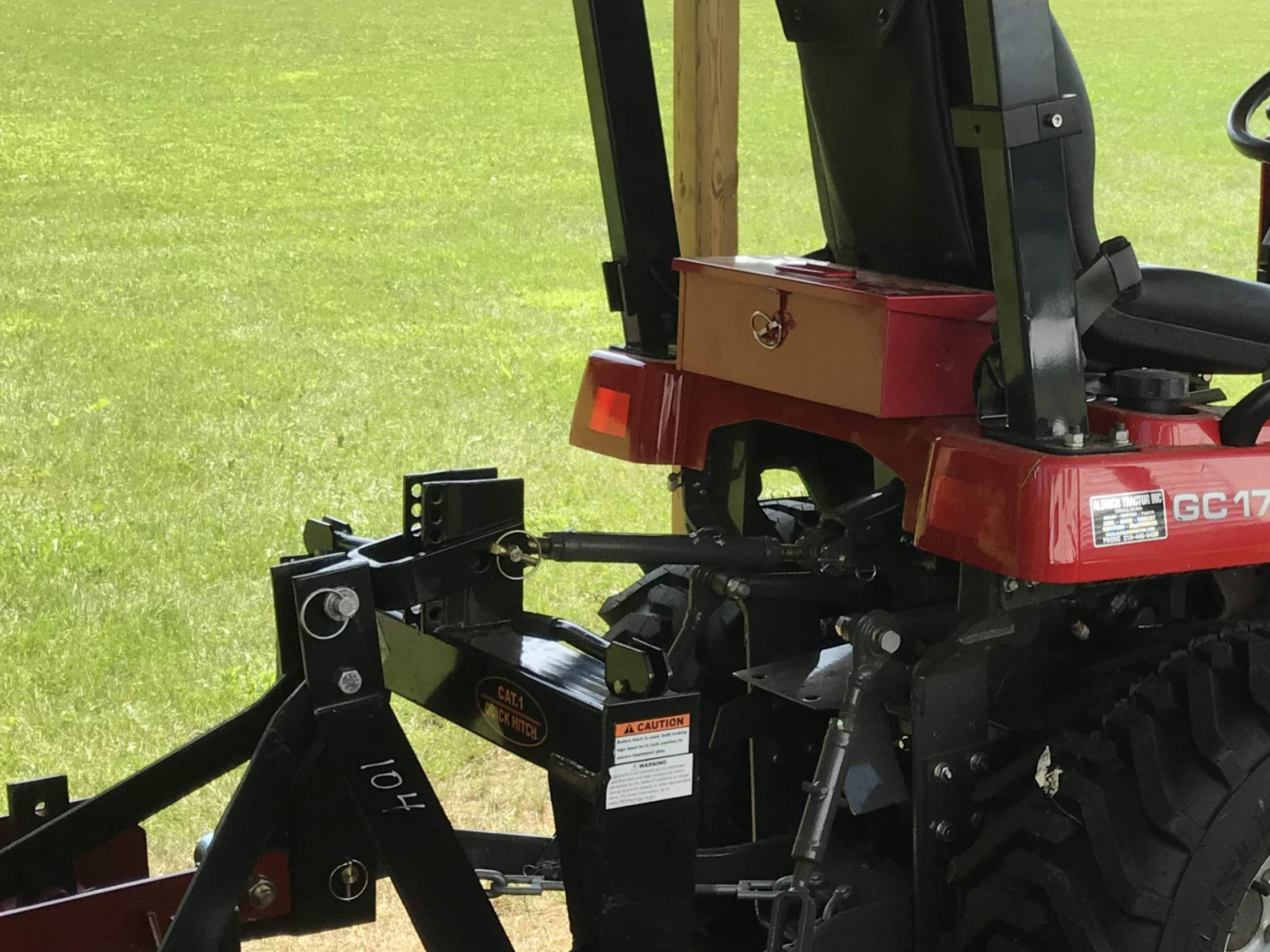

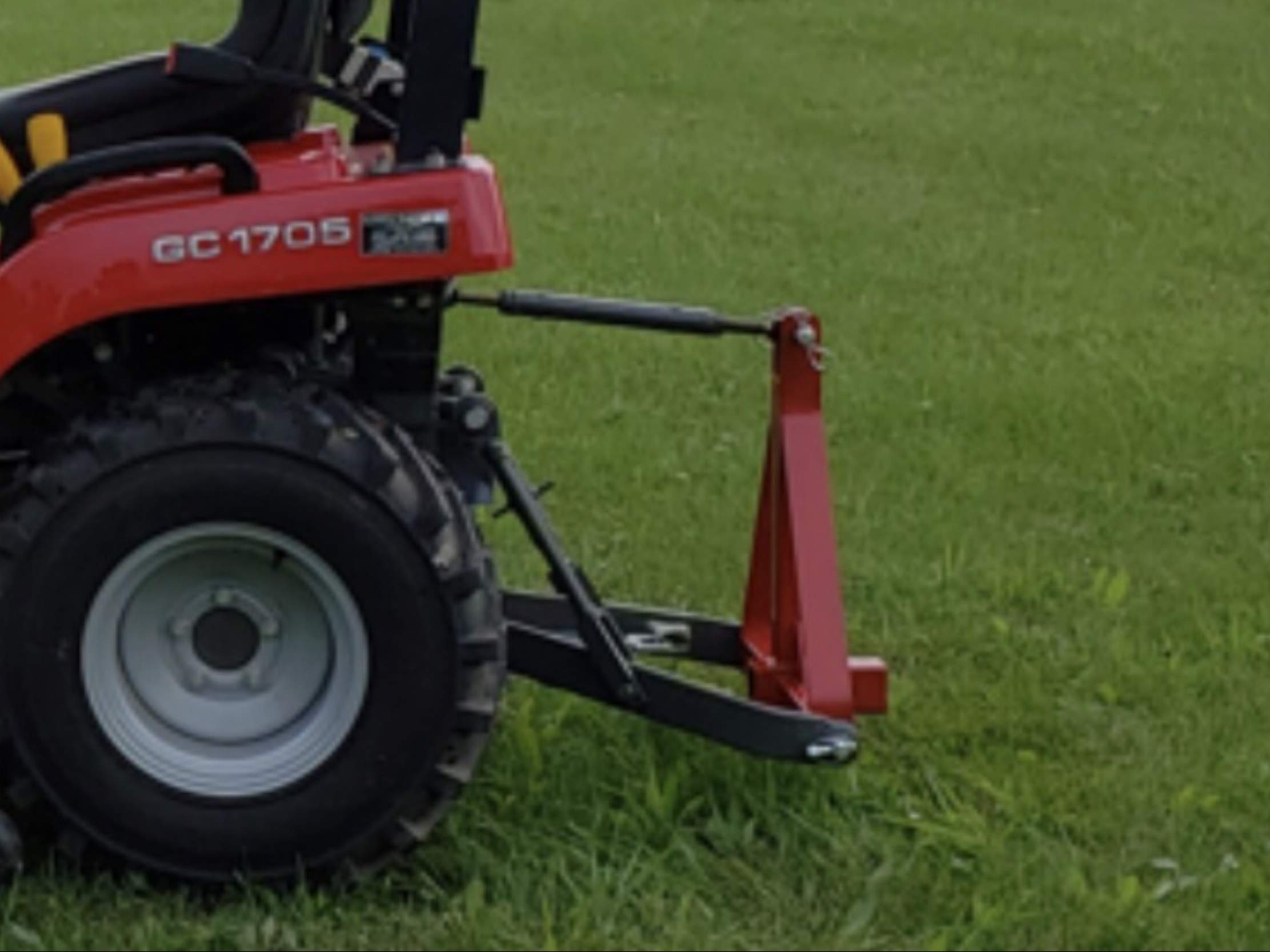

What I like about the QH is that once you get it put on and the 2 turnbuckles tightened up the QH is pretty solid and does not shift a lot side to side, I also got all three of my implements adjusted to fit with the lower pin bushings but I needed to use a extension on top instead of the hook for my 2 Walco implements so I left the hook off.
I tried to just use the lower arms without a QH but I had to redo the turnbuckles when I switch implements being one was wider then the other and it took time to tighten them up so the implement did not move side to side to much, with the QH i do not have to worry about this because the lower pin bushings made up the difference.
This is the one I had to modify because the lower pins were to close together, works fine with the QH now.
Jim.

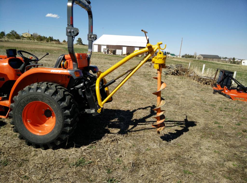

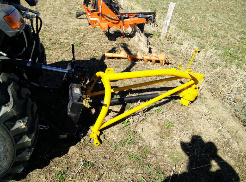

The PHD (Post Hole Digger) is one implement you will not be able to use with your Quick Hitch. You will need to remove it, so then the extendable lower links might be pretty handy. Post Hole Diggers are reputably a PITA to hook up anyway, unless parked just so to make re-hitching easy. Even then some complain about them. If you don't have or don't contemplate getting one, then the Extendable lower links or even the telescoping stabilizers don't have much purpose. I use them all the time, but then I don't have a quick hitch and nothing I have is QH compatible anyway. I also don't have TNT, though I have contemplated getting that several times. But I guess if I have lived without it this long..:) Fixed lower links and turnbuckles are in themselves a big PITA but that all goes away with the QH.
   / Quick hitch and extendable links? #17
I rebuilt my 3pt PHD to work on a QH. You need a hydraulic toplink for that though. I liked mine, but sold it with the old tractor. Replaced it with a hydraulic SSQA PHD on the new machine.
