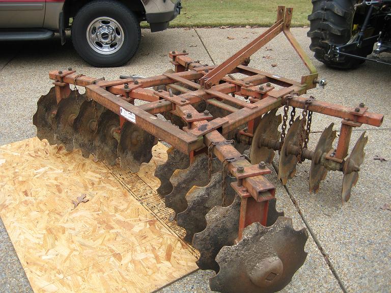

I have the adjustable spacer bar. With the thickness of the hooks there isn't enough tolerance space for a clean hookup each time.

Sometimes that works, but if it is not on perfectly even ground the slack in my sway bars allows the hooks to slip off at times. Many times will trying this method I found myself kicking the lift arms trying to get enough clearance so I could get the washers on and the pins back in the hole.
Here is a pic:
   / Quick hitch category 1 lift pins #18
Don't you use the PEC spacer bar? That's exactly what it's supposed to prevent. You paid for it, why not use it? Properly adjusted side links help too. Between the PEC spacer bar and my side links, I never had that problem.
//greg//
That is my problem. The space between the washer and the shoulder of the lift pin is so narrow that the bar has to be perfectly spaced so that both hooks attaches to the pins. If it is off slightly, one of the hooks always binds/catches one of the washers on either side. The answer, I believe, would be longer lift pins so the clearance between the washer and the pins shoulder is wider, making the hook-up on both pins easier.
If I had to guess there is probably only a difference of 1/4-1/2 inch between the thickness of the hooks and the space available on the pins once the washers are attached. The washers are not straight once attached by the retaining pin.
