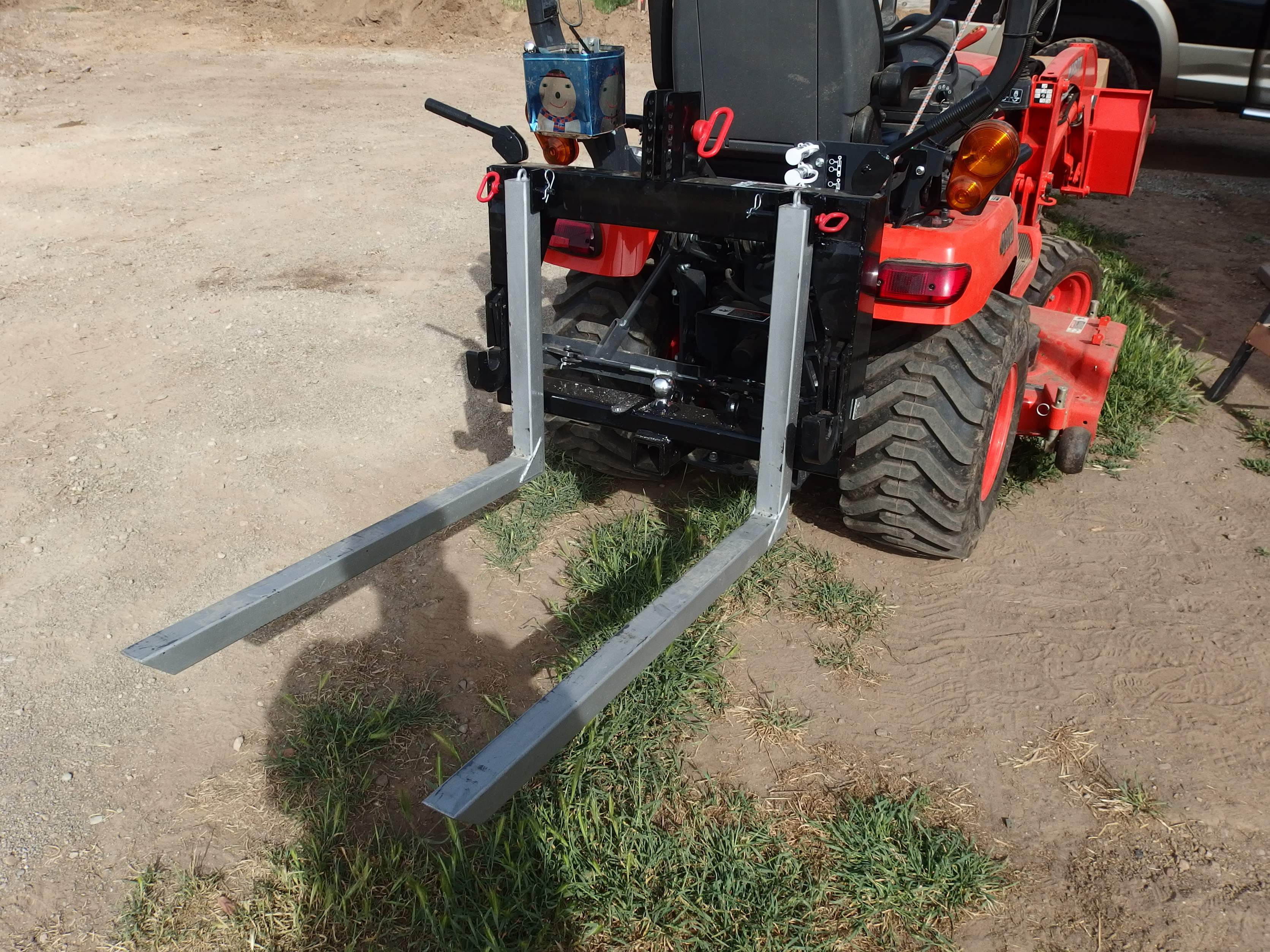

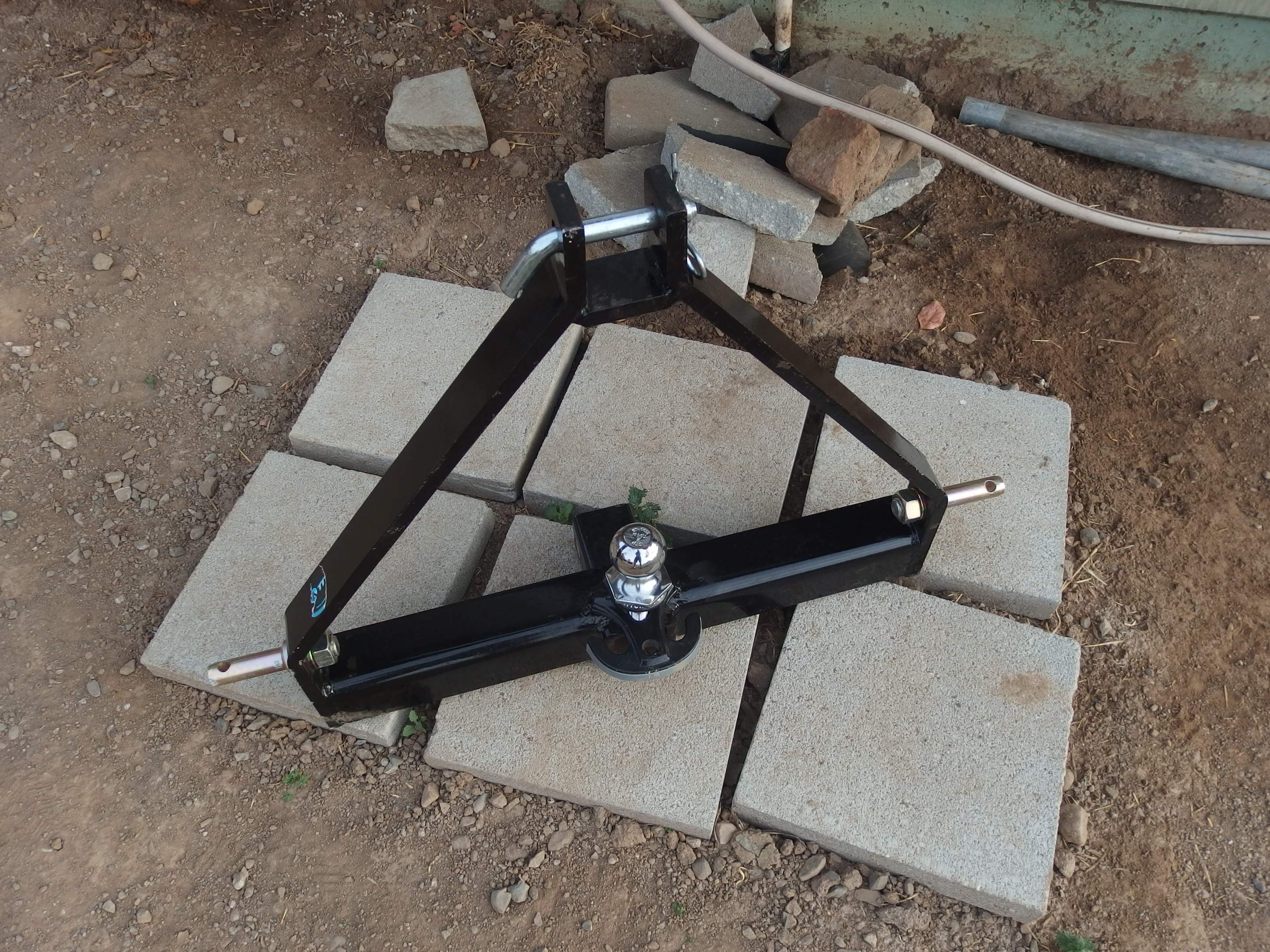

I used to have a Titan 2" square hitch receiver in my 3 point hitch most of the time for moving trailers and such. It's pretty handy and multi-purpose, since I welded on a "Hitchin Post" with a lawn trailer hitch eye, a set of hooks, and a 2" ball receiver (see triangle shape hitch photo). On the 3pt, I also use a Middle Buster and Box Scraper, but when those tools are off, I'd just throw on the Titan hitch receiver, cuz it's like a Swiss army knife.

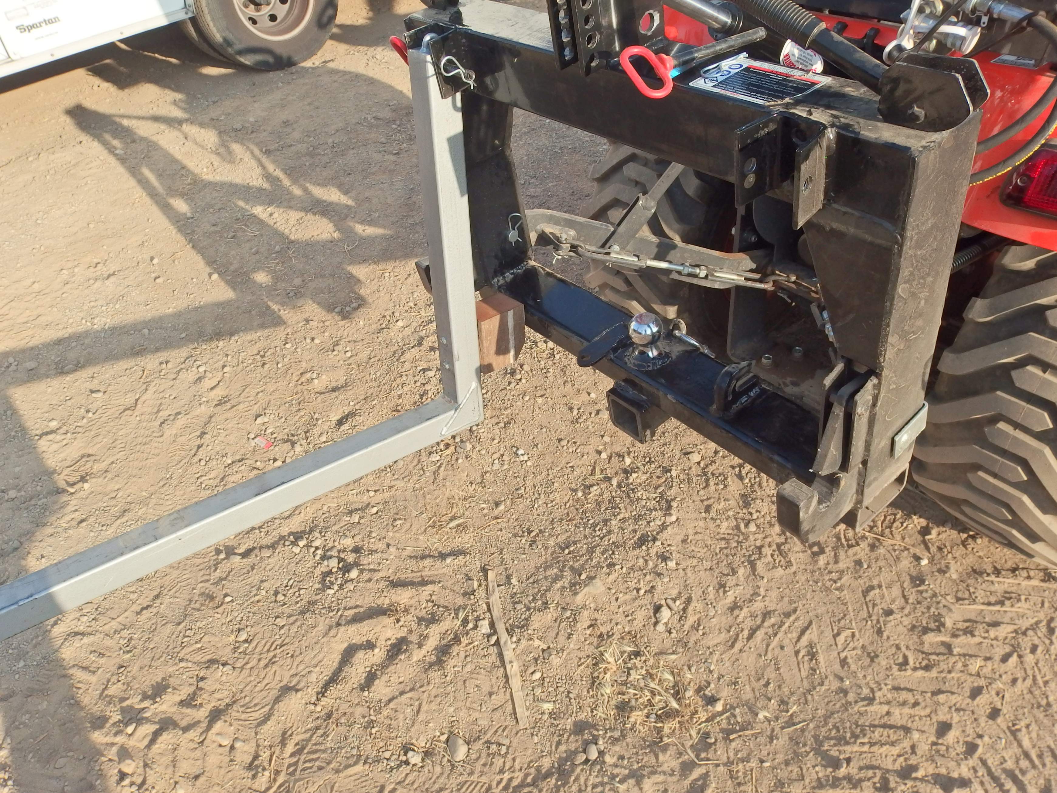

Well, then I bought a Quick Hitch (QH) from Harbor Freight for around $100, and it made hooking up the box scraper a whole lot easier, but it seemed to be a little ridiculous to put the Titan hitch receiver into this existing big hunk of metal. So I decided to customize the QH, adding a lower bar. To the lower bar, I welded a chain hook, a lawn trailer hitch eye, a 2" ball (internal thread, so no bolt), a 2" square receiver, and a chain eye on the forward edge. This chain eye will be used to limit the downward movement of the QH when I'm using the MMM.
Once I was partway done the welding, it occurred to me that this modded QH could also be a great platform for mounting my BXpanded FEL forks. So I found and welded on a pair of brackets to the QH top bar, and the forks mount easily there, and brace against the lower bar.
This setup is AWESOME. Now I always have a hitch ball for moving trailers, I have a nice low tow point for a chain, which I can also lift with the 3pt hydraulics, I have the 2" receiver so I can put in any truck attachment like cargo carrier, etc. I can easily hook up my small utility trailers for yard work, and I can still hook up the serious attachments using the standard QH features. No part seems to get in the way of using the other parts.

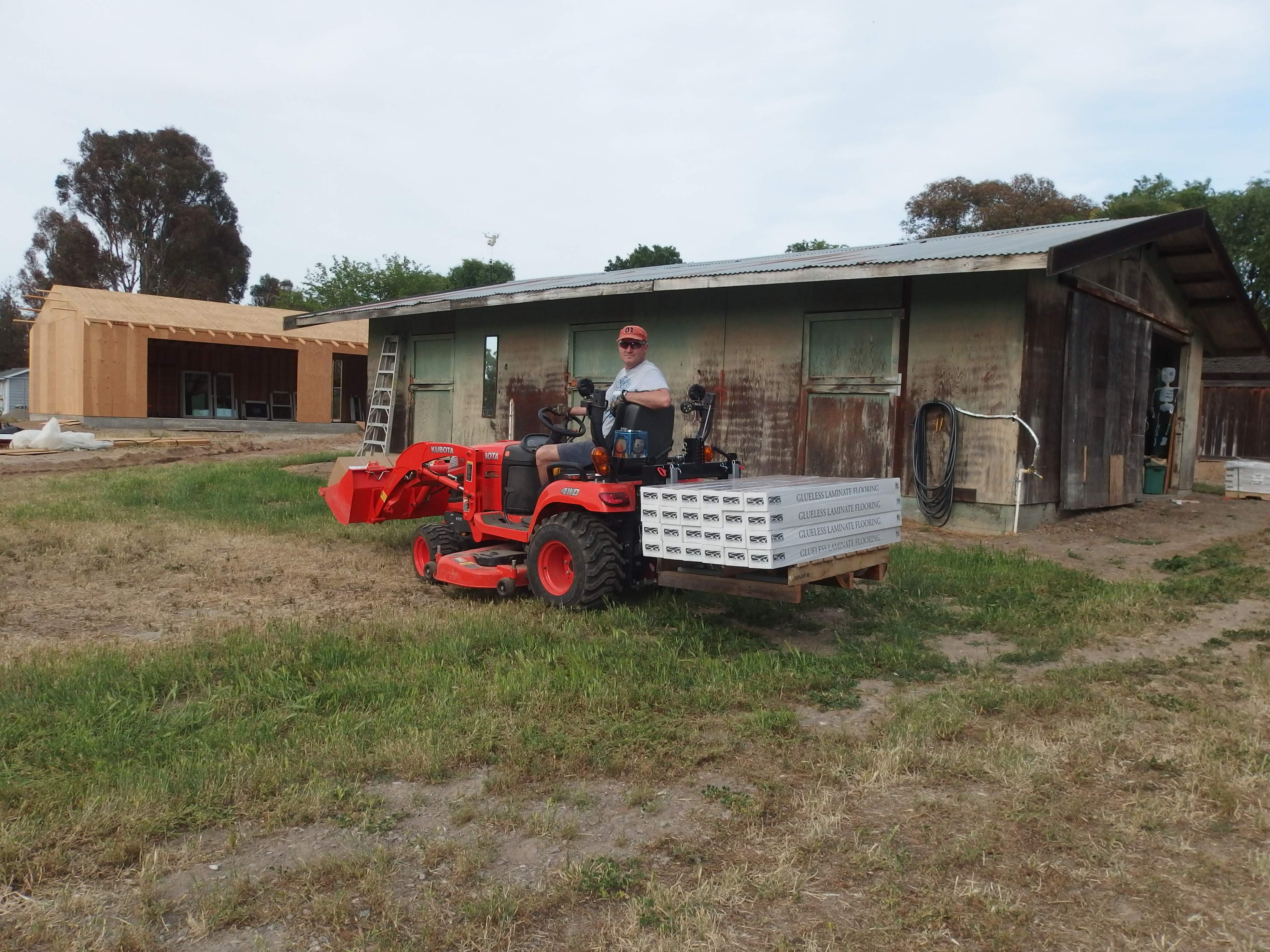

The forks are much better on the back. On the front, I can see how they are useful for brush cleanup and a variety of mixed tasks...but they're pretty bad up there for pallets. The swing of the steering is pretty wide at the tip of the forks, and the weight is too far forward to get much lift force. The FEL blocks the view of the fork tips, and you have to do a tilt/lift balancing act to lift the pallet straight. However, on the 3pt, it is closer to the tires, lifts more, maneuvers better, lifts straight up, and is easier to see, plus it drives more like a forklift, with the steering wheels opposite the forks. In the photo, I'm lifting 850lbs of flooring.
It's a great setup, and I highly recommend it. Get out your welders!

Will the new bar get in the way of the PTO shaft for PTO powered attachments?
Otherwise, it looks great.
Well, I don't use any PTO equipment yet, and my mower is MMM. But I did consider that issue for the future. I'm considering a PTO generator. And so, yeah, I think it might interfere. The hitch ball, in particular was something I thought might cause problems if I use a PTO shaft. But if that gets in the way, I'll grind it off and just use the 2" square receiver for a hitch ball.
I was figuring that if I adjust the height and the tilt of a 3pt genny, I could still get plenty of space for a straight PTO connection. But for an up/down working implement with a PTO, like a tiller or flail mower, it wouldn't work.

OK, that's enough of that nonsense. Now get back to finishing that building!
Ha! I justified buying the SCUT by carving out jobs from my contract with the general contractor. Just putting in my own gravel driveway will pay for the BX2670, if I count my time as worthless -- which I did in this rare case.
I also order materials myself, store them, and move them around with the forks.
I'll do all the landscaping (slow and steady) after the construction is done.

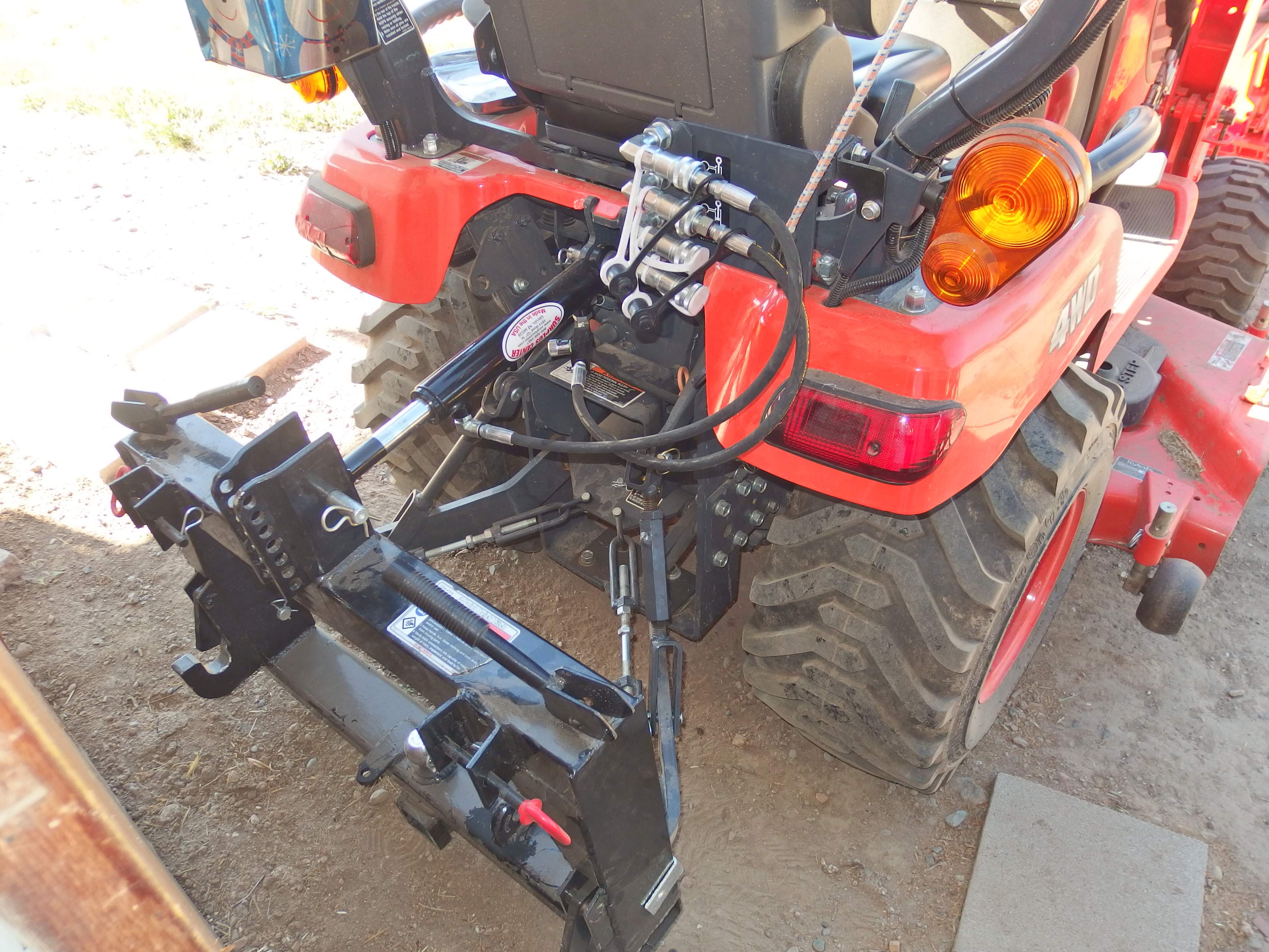

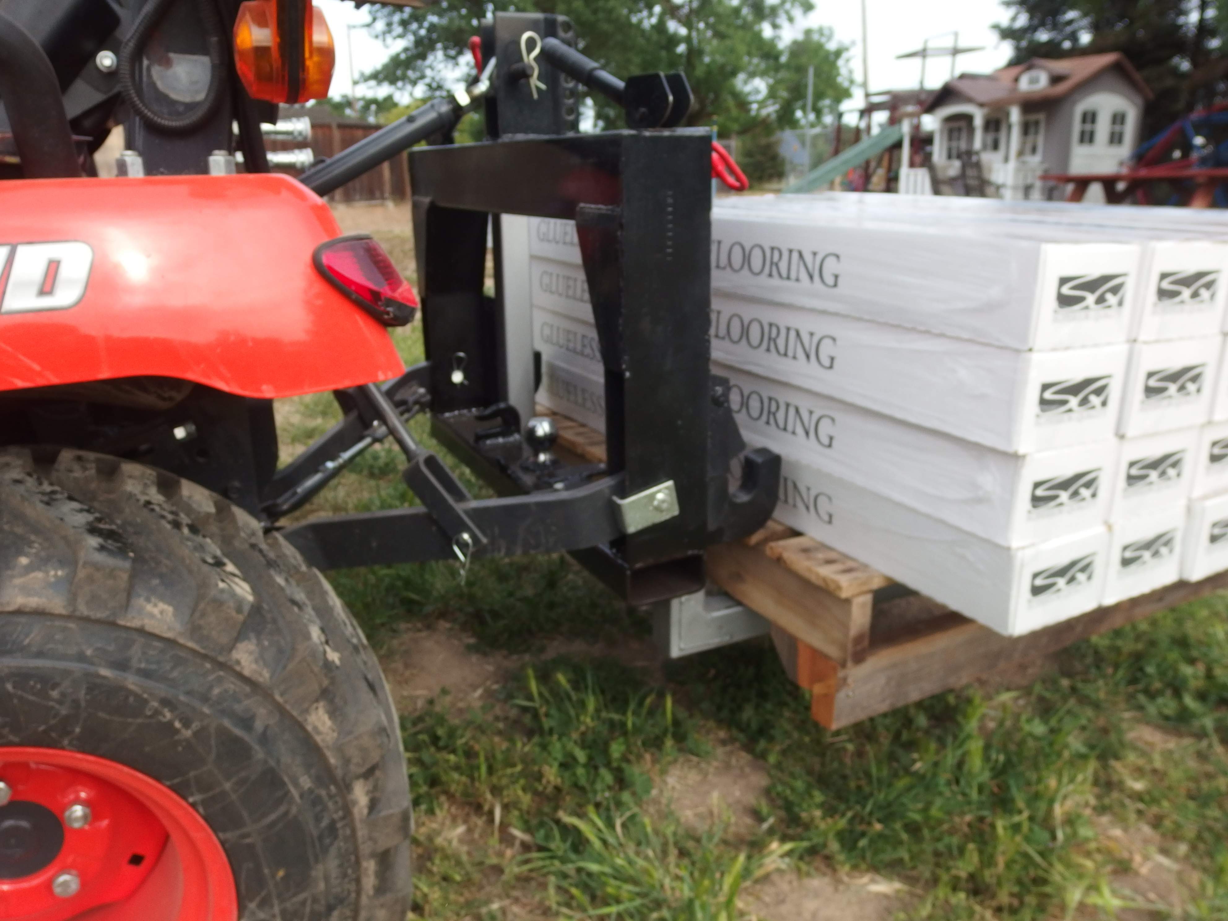

Well, I've improved on the setup I described in this thread.
The forks on the back sat flush with the QH, and that meant the QH lower hooks were sticking into my pallet load. So I added a wood spacer. This provides the right spacing, but also prevents the metal on metal rubbing.

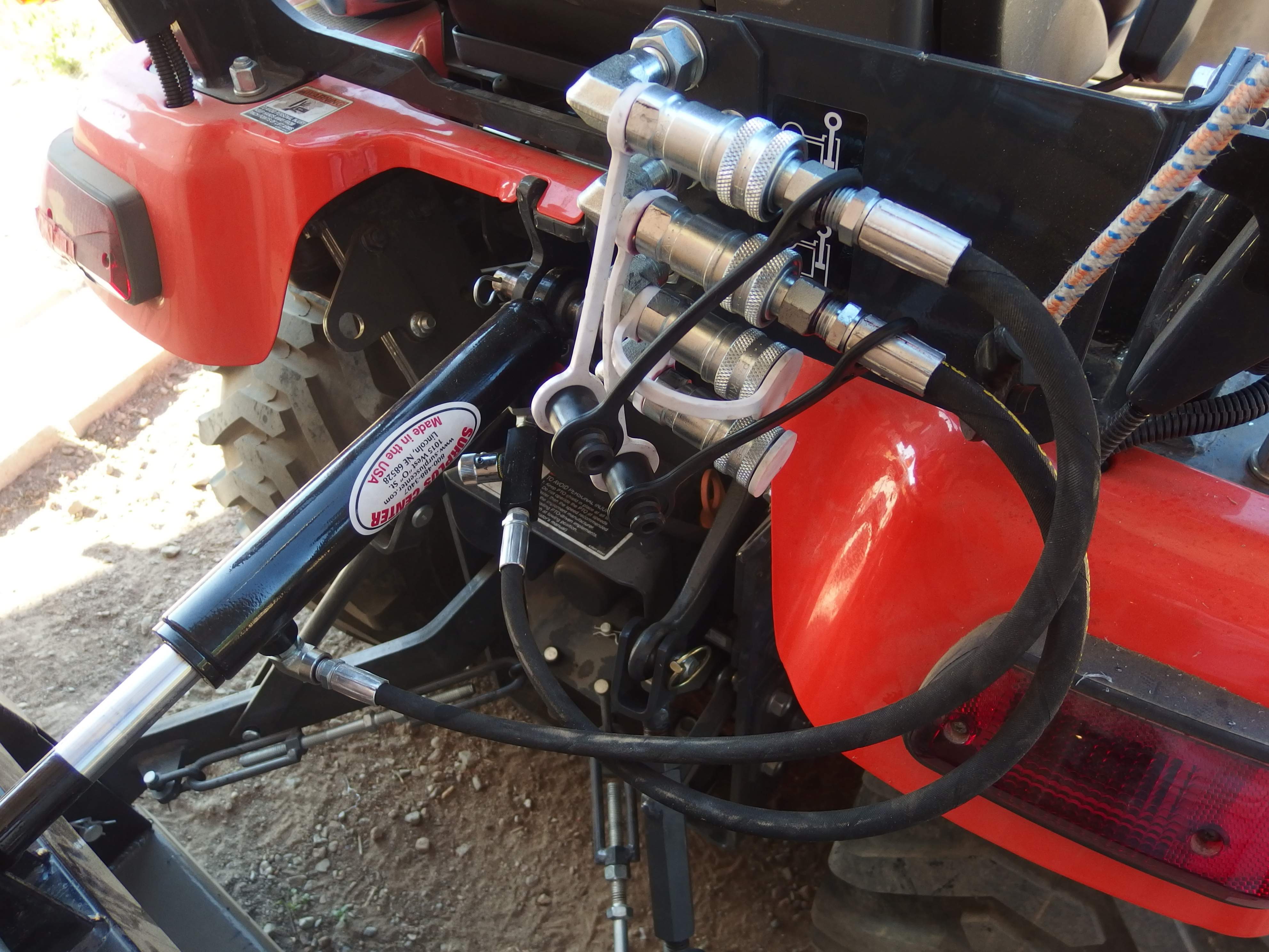

The forklift feature is even better with the Hydraulic Top Link I added, for tilting the implement on the 3PH:
See the install of the Rear Hydraulic Kit and the hydraulic top link on this thread:
http://www.tractorbynet.com/forums/...x7326-rear-aux-kit-install-6.html#post3776207
Lots of good info there by lots of folks who have done this.
Specific hydraulic top link instructions are here:
http://www.tractorbynet.com/forums/...x7326-rear-aux-kit-install-7.html#post3789064
Now, mama didn't raise no fool, so when I put those wood spacers on, it occurred to me I could kill two birds with one stone. I have the BXpanded Piranha bar. This tooth bar limits where you can put the BXpanded forks without the teeth interfering. I wanted to be able to continue to use the forks on the front in any location without removing the tooth bar. So the wood stand-offs also stand off from the bucket lip and avoid the Pirahna.
