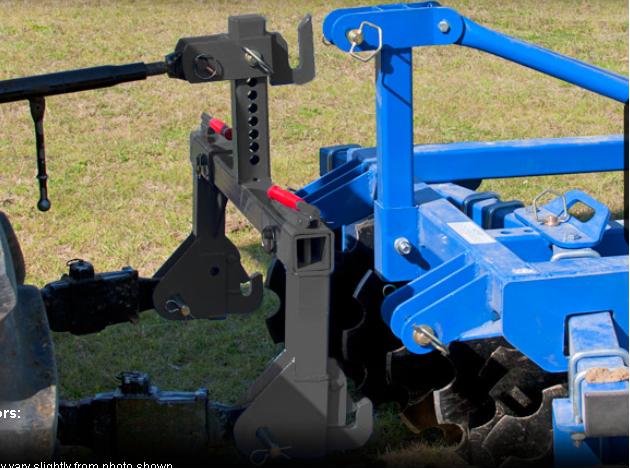

Daugen, I've only seen ONE QH that looks to solve these problems sensibly, and it may have been discontinued - I've not been able to find it on Priefert's site the last couple of times I've looked, luckily I "borrowed" the pic before it disappeared. One of my hundreds of proposed projects is to mod my HF qh's (I have 3) with at least the toplink they used - so far, I've not run into an implement that's too far off width-wise.
Note that top hook height AND draw pin width are adjustable on this one... Steve
impressive photo :thumbsup:
