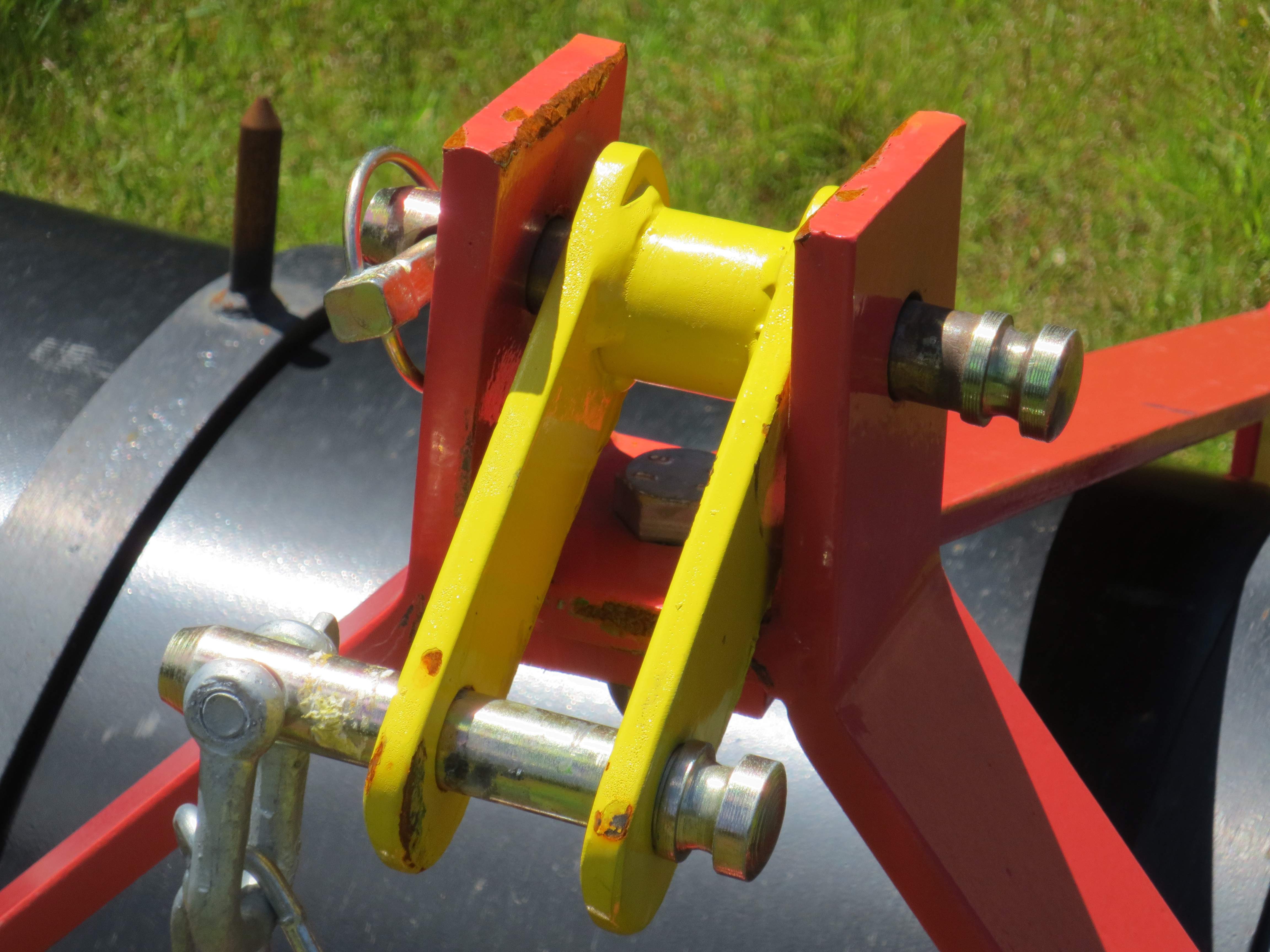

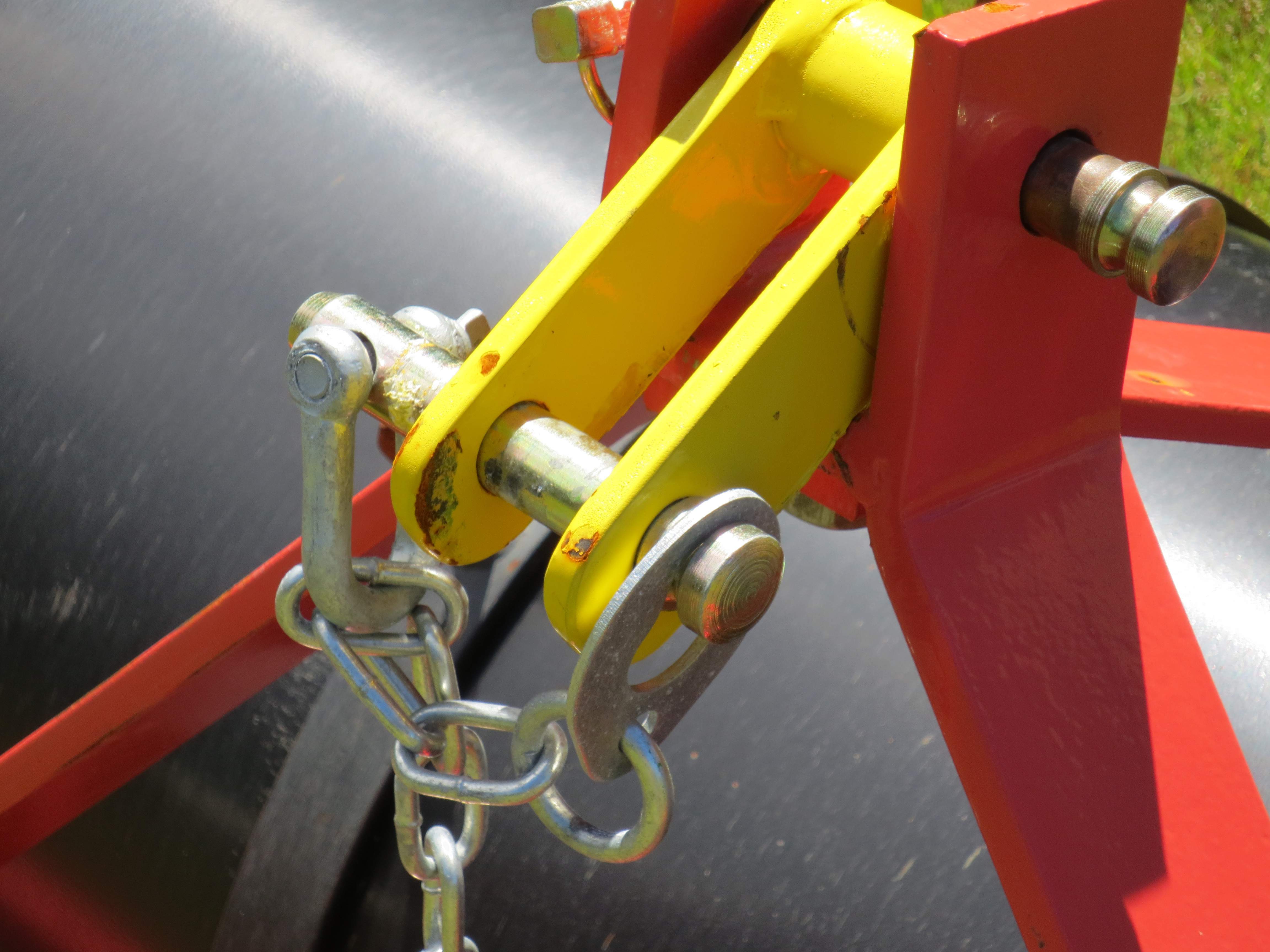

Wagtail...where did you purchase your top hitch adapter? Or did you make it? Also, what is the purpose of the chain showing in the photos? And why is it attached to both ends of the pin inthe first photo? Interesting!
I had a local metal shop knock it up... but as a template, my slasher came with a similar adaptor as it came at the same time as my 4105 with the iMatch.
I mentioned before that the chain that I attached acts as a 'curb chain'. Once the implement is attached to the QH, I run the chain underneath the top hook to ensure that the non-QH compliant implement doesn't pop-out of the hook... ballast roller & the landscape rake are the only two implements where I employ this adaptation. The chain itself is a shackle and a style of 'gate latch chain' that I picked up at the local hardware store in the fencing section.
I got the idea of using a 'cub chain' from a type of horse bit. :)

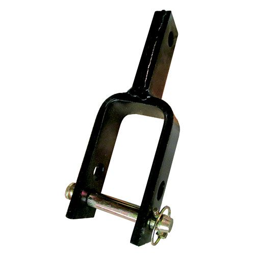

This is an internet photo of the type quick hitch adapter that came with the quick hitch.
This adapter is for quick hitch use on a mower that needs the top link connection to float. You will remove your top hook when using it.

And for an implement with a pin the hook can't reach.
Bruce

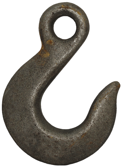

I have a cheap quick hitch and old equipment that isn't quite standard to any standard. The top hook that came with the piece didn't really work well and I tried the top link attachment but still had issues. I ended up taking a steel chain hook and attaching it to the top of the quick hitch with a bolt and then the hook part just flops over onto the implement and I can tighten the hook up if needed with the top link adjuster. Small tractor (Ford 2000) and light equipment and perhaps not as "quick" as a true quick hitch but it keeps me from fighting to make the mower and the tiller fit right.Chain-Slip-Hook.png
