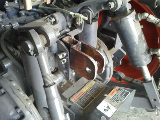

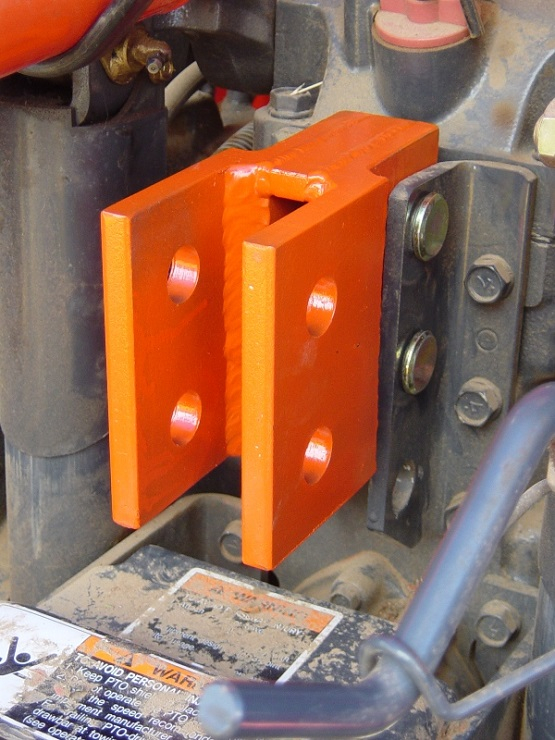

3) Finding an adapter for the ‘tractor end’ of the top link. (a member here fashioned a great one a while back but I lack his skills).
Have one made. Check with local high school shop teacher or a machine shop:
