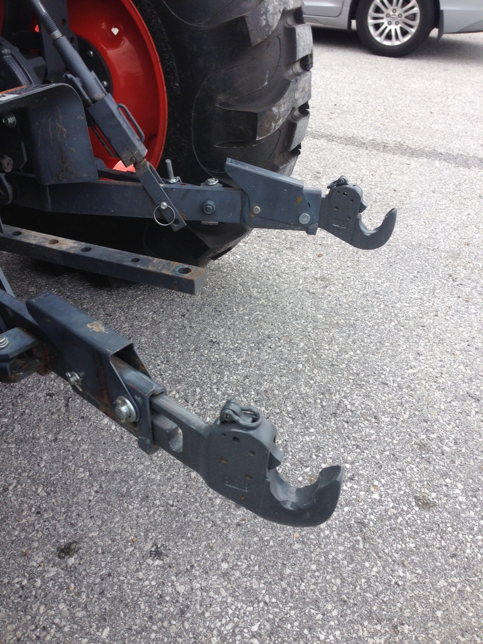

Someone had mentioned looking at getting a quick hitch for my new M7060. I've been researching them and am looking at a Land Pride QH20 as well as Pat's quick hitch system. I'll most likely be using a combination of Cat 1 and Cat II implements which confuses the decision. I'll also be buying some new implements down the road. The main implements I'll be using are a rotary cutter, box grader, occasional auger and reverse tine tiller.
What do you have and what do you recommend?

You will not be able to use a full 3pt quick hitch and be able to connect to both cat 1 & cat 2 implements without modifications to the implements. You are working with a fixed width on the QH and 2 different widths on the implements.
Either Pat's which would be the easiest or the European type (pictured) that are similar to the Pat's, but provide full contact of the hitch pin through out the full range of hitch movement capabilities.

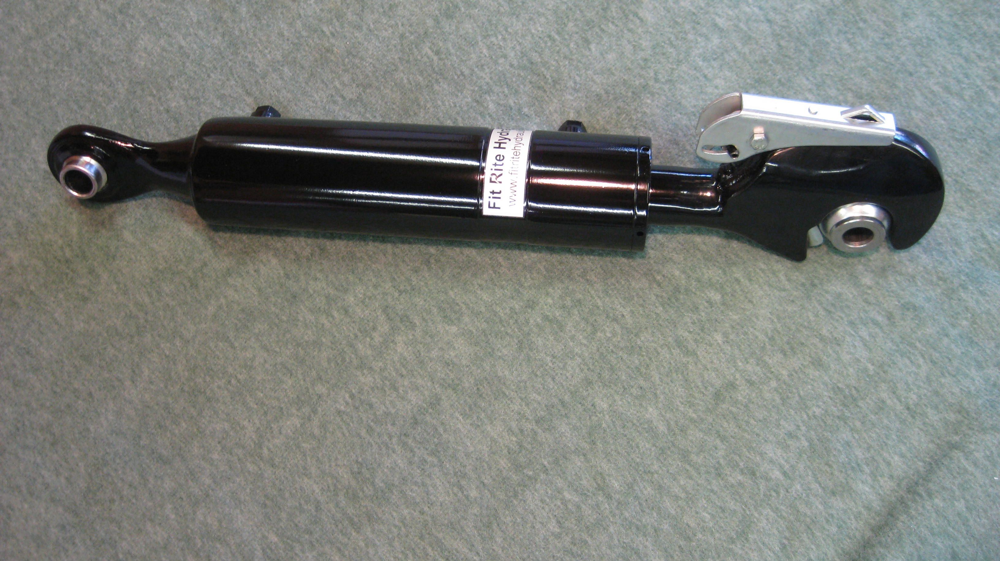

You can get a top link that provides the same type of connection also. :cool:
I have this style on my Branson 8050 and find it very handy, I also have a couple of quick hitches which I do use on my IH574.
I find the hook type much handier especially if I have to connect a pto.

If you have a few $hundred spare for goodies on the M7060 I strongly recommend an hydraulic top link. They are extremely useful for almost every implement and especially for that box grader you plan on. [Get one with plenty of length-flexibility and heavy enough to handle anything you have.] And by the way I have found it very helpful at times in hooking up troublesome implements. Things far too heavy to move by hand (say a 1460lb bush hog) can be moved around a little using the hydraulic top link, often positioning them for ease of hitching.
