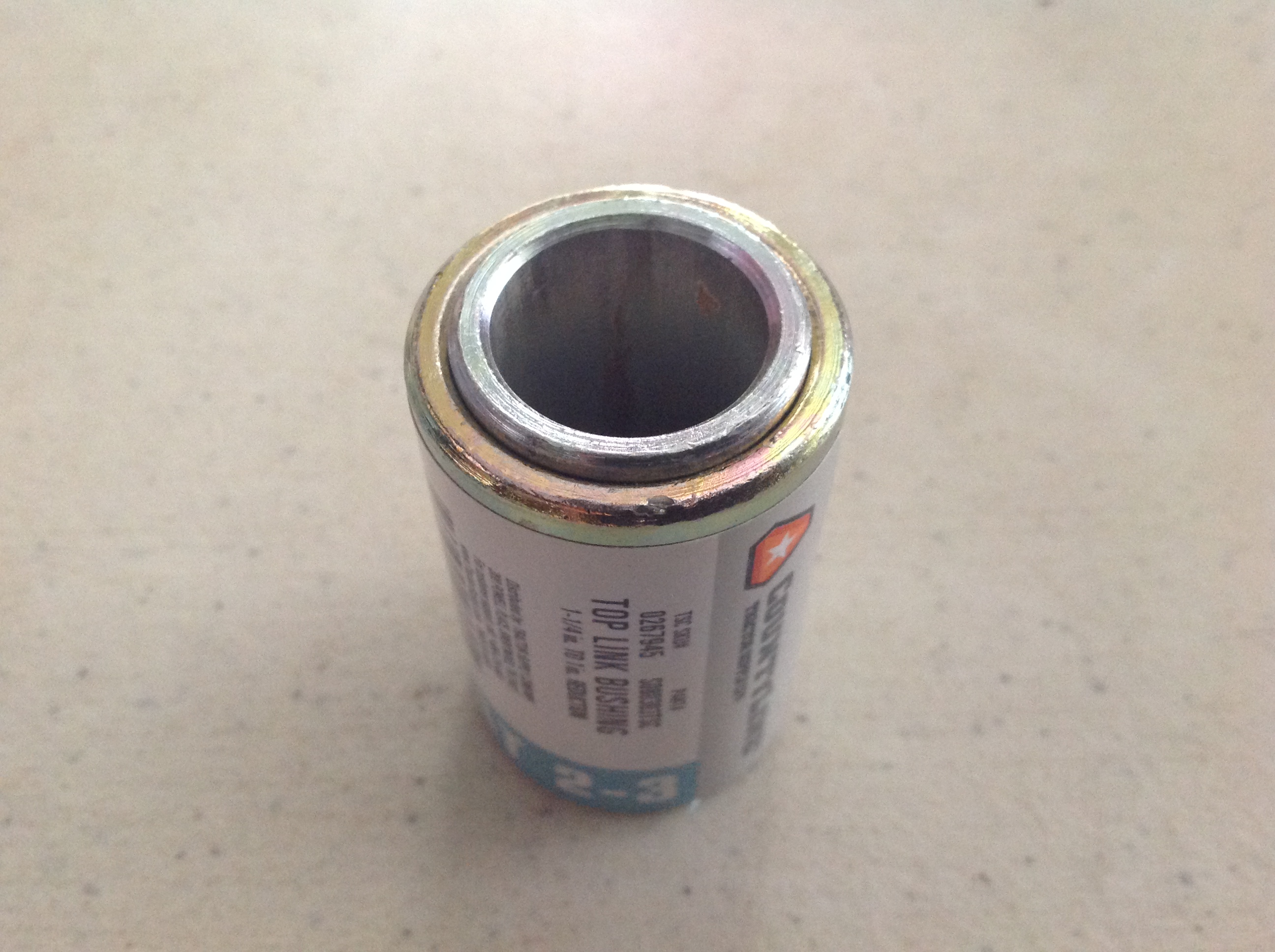

If the top link pin on you implement is 3/4" you would also need 3/4" to 1" bushing to go inside the one you have pictured.

I just spin my own out on the lathe with 0.75"ID x 1.25" OD. I'll pick up a chunk of 1.25" diameter CRS from Alro to make a few and have some left over for other jobs.

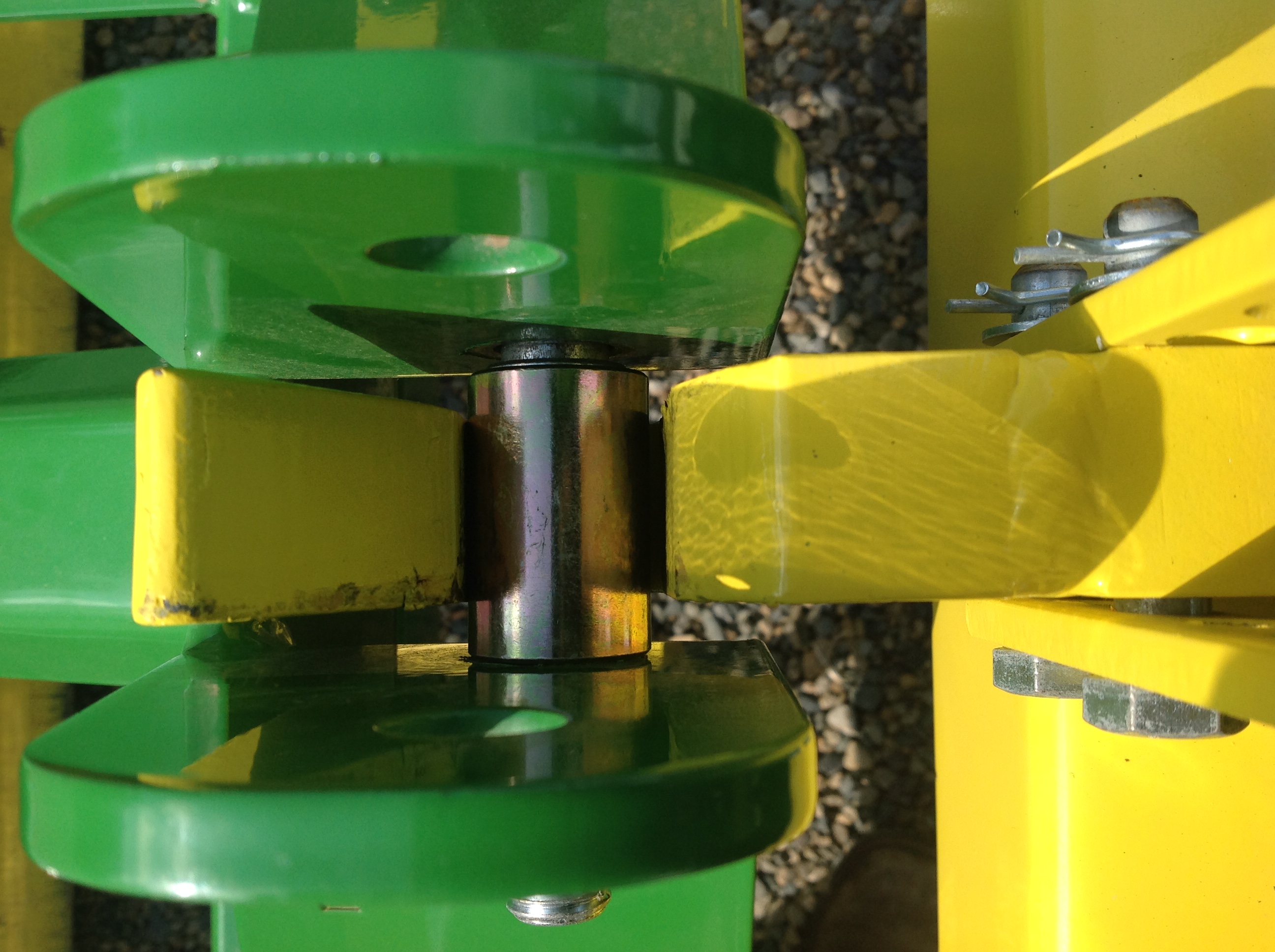

When you buy a QH compatible implement does everyone need to add a bigger bushing for the top link, this size bushing takes up most of the slop except for about 1/8"
Eric is right, you need a cat 1 to 2 top link bushing to fit inside your cat 2 to 3 top link bushing.
Thanks for your help and everyone else that responded, looks like I need to go to TSC today, only have one 3/4" to 1" on hand. Silly me, I thought I was all done spending money:eek:

Be sure to get the top link bushing and not the lift arm bushing.

Thanks for the heads up. Yea that looks a little better, only about 1/8" slack.
