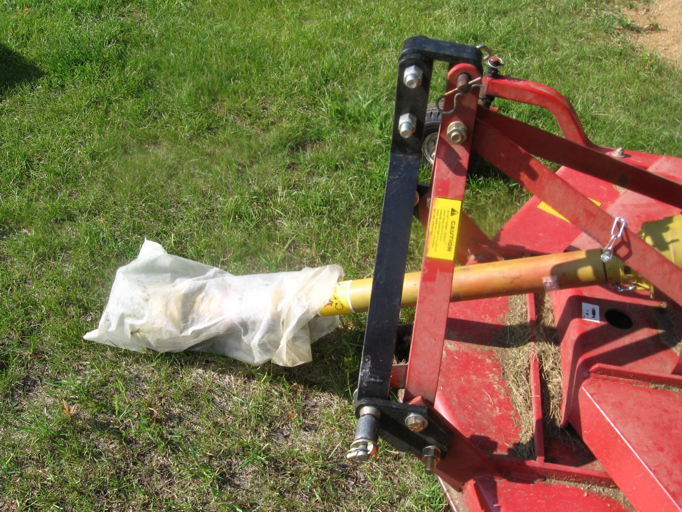

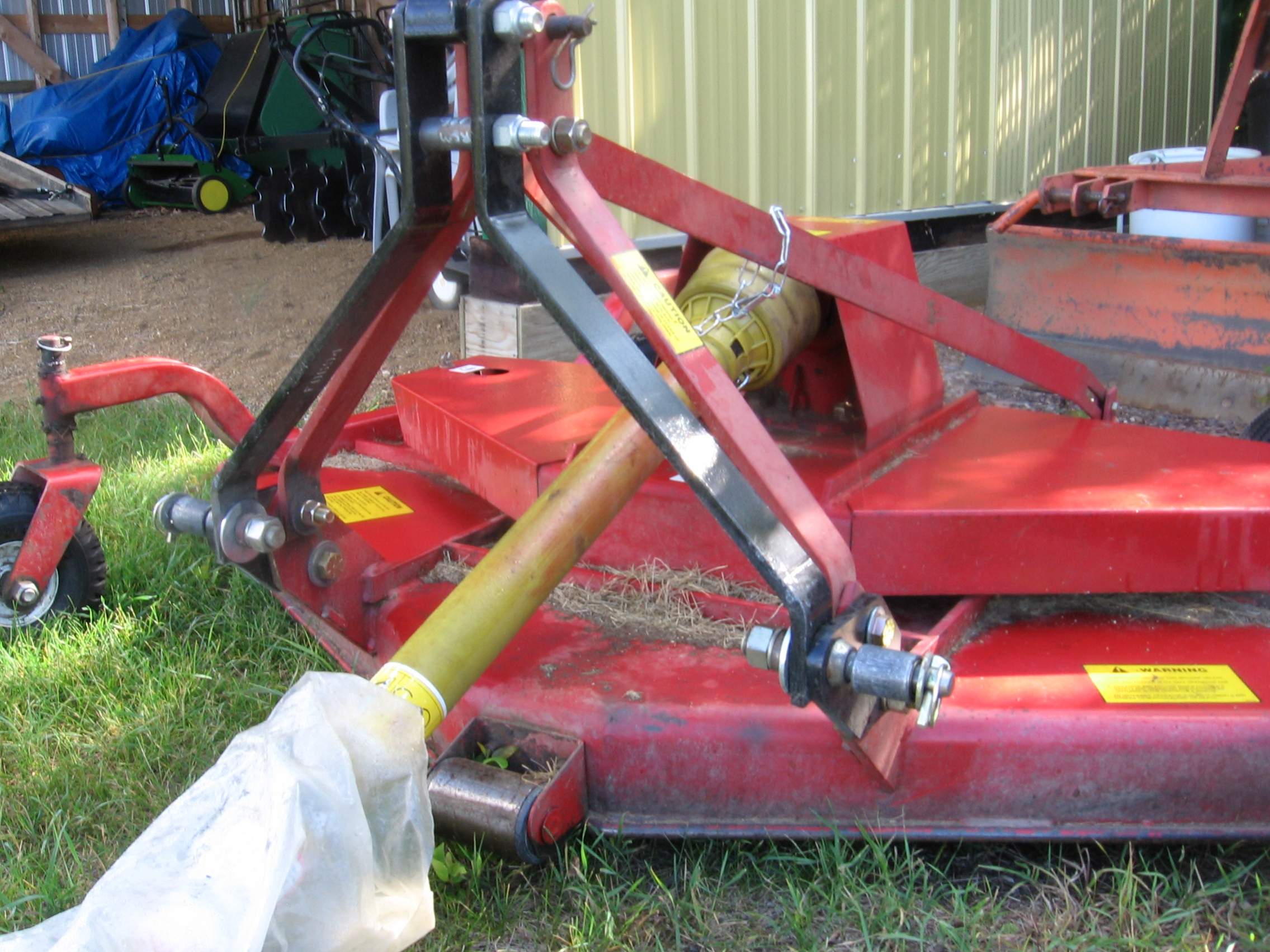

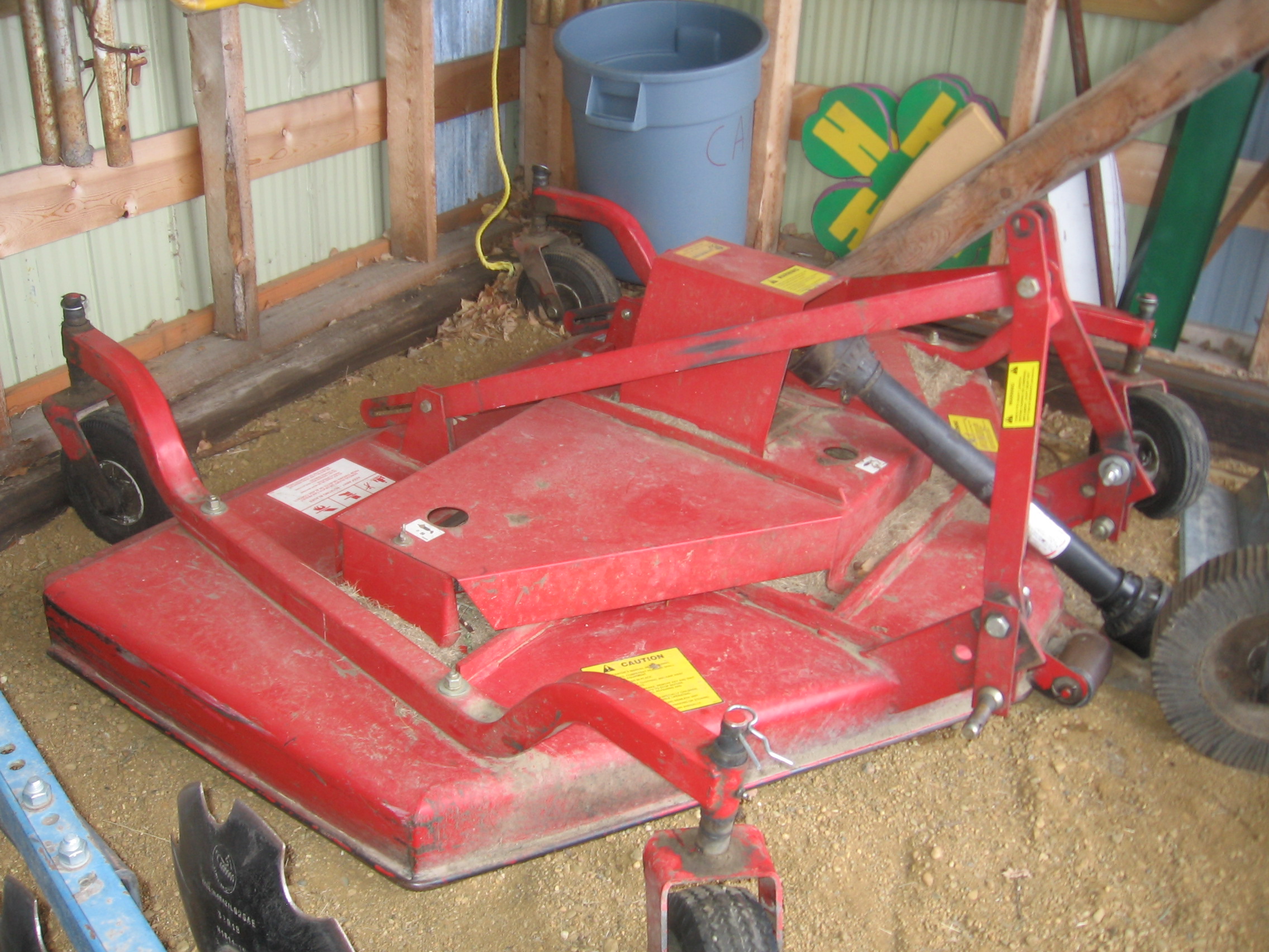

I know exactly what ymarianne is talking about. This spring I bought a new Kubota GL3540 with a Land Pride QH. When I went to hook it up to my Farm King RFM, there was no way that it was going to "mate up". I had the PTO shaft hooked up as well and the QH frame barely cleared it. I was trying to figure out what kind of mods I would have to make to the mower when I decided to go on the Buhler website to see if there was any mention of QH compatability. I looked up the RFMs and on-line operators manual to discover that there was an adaptor kit I could order.
The 1st pic is the mower as original, the second and third pics show with the kit installed (all the black parts). This made all the difference in the world, and works "just like uptown". I really like the QH. ymarianne, I don't think that it would matter which QH brand you have, at least all the ones I have seen are primarily the same, except Pats, and JDs top link is rigid.
When I ordered the kit, I had to get some other parts as well, including a new PTO shaft as the other one was too short for this setup,..... anyways I beleive the kit was $100.00 ish Canadian.

If original poster's mower is anything like Jakes, one can see where there are going to be problems. In the first picture, it is obvious the 3pt lower attachment points are substantially lower than one normally finds on implements, thus placing the pto drive-line higher than normal. Also top link attachment point is much higher than normal 3pt spacing. Looking at pic 2&3 one can see the adapter corrects these abnormalities. Lower attachment points are higher and upper attachment is lower.
The question I have is, why would the mfgr of the mower design it with non-standard 3pt spacing and location with respect to the drive-line?

Yes, that is the kit I suggested earlier. My Bhuler RFM worked with my JD4410 but when I traded for the 3520, it did not fit. Had to get the Bhuler adapter kit and its fine. With mine the trouble was I couldn't get the top hook to go under the pin until the adapter raised the pin about 3 inches.

This was my late Fathers' mower, and the first time I had much to do with it. In the 1st pic., the lower lift pins are bolted onto two brackets on either side of the weldment on the mower. (Actually it should be bolted to the lower hole on that weldment). After you unhook them from the tractor 3 pt., they drop straight down like a pendulum. When operating they would be pretty much horizontal, this is how the deck is able to float. Of course trying to hook them up on a QH would be like hooking up to a piece of rope, and as you can see on the top link, it just was not possible to hook up. But you are right as far as stating that obviously by having the bottom pins higher, it certainly made all the difference with the PTO. Dad used it on his Ford 800 up until last fall (bought new in 1996) without any issues.
