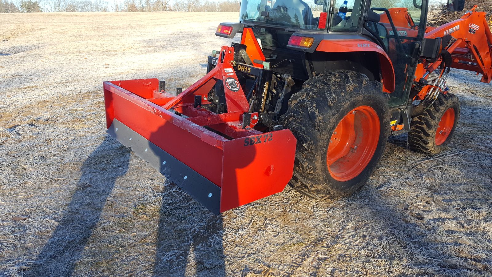

I keep my Heavy Hitch about midway. The other day I accidentally lowered it and actually bumped off a weight on the ground.
/ Quick Hitch Questions #60
I have Land Pride QH15. My dad has a Worksaver model (I don't remember the number of it).
The Woods Quick Hitch I just bought looks identical to the Worksaver to me. I wonder if Woods just rebrands Worksaver? I bought at a Massey-Woods dealer. Worksavers appear to be $50 to $100 cheaper than Woods online, but that doesn't include shipping. Mine was $400 and came with a top link adapter for older implements/need for floating hitch and also a set of bushings.
