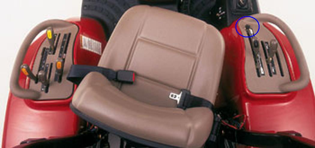

But, if the remedy isn't the quick hitch adapter for the mower, I've got a problem because I don't think there is a lift control stop on the 3pt hitch lever on a DX40.
Rich
As I recall, both the DX and TC series have lever stops. I found these pictures on the Case-IH and New Holland websites; both appear to have lever stops. Is it possible yours fell off?
Thanks,
I guess mine must have fallen off at some point. But, wouldn't the 3 pt hitch still eventually bleed down to rest on the PTO shaft over a period of non-use?
Rich

I have had my lift up on my DX 29 for several days without it noticably bleeding down with a quick hitch on and no weight on the lift arms. Even if it did bleed down and rested on the pto shaft, the amount of weight resting on the shaft is negligible.
Call your dealer, you should be able to get a lift stop. Now I see why your having problems.
