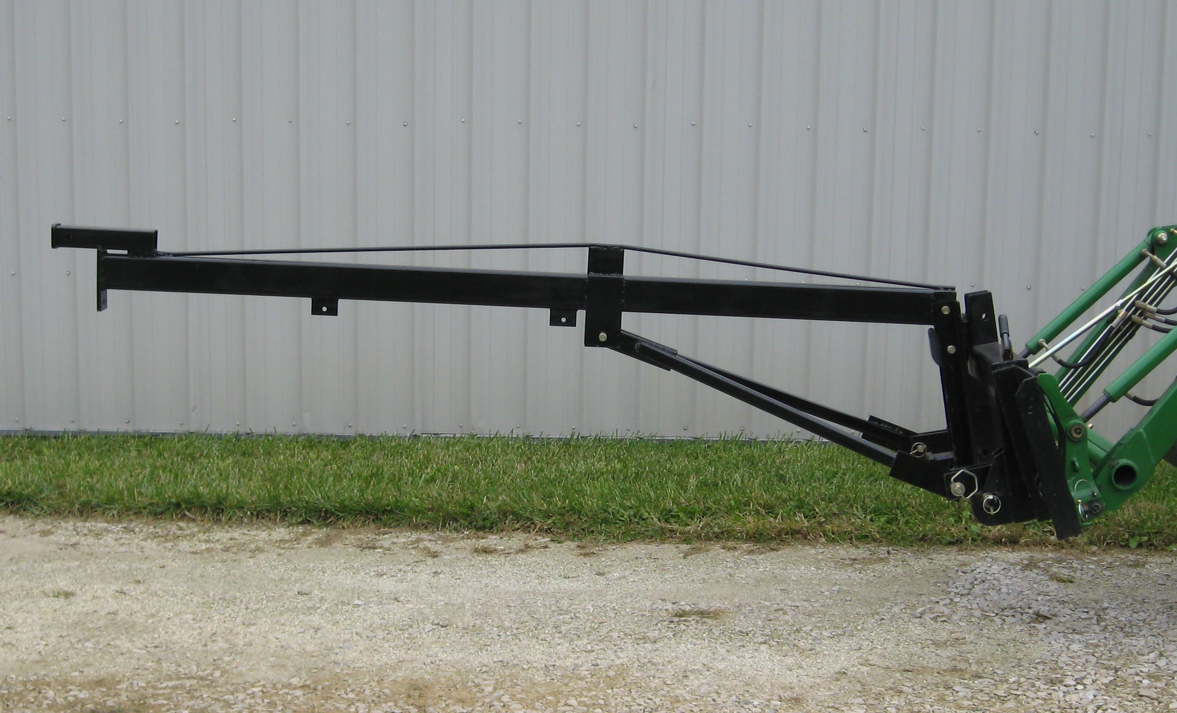

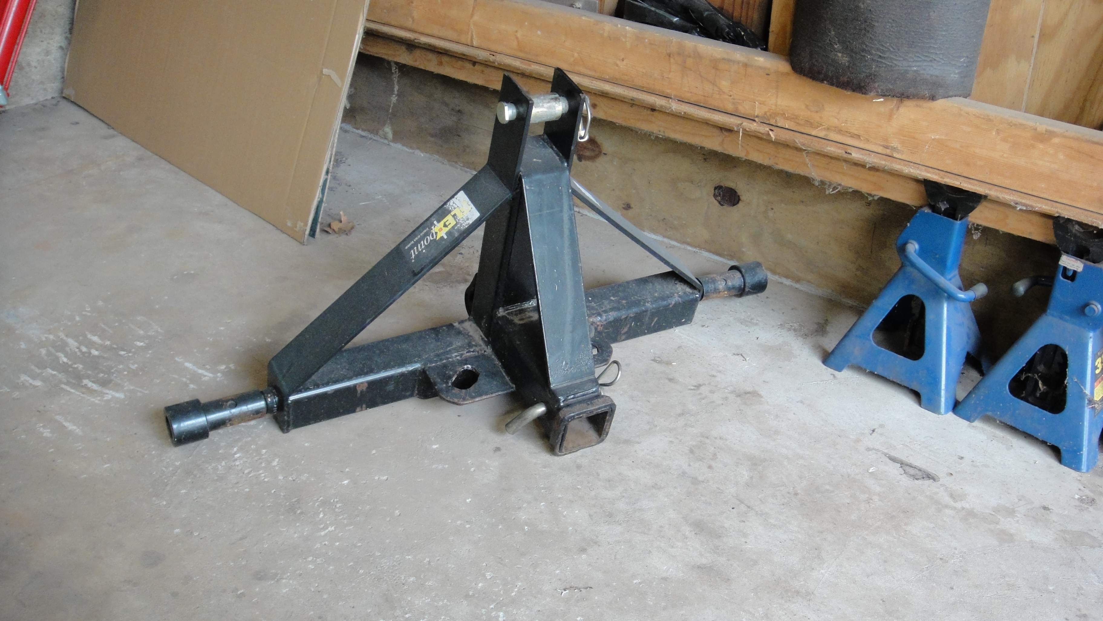

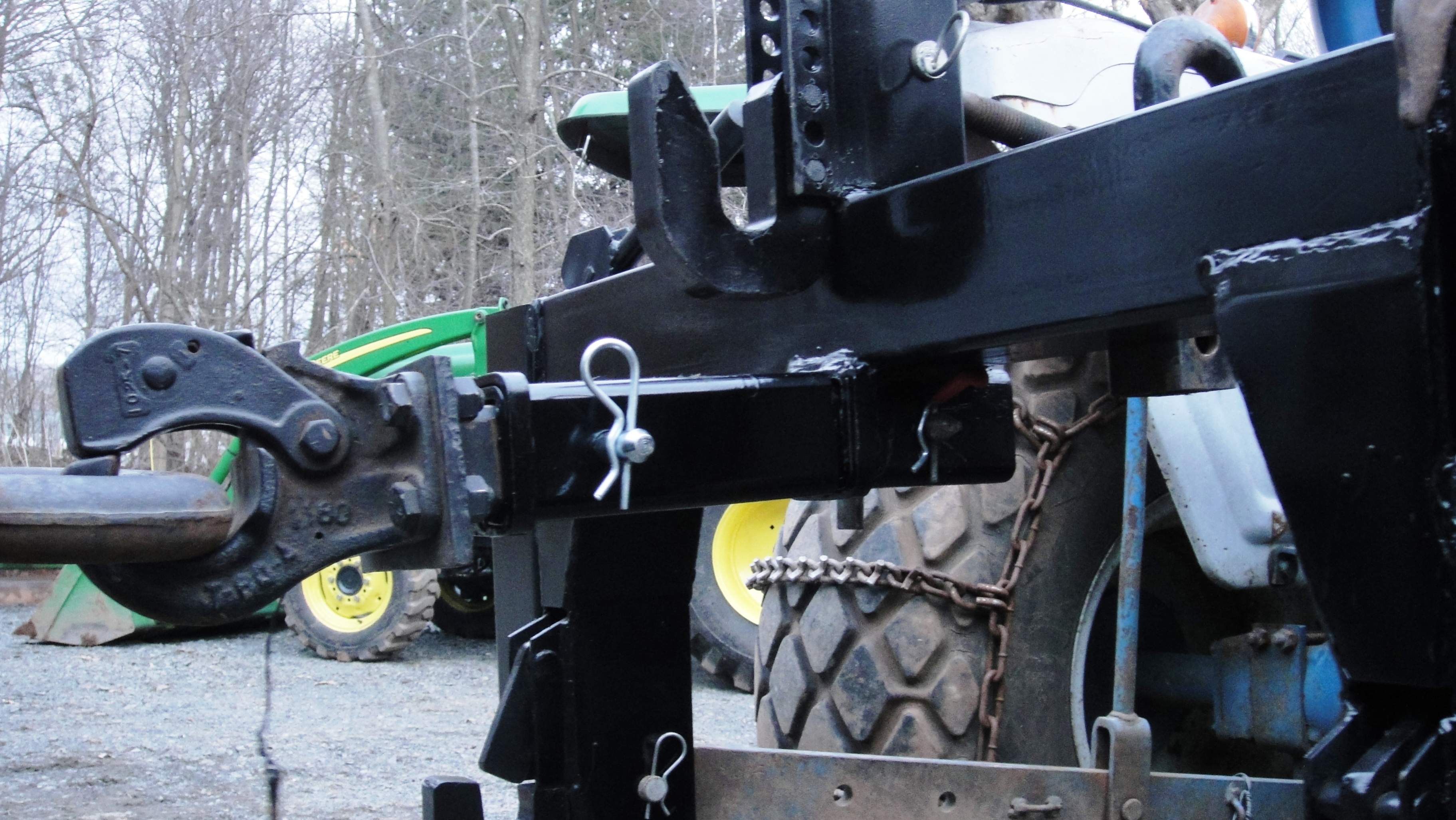

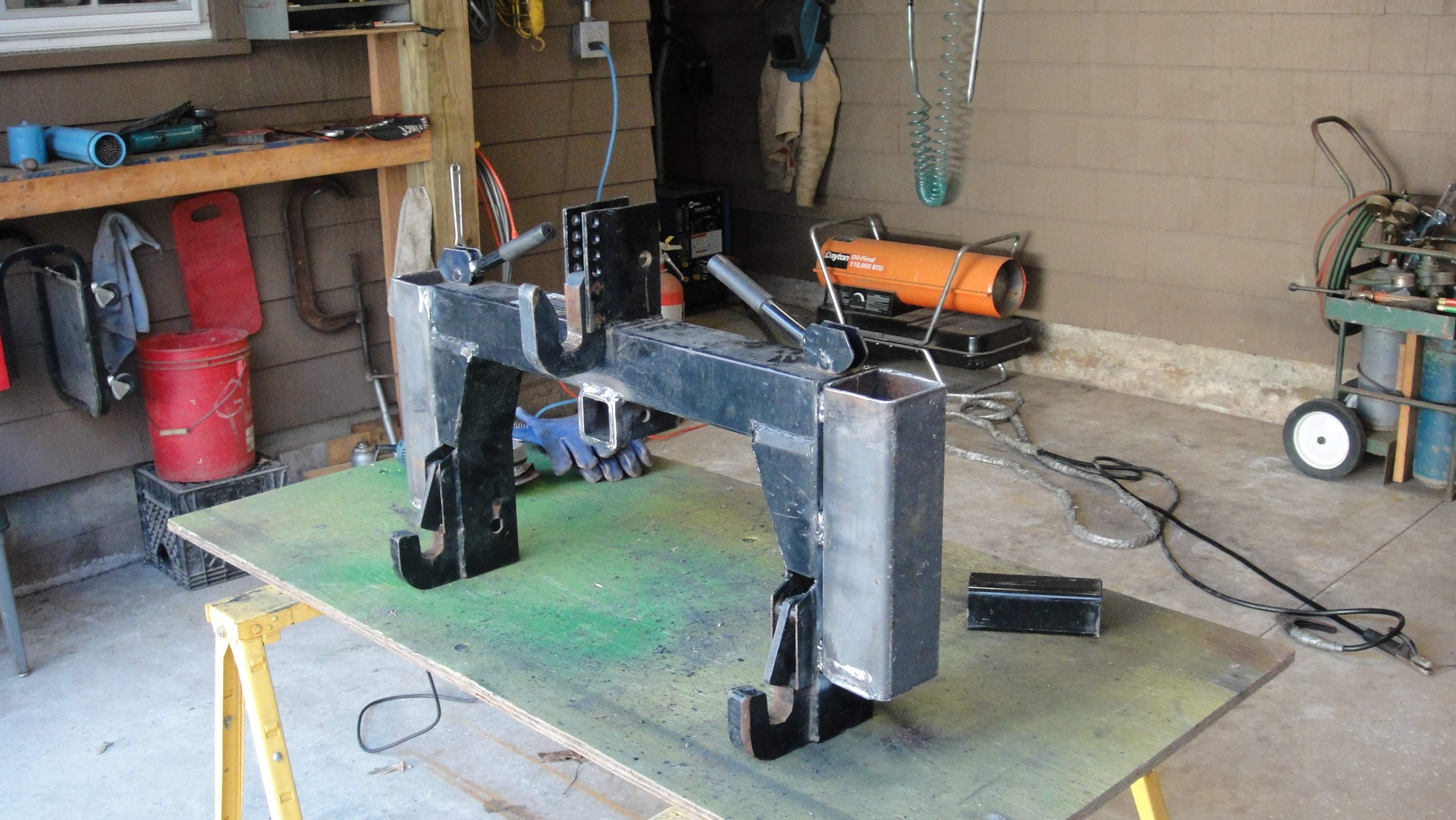

I made a couple of these using a pre-made receiver, drawbar from TSC and a couple of pieces of angle iron.
Runner, are you using those brackets on each side for the trailer safety chain?
   / Quick Hitch to trailer adaptor? #12
Thanks, It's modeled after the Heavy Hitch
Looks good, Kenny.
What is the wall thickness of the 2" square tubing?
I assume the rest of it is made of 3/8" x 2" flat bar stock?

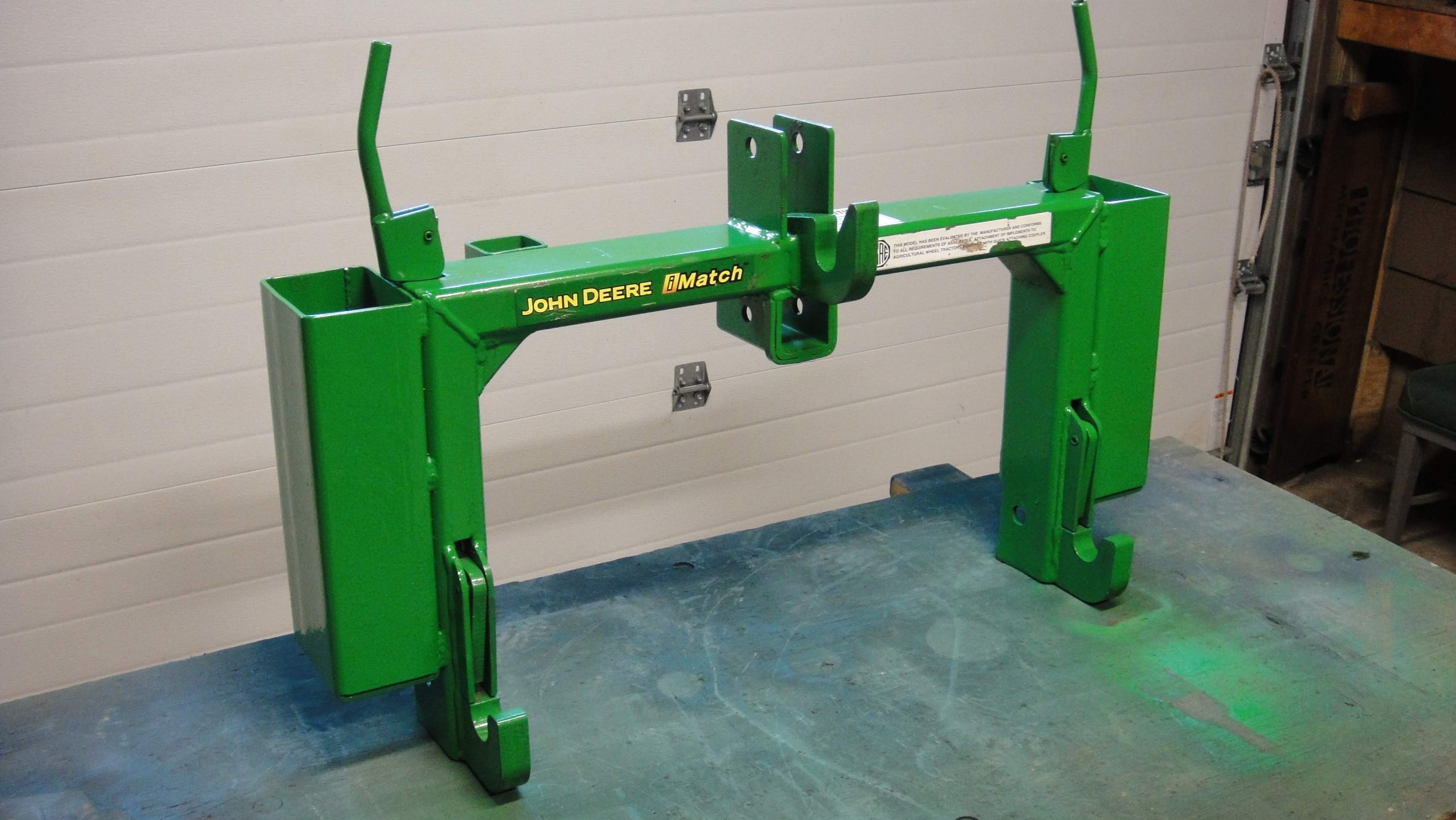

If you do a search for quick hitch, you'll find lots of mods including welding a reciever to the quick hitch frame. Happy hunting.;)

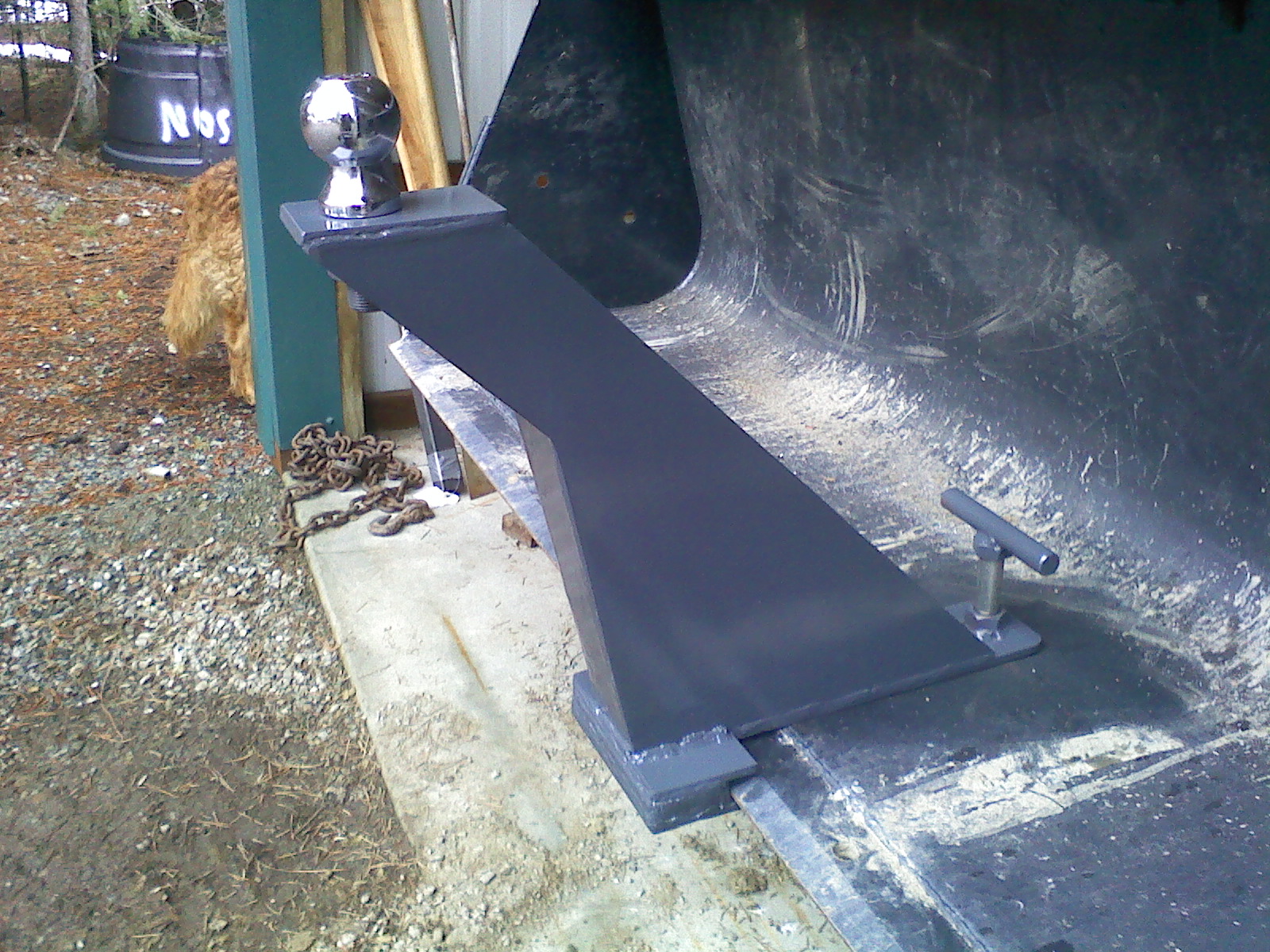

I have no "plans", I just eyeballed everything. The first picture is how I built it the first time, the second and third is after I re-did it to hold suitcase weights.
Kenny, Could you do one of those in Bobcat Orange or Charcoal so I could buy one form you. Afraid tractor would refuse to lift it if was green :laughing::laughing: Great looking hitch, I like the suitcase weight idea especially.

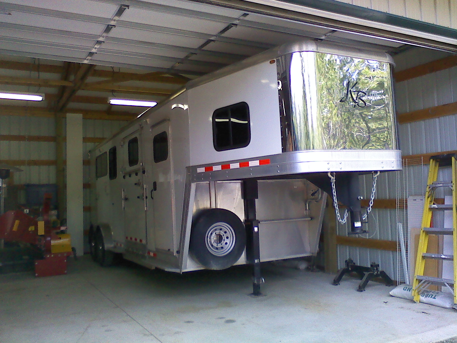

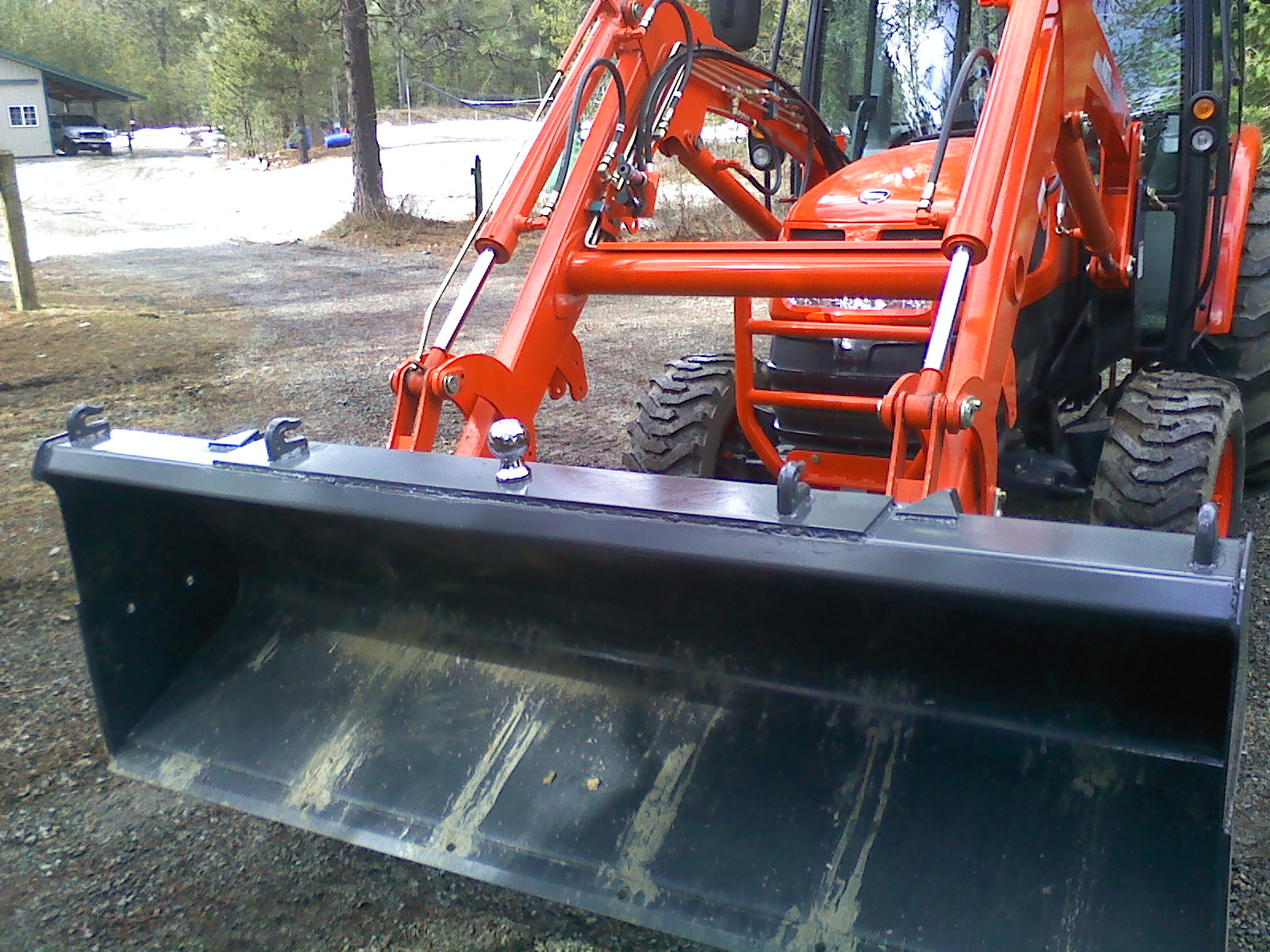

in my own humble opinion, which no one but I seam to value, i would rather go with a ball up front on the loader.
I tried the rear action, but it was harder to maneuver around obstacles.
With my loader mounted ball, i can move anything ....with amazing accuracy. I move a 29' gooseneck trailer into my 30' barn with 2" in the rear and 4" in the front and 3" on top of spare room. never get close to hitting anything.

GRS - makes more sense to me. Having the steering axle (front) as close to the ball as possible allows you maximum maneuverability and stability. That's how tractor/trailers are designed - short tow vehicle, long trailer. There's a reason for that. Plus you get to look forward and not over your shoulder all the time...

"Runner, are you using those brackets on each side for the trailer safety chain?"
No, those are for mounting my boom pole.

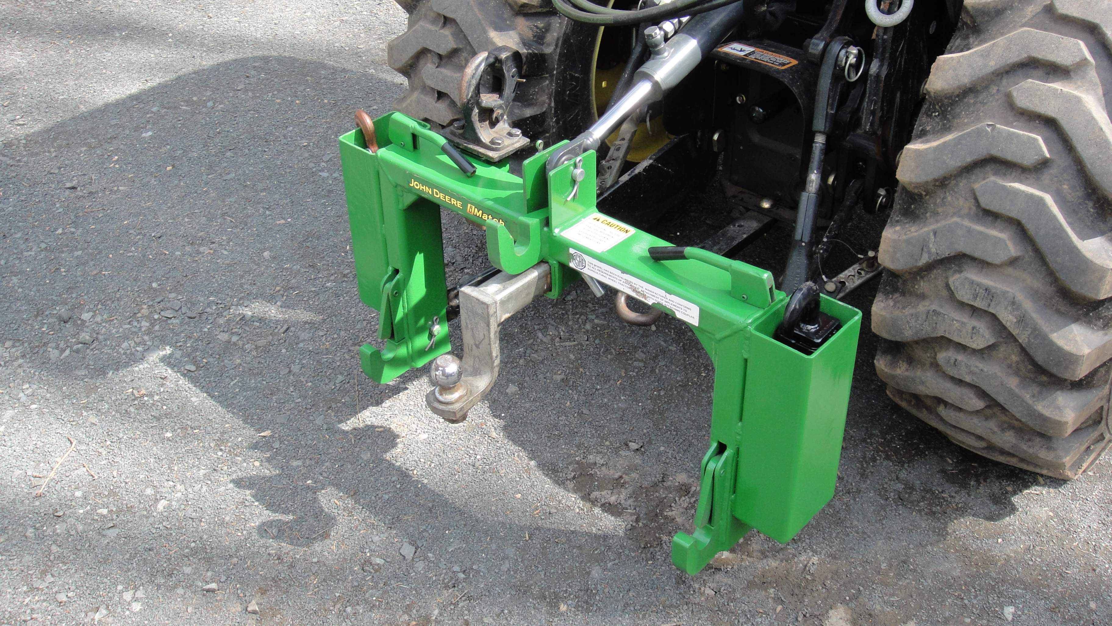

Mine isn't pretty, but it was cheap. i bought a drawbar, welded a used receiver hitch assembly and a piece of scrap channel iron for the top link. cost was under 40 dollars. Paint would cost too much...

Doesn't have to be pretty to work.
I may do something like that myself. :thumbsup:
