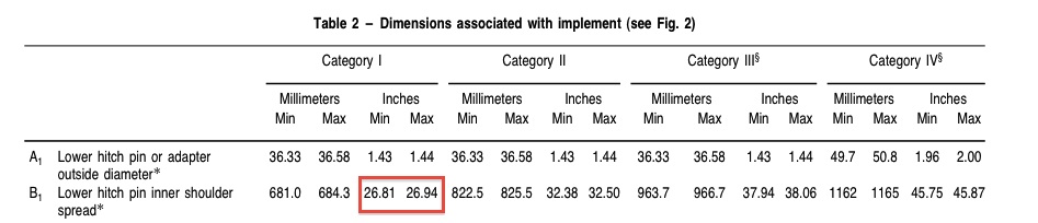

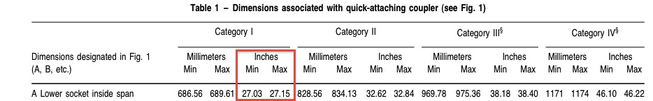

Sounds like the implement is a bit too wide, too.
ASAE standard for quick hitch inside width:
ASAE standard for implement width:
