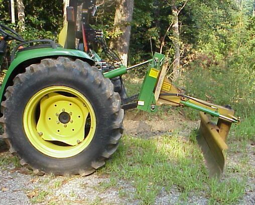

I have a T'n'T I made for my JD 4300 and a Speeco hitch that I couldn't do without. I have previous posts but all the pictures are at Webshots-3 or the other albums listed on the left of that page.
NO problems with the combination of T'n'T and Quick hitch except the minor extention of the length of tool attachment. It will move the implement back a couple inches. Be sure the top link will handle it, hydraulic or not.
Go for it.

After looking at your pictures I'm now totally convinced the Speeco will work with a Top & Tilt. /forums/images/graemlins/grin.gif Thank you for the link.
I'm still not convinced that Pat's system will work, though. Their ends lock to the lower arms themselves and don't use the movement of the ball sockets. I'm not all that concerned now, however, as I now know what I already have will work. /forums/images/graemlins/grin.gif
I'd also like to compliment your custom hydraulic blade angle system on your rear blade. I couldn't help but notice you also have a four way bucket on the front. No one can say you're not a fan of hydraulics. /forums/images/graemlins/wink.gif /forums/images/graemlins/smile.gif /forums/images/graemlins/grin.gif Nice set up you have there. /forums/images/graemlins/cool.gif

After seeing those pics, I think the Pat's I have would work just fine with the T&T as well. The angle of lift does not seem severe enough to be any problem to the EZchange at all. Thanks for the pics JRF. John
