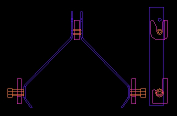

I bought a Speeco after I finished building my 3pt forks and now they don't fit. Here is my easy quich hitch connection soultion:
I wanted a simple hitch connection for Cat 1 quick hitch, so drew the Speeco on ACAD, then started on the connection. See attachment. Flat 1/4" stock could be used for light implements. The solution uses only two pieces of 3 1/2 x 3/8 flat bar that each have three bends. The bends add strength.
The top gets a 3/4" bolt with a Cat1 - Cat 2 top bushing, plus a Cat2 - cat3 top bushing. Lower ends each get a Cat 1 lower pin, plus a Cat1-cat2 and a cat2-cat3 lower bushing. A small weld blob holds the lower bushings in place. Lots of bushings, but less expensive and easier to find than the Speeco bushing kit.
Note the 45 degree bends guide the Speeco hooks to the correct side-to-side position. I think you could be off as much as 2" to the side when backing up and the angles will move the implement and get the hitch connected easy. This is a "design for assembly" concept from manufacturing engineering.
The top link connection also gets a 3/4" hole at 18" spacing so it can be used with a standard 3pt hookup if the lower bushings are removed.
I have a set of these being bent at a machine shop. If they work well I'll post pictures of the finished assembly.
Adapting my implements to the Speeco take time, but it is rewarding when I can change implements in only a minute.
Wish I could compare these to the actual ASAE standard, but ASAE has a monopoly and have priced the standard out of my budget.

What's the shop charging you for the bending? .. and are they going to drill the holes in the pieces?

I don't have a clue yet on the price. The sho is very reasonable. I drop of the drawing and find out the price when it is finished. $35 per hour. The cost would be much lower if a shop with a brake would bend the pieces. With a digital back stop they could bend about 100 in an hour.
I'll drill the holes with my drill press and the $18 set of silver and Deming drill bits (9/16 - 1") from Harbor freight. Great buy.
If I have a bunch made I will build a simple drill fixture to eliminate layout time.
I would post a dimensioned drawing for you if I could figure out how to export ACAD to JPEG.

DWG- em14
Only an engineer would have a .DWG AUTOCAD program..LOL
/ Quick hitch #30
Re: DWG- em14
And if he exports the drawing as DXF, just about any graphics or CAD program can read it.
/ Quick hitch #32
Well, I tried a DXF but TBN booted it out. Must be a graphics picture type file.
If you want one email me. I'll try to reply with it.

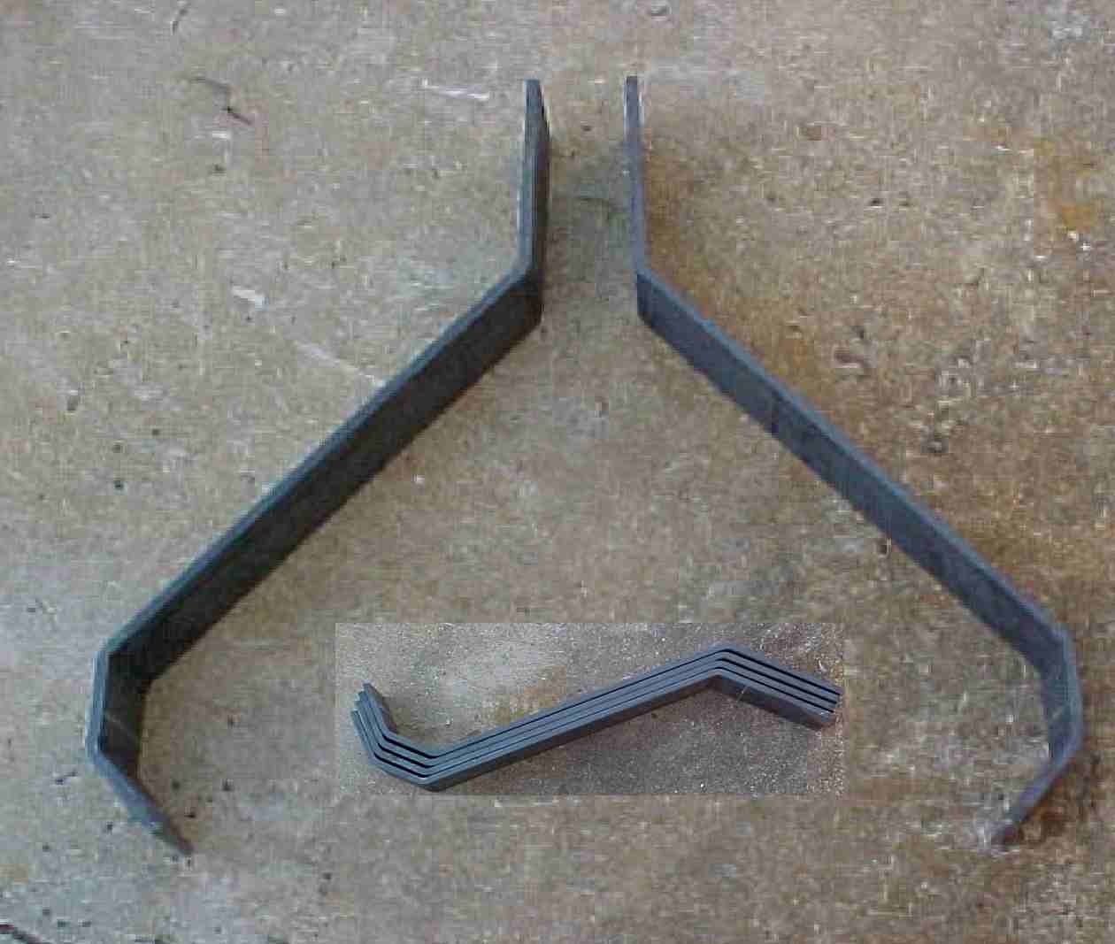

I picked up the pieces yesterday. I had them build four pieces or two sets. The set up time is the same and each additional set takes only six bends or a few minutes more time.
The total for 3/8" x 3 1/2" material and for bending was $51, or about $25 per set. Labor for all was $35 or one hour. It is a good shop.
I will drill the holes. Harbor freight has a 9/16" - 1" silver and deming drill set for $18. I got one for use with my drill press and they look great.

Sounds like you have a great idea going, I assume you're going to replace the existing "arms" of your implements with the ones you just had bent? Most of my implements have a third "arm" that extends to the top of the A frame. (The piece that is in the way of the top hook of the quick hitch). Do you plan on cutting this out with a torch and re welding in some way that it doesn't interfere with the quick hitch hook?
/ Quick hitch #35
Not sure. I made these to add to a boom pole and a big 3pt forks attachment. I think I will be able to drill them, mount the pins, tack on a spacer to keep the lower pin spacing correct, then weld the assembly to the implement.
