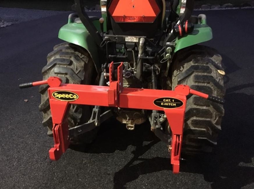

Probably could have save a few bucks not getting it from HF.... Everyone who has commented about HF quick hitch has commented on mods to make it work or additional parts to buy and therefore no much money saved....
I have the BE QH1G and no mods were required to just hook things up...

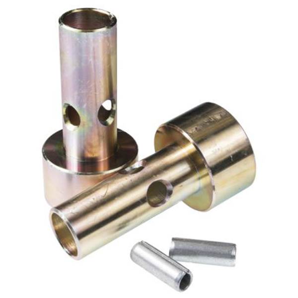

Also, correct me if I'm wrong, but I'm pretty sure that the lower link hooks on the Speeco Cat 1 hitch have an inner radius that will only fit the 7/8" diameter of a Cat 1 pin. That's a big negative in my book, because it can't be used with this popular type of Cat 1 adaptor, which I like for easier hook-ups on several of my implements that don't use a clevis-style link pin setup: Bushing Kit-Quick Hitch Bushings | Agri Supply 77869
The current model of the HF QH has lower link hooks that are sized to fit those bushings. If you want to use them with the standard Cat 1 pins, just cut some DIY bushings from 1" I.D. galvanized pipe, or pick up the tube-style Cat. 1-2 bushings at a farm supply store for just a few bucks. I much prefer the flexibility that the larger inner hook radius allows.
