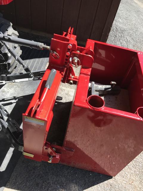

I find my farmex QH to be very useful, no bushings needed.
