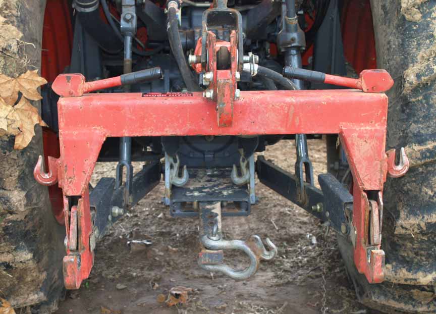

Instead of the expensive Speeco bushings you can use cat III to cat II bushings slipped over Cat II to cat I bushings. The T shape is not necessary. Tack weld the bushings to your pins or use big roll pins and grind off the excess roll pin.
All you need to do is make the pin diameter same as a Cat III pin.
Congratulations on the quick hitch. I love mine. If you have to modify your attachments you should make them match the Cat I quick hitch standard withtop link pin 15" higher than bottom pins. This is better than adjusting the Speeco top hook with the bolts because if you or your neighbor get a JD I-match everything will fit.
The JD hitch meets the standard. The Speeco can be adjusted to meet the standard, or misadjusted so it does not. Why not make your equipment meet the standard?
IMO the I-match is best at about $237. Speeco is good at $200. (I have both.) This Cat I quick hitch system setup is superior to the Pat's system, of course Pat won't say so.
Weld some 3/8 grab hooks to the side of your hitch. Very handy. Note the big shackel with a grab hook welded to it on the drawbar. Also very handy, but sometimes the Speeco hits it.
When you shop for implements ask the dealer if it fits the Cat I quick hitch standard. The more people who ask, the more message we send to the implement companies. Now days every new CAT I implement should meet the standard.

</font><font color="blue" class="small">( Weld some 3/8 grab hooks to the side of your hitch. Very handy. Note the big shackel with a grab hook welded to it on the drawbar. Also very handy, but sometimes the Speeco hits it.)</font>
<font color="green">JRP From the looks of the picture you sure do like grab hooks. I counted five unless there were more hiding somewhere that I didn't see. /forums/images/graemlins/laugh.gif
