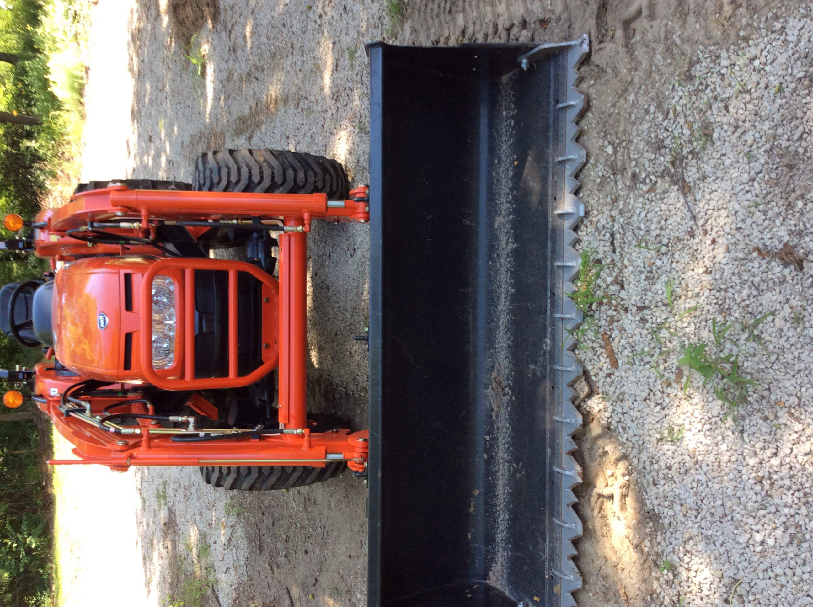

I used Ken's bolt on hooks. Took about 30 minutes to install all three. So far they've stood up to everything I've thrown at them. image.jpg

Kenny's website FAQs say not to use bolt-on hooks with double wall loaders. I 'believe' the top front edge on the KL130 loader on my CK27 is channel. I assumed this is what he meant, since it could compress when applying torque during the install..
Can the bolt-on hooks be used with a CK27 KL130 loader bucket? (pics Monday if needed)
Thanks.
/ Quick-on buckets hooks on Kl401 loader #12
Pics would help Dave. I know some of the LS tractor buckets have thick heavy rectangular tube that runs across the top and guys have bolted hooks to that without a problem. The disclaimer is really for some buckets that have two thin (like 10 gauge) material making up the roof of the bucket.

Well, I promised pics Monday
And now it is Thursday and I finally have one. Took more, but they all look about the same!
The top of the bucket folds over a 3"x2" channel (square tube). Over the front and then about 1/2" around under the bottom of the channel.
I'll be emailing Kenny, too, but for any others interested my question is whether I can run a bolt all the way through the channel for bolt-on hooks. :)
/ Quick-on buckets hooks on Kl401 loader #16
Davrow, I think your fine with the bolt on hooks, the top of that bucket looks quite substantial.
