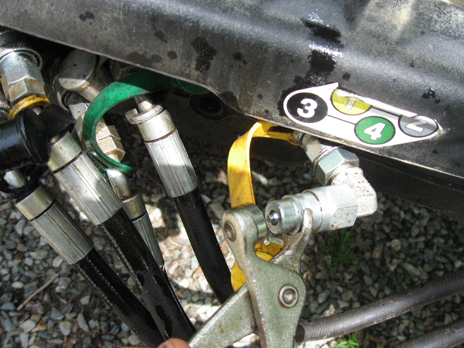

You can make a tool to relive the pressure for under $10. It's one of those things you don't need until you need, and then you realllly need it.
/ Quick question about new FEL #10
Looks good just remember to put a heavy rag over it.
I use to have the problem all the time with my truck mounted snow plows, I would just tap the ball against the plow to relieve the pressure, get a little extra ooze.
But when I had it happen to my loader, it had some serious pressure and when I got it to relieve I took a shower in H fluid :mad::eek:
JB
/ Quick question about new FEL #11
wow thats homemade? great job.
You didn't see my starting point. :)
CLECO SHEET HOLDER PLIERS from Aircraft Spruce
Trust me, I'm not an experienced fabricator - just reasonably innovative.
I used this very fancy CNC grinder to get the jaws to fit.
You can use a rag if you want to avoid mess, but the cup that's naturally built into the tool slows down the jet of fluid *and* directs it away from the user. It's just about perfect for the job (I do wish the jaws were a little thicker; they end up being pretty thin when the grinding's done.)
