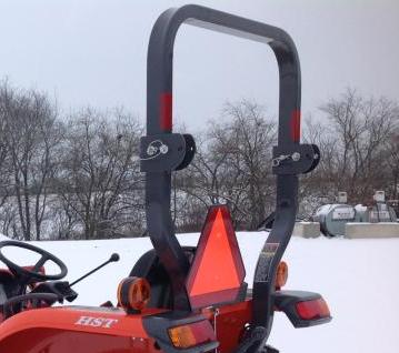

I have an L3800 which I like to keep in my enclosed shed. Are there any acceptable quick release pins that can be used in place of the bolt/nut/cotter key? I use the tractor at least every other day so removing the bolts gets old after a while. The tractor is used in hilly areas,and I am a very safety conscious person; so I prefer to actually have the roll bar in place.

This is the best pic I could find quickly, but you should already have pins and keepers, not bolts. Is this a used machine?

Yes, a year old. 306 hrs when bought. I think the other (new L3800s ) tractors had the same bolts,etc. could be wrong though. Please excuse my ignorance: pins and keepers? There is a flat headed end(like a crescent wrench nearly closed could go on) with a wire loop on it on one side and a nut with a cotter key on the other side with the wire attached to it. Looks very "factory" to me. I do not live near a K. Dealer(live in rural AR). IOT hinge the ROPS down, I have to remove the otter key, take off the nut, etc. trying to avoid this. I haven't looked at your album yet.
If you look close at the picture you should see bolt heads. Kubota uses a bolt that screws into a welded on nut on the inside of the ROPS. The end of the bolt is drilled and a safety pin goes through to keep it from coming out on it's own. It is a pain in the butt and because I don't have any hills but do have a lot of low clearance I leave mine down.

I "now" understand why I was asked about "new" or "used". Mine must have been modified, changed, whatever. Thanks. It originally did have a quick change pin and will have again soon.

Its Factory for sure, when I had the L3400hst. I though about carefully grinding off the threads to make them pins but I never did it. Yes it gets old, every day for sure. I now have a barn, and a sunshade (highly recommended). and a Kioti!.. ROPS and sunshade stay up. Problem solved.. I guess they are just concerned that with pins, the keeper pin could be easily jerked out with a tree branch, and the pin fall out and of course you could roll over with the same encounter with the "friendly" tree. ooops..

I ground off the threads on my rops bolts after the 2nd. day, turned them into pins ! I must lower it to get her in the barn. Huge pain in the backside...not any more. Highly recommended adjustment.

I have an L4701. Same problem with the ROPS, as I have to lower it to store in a garage with 7' door. I definitely want it up while mowing, as I have some pretty decent slopes on the property.
I found a couple of 1/2"x3" grade 5 hitch pins at Tractor Supply. These slip right through the welded bolt head with no problems, and the factory tethered retaining pins work in the hitch pins. I keep the original factory bolts mounted in the holes used for the down position. When you lower the ROPS top, it only goes down halfway, so easier to pull back up from the cab. Very clean solution with no modification.
Though the hitch pins are smaller diameter than the factory bolt, they are grade 5. Would take a significant amount of force to shear them off.
