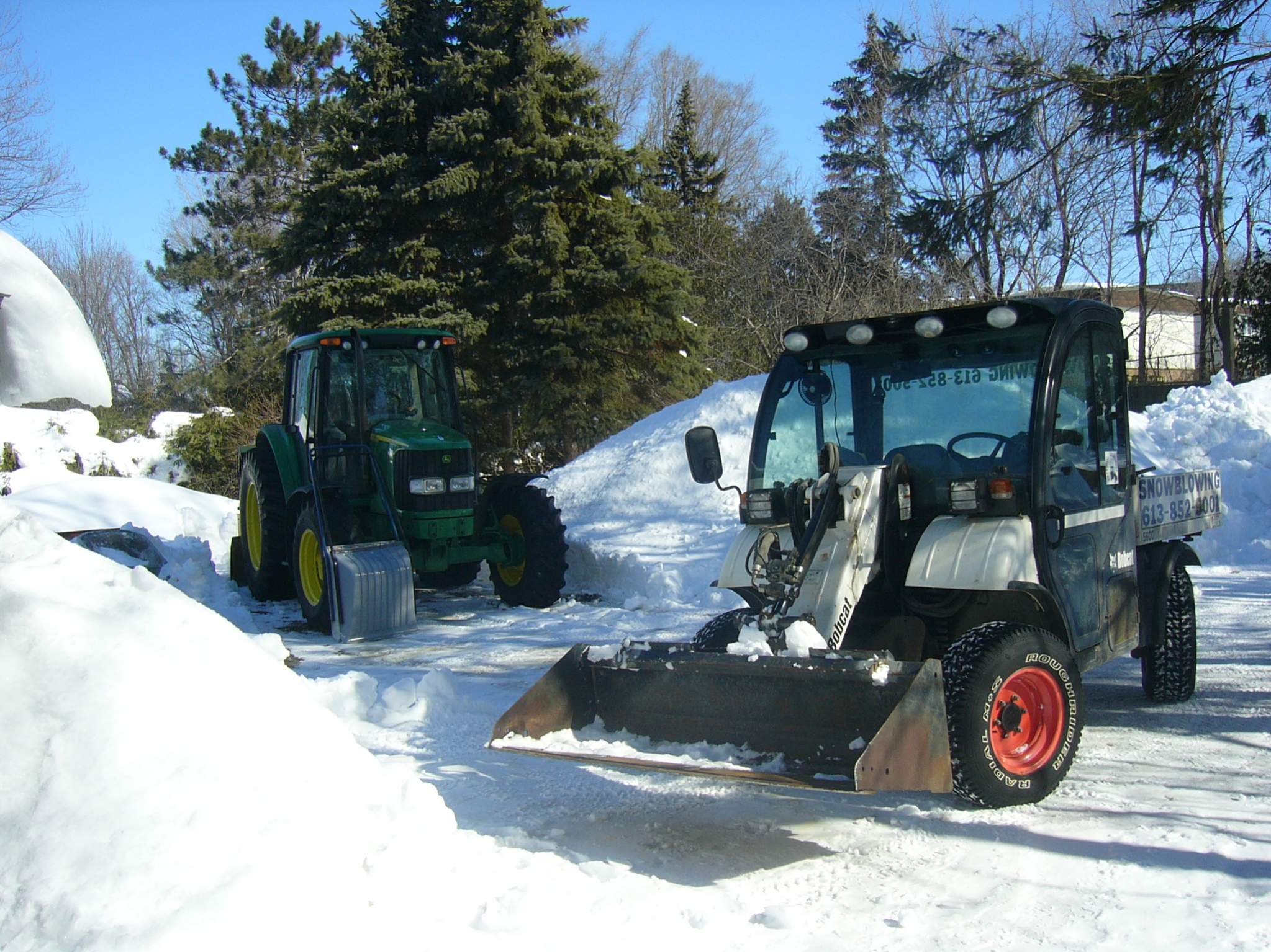

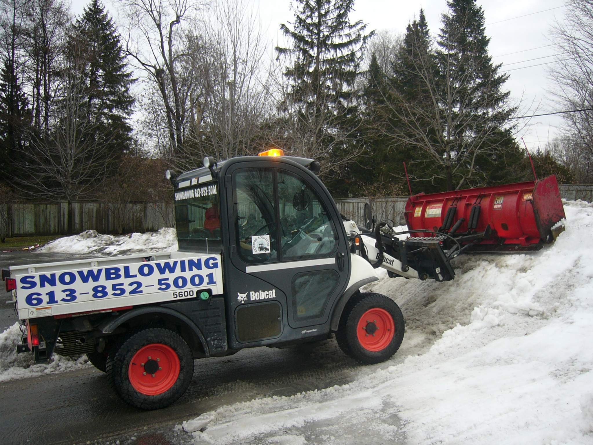

The blower is probably the best tool for deep snow. Even if it has been plowed and you have large piles, the tc blower can chew through them and deposit the snow farther away.
I have the 5' bucket which is not too handy because it holds so little snow.
I primarily use a 6' blower with hydraulic door for pulling snow. It is my best tool and clears 150 residential drives each snow fall.
I have a 7.5' western blade for backup. it work ok but is much slower for driveways. the snow must be moved several times.
I also have a 6' - 10' extendable pusher box. works good for parking lots as it traps snow and helps you relocate it different spots.
It really depends on what you want to do with the snow and what kind of property you are on.

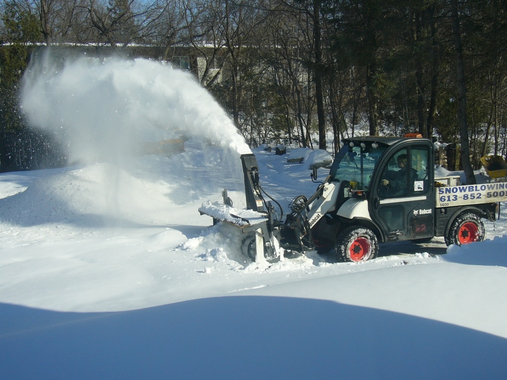

i only use the bucket for scraping.
