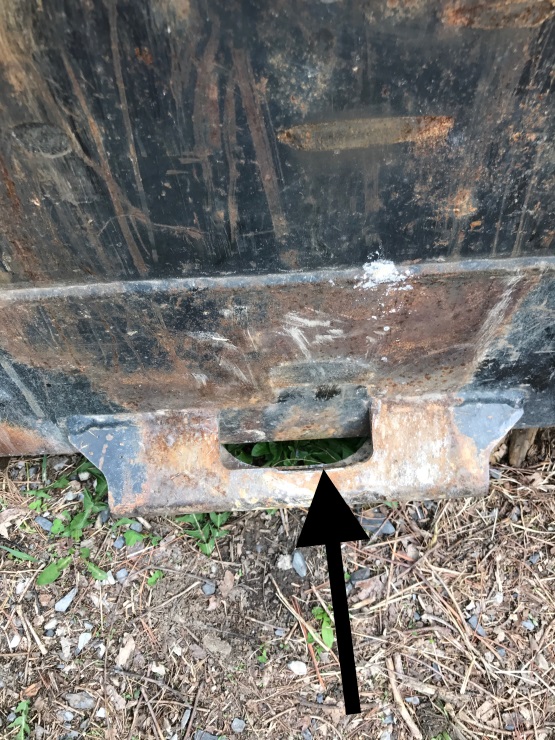

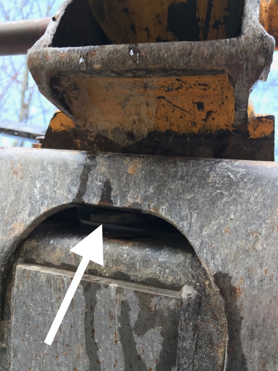

it looks like what ever holds the bucket to the back plate is not correct.
The flange at the top and the latch pins at the bottom hold the bucket in place. It shouldn't move on the plate.
His bucket is worn where the latch pins contact it, but they are spring loaded to take up that wear.
His third picture is a close up of one of the latch pins, looking up from under the bucket.
   / Quick Tach play #12
Are you able to post a video? From the initial picture, I agree with Xfaxman, but if it is only separate in the dump position, that will not be a good solution. It seems as though the bucket is shifting on you, which will be caused by the pins not engaging properly. Are you having this issue with other attachments? Do you have another SSQA tractor/loader that you can use to connect to this bucket to see if you have the same outcome? This would at least narrow it down to the bucket, or the loader for sure!
   / Quick Tach play #13
The flange at the top and the latch pins at the bottom hold the bucket in place. It shouldn't move on the plate. His bucket is worn where the latch pins contact it, but they are spring loaded to take up that wear. <img src="http://www.tractorbynet.com/forums/attachment.php?attachmentid=506427"/> His third picture is a close up of one of the latch pins, looking up from under the bucket. <img src="http://www.tractorbynet.com/forums/attachment.php?attachmentid=506429"/>
Zooming in on the pic of the pin, it looks to be bent,
