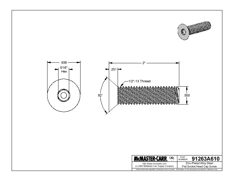

I have an extra Quick Attach plate and I want to bolt on a trailer receiver hitch. However, I’m concerned that the bolt heads will stick out too far in the back to allow the plate to fit properly on my tractor. Has anyone tried to bolt something to a quick attached plate? If so, what type of bolts did you use (so that the heads where flush enough to allow the plate to work proberly). Any pictures? Thanks.

use counter sunk bolt heads,nuts on the hitch side.like to weld on better...jim
   / Quick #3
if i remember correctly, i had to counter sink the holes on the quick attach plate and used counter sink bolts or screws that had a slot in the head to tighten.

Some quick attach plates have predrilled counter sunk holes. Others do not. I made some of my own on one that did not have them. I used 1/4 20 bolts. I later felt this was too weak and about that time I got a welder and started welding items on.

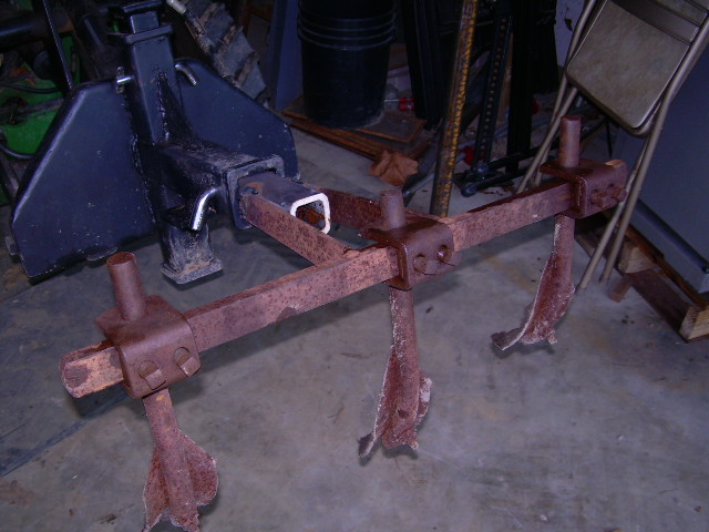

Bring it by my house and I will weld it for you. I live a little west of Richmond Va. I made my own.

FYI, I want to bolt this on, rather than weld, because I intend to ultimately use the attach plate for another project.
I think I will try some bolts like the attached image. Should work I think with a little counter sink.
