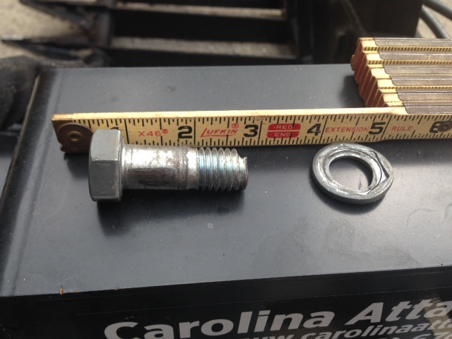

I agree that point loading the grapple can induce twist in the FEL. That's how I ruined the FEL on the 1648. I was clearing brush in the woods and backed my RW cutter against one tree and when I looked forward another tree had grown out of the dirt right in front of my bucket. I had to push hard to get out and since both trees were on the right side it bent everything and messed up the hydraulics. The AGCO insurance policy was great and covered my loss. Because I didn't want to be down for a month getting a new loader fitted to the 1648 I traded it for a 2615. Much heavier tractor with more torque even though both tractors are rated for similar horsepower.
This photo is the broken cap screw and unrated flat washer. MF specifies a cap screw for this location but I think the dealer should have used a hardened flat washer. The unrated ones are not suitable for structural connections.

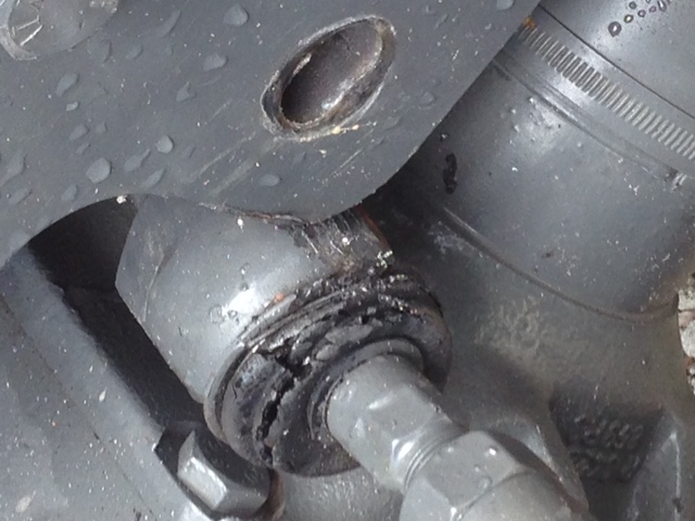

This photo shows the location of the broken bolt and the interference between the steering knuckle and the bracket.

I would not be happy at all with how tight that loader fits. ZERO room for any flex. I am surprised as normally QUICKE stuff is top spec.
Were any of those threads on the broken bolt in the tractor? i.e. did it break then twist out, or just break off flush to the tractor.
Either way looks like you have a broken off stud to remove. Did the broken bolt then allow the mount to touch the steering knuckle?
That washer isn't "right" something to be said when the head makes an imprint in the washer....

I just picked the tractor up on Friday, the dealer picked it back up on Monday. I think I need to charge him rental for the week, Evidently they have two sets of mounts, mine was the one without the reinforcement gussets.
