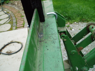

   / Quik attach loader adapter? #13
Your quick attatch doesn't need to be round becauce it is not rotating. I think deere uses 3/16 thick metal. I used a 3/8s piece for the top of my tool bar and cut 2 short pieces off and down to size to make the 2 hooks.
   / Quik attach loader adapter? #14
Here is another shot

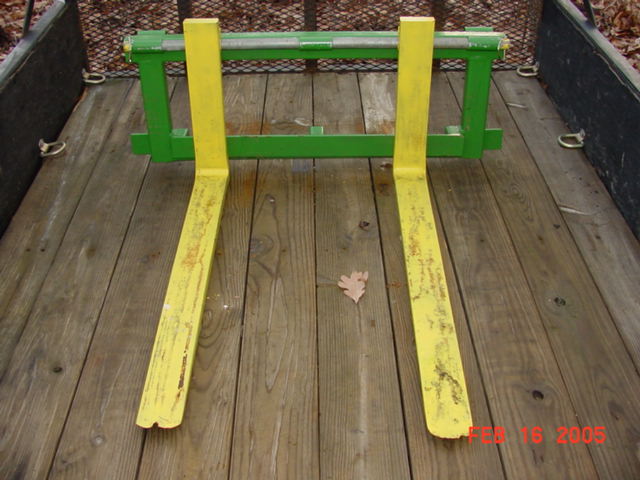

#15
Ordered the parts today $36 total,a little more than deere parts.com,but no shipping.Also picked up shims for raising hydrauli pressure, hope I dont blow anything up. /forums/images/graemlins/shocked.gif

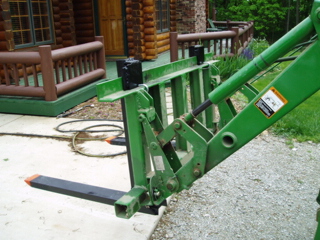

   / Quik attach loader adapter? #16
</font><font color="blue" class="small">( KennyD, could you post some pictures of your fork lift attachment? )</font>
I got home early today, and the sun was shining bright, so I took some pics, I posted them in the Build it Yourself forum, you can view them HERE
#17
Kenny, Those look great.Thanks for the pics.
   / Quik attach loader adapter? #18
nice job
can you give me the size of the top pin that goes in the angle iron
please
   / Quik attach loader adapter? #19
bela_phil said:
nice job
please
Not sure exactly what you are looking for?
   / Quik attach loader adapter? #20
I think he means the top of the mount on your loader that the bucket hook (or angle iron for homemade mounts) hooks over.
