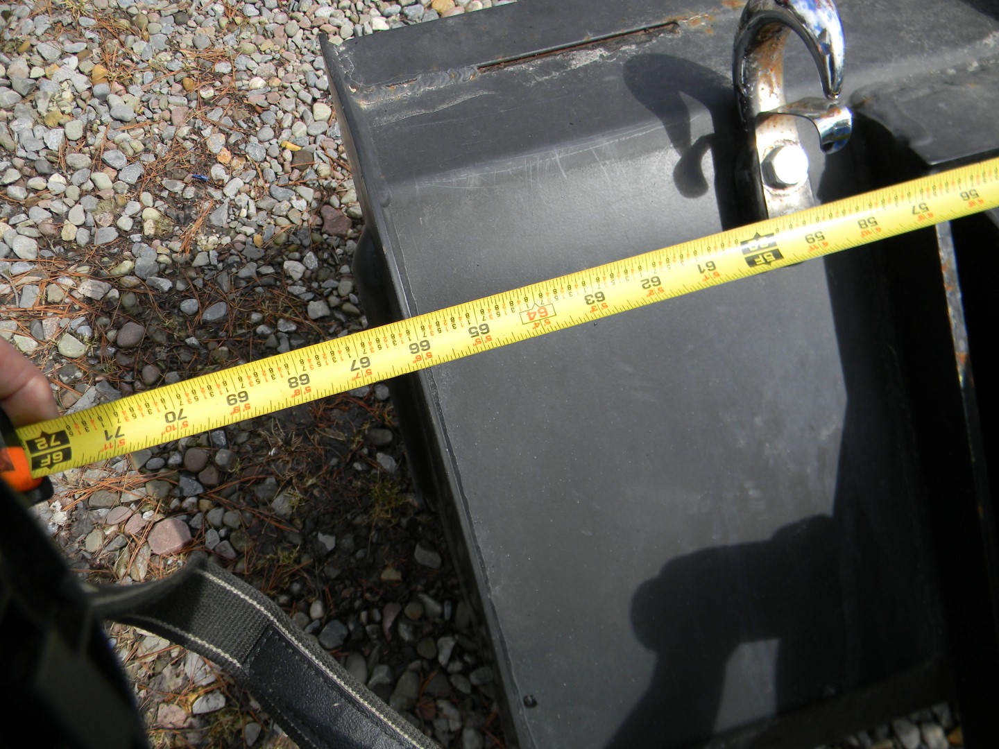

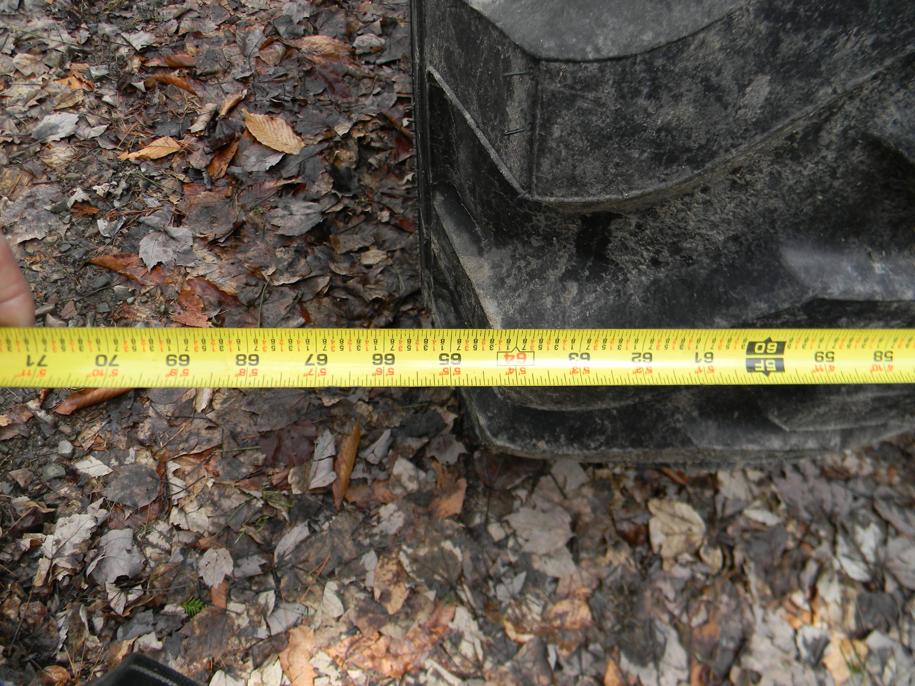

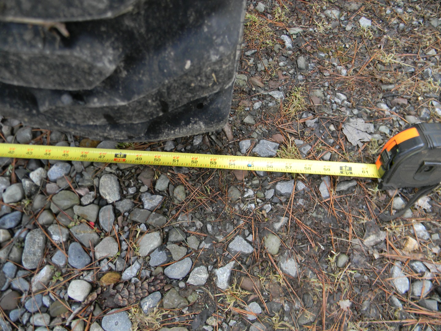

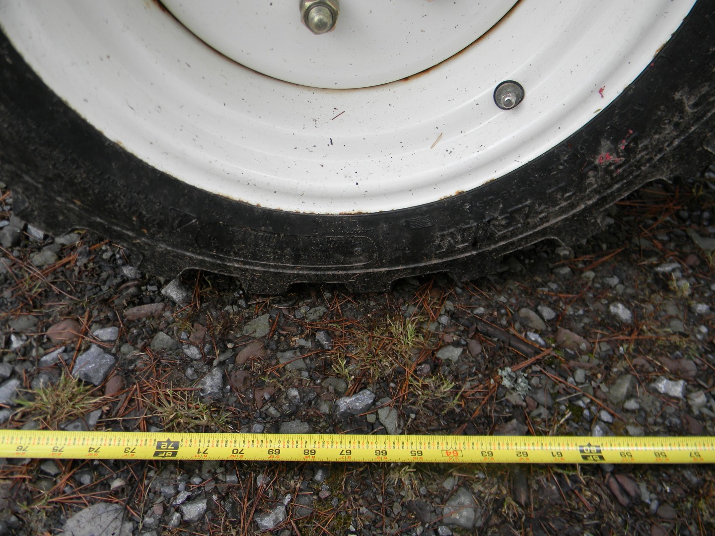

The brochure I got says the width is 57.4" and the wheelbase is 66". You're sure the width is 66"? That will determine if I need a 5' or 6' mower if I get one of these.
   / quote for 3037 premium cab #4
I talked to an LS dealer today and was quoted $23,900 for the XR3037C. Another $1,400 for the hydrostatic transmission.
Yes, unless your getting R1's the R4 Industrial rear tire width is 66" which is the same width as the loader bucket.
Front to back wheelbase on axle centers is about 67". (May be 66", I didn't have an assistant to hold the other end of tape)
Front tire width is 54"
Just took some pics to confirm.
