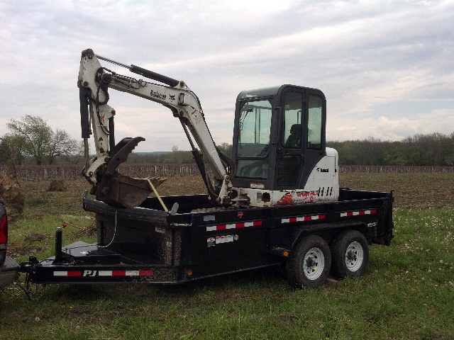

The inside of the box wore out in a few spots and I had to patch it up. But it took about 10 years before the brace on the back of it rusted out enough to cause me problems. At that point we decided the trailer didn't owe us anything and we decided to replace it with a better trailer more suited for our uses. So I sold it off to a friend of mine who had been borrowing it numerous times. He knew the history of it and the problems and made us an offer which we accepted without question and he was happy and so was I. Went out and bought a 14' PJ ultra low profile dump with scissor lift and ramps. I have not hauled anything yet to really test the capacity but so far I have not seen any faults with the scissor lift and power down other then if your battery dies when the bed is up and you let it lower by gravity the valve doesn't open and you will overflow the hydraulic tank. But we use our trailers year round so gravity down was a feature I wanted for winter time.
I have hauled my 1920 in the trailer and didn't have any issues with loading/unloading. Just block the trailer tires and you will be fine.

Has anyone ever used a dual axle dump trailer to haul a tractor with? Could this be done regularly, to avoid. Having two trailers.
   / qustion for diamonpilot and others re dump trailers #26
My neighbors skid lives in the dump trailer after many year and loads no problems
   / qustion for diamonpilot and others re dump trailers #27
Yes, I hauled my 1920 and a bobcat 331 in mine.
   / qustion for diamonpilot and others re dump trailers #28
Thanks guys. Would love a dumptrailer. And wondered if hauling the 1635 (3,527 pounds) was something that could be done regularly.
Would make justifying the cost easier with multiple uses.
