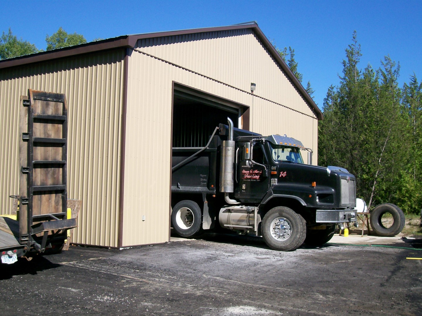

I do this all the time. The trick to get it almost as good as asphalt is rent your self a roller (the heaviest you can afford the better) and the big trick is water the heck out of it as you roll it. Lots of people don't think water does anything, but it makes a huge difference.
We did our yards that have tractor trailers running in and out and turning and they are just like they were paved with new asphalt.
So for best results, get a grader to make it level, then water and pack.
   / Qustions on using Recycled Asphalt Millings to refresh old gravel private drive #10
Can't find my pics at the moment of when we were doing it (we have a water truck and had a little one ton double drum roller), but you can kind of see what the packed millings looks like here.
There is some loose gravel on it from washing trucks and sweeping out the shop.
