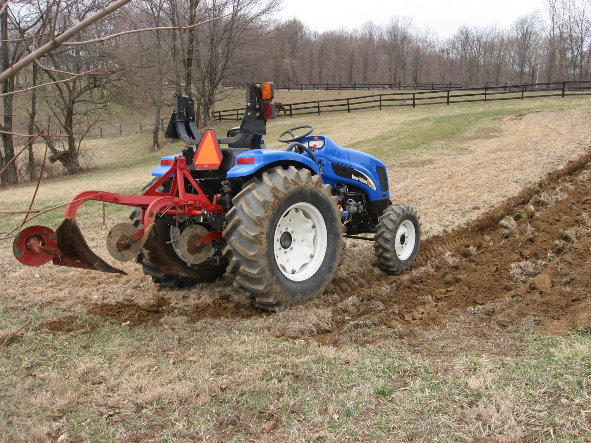

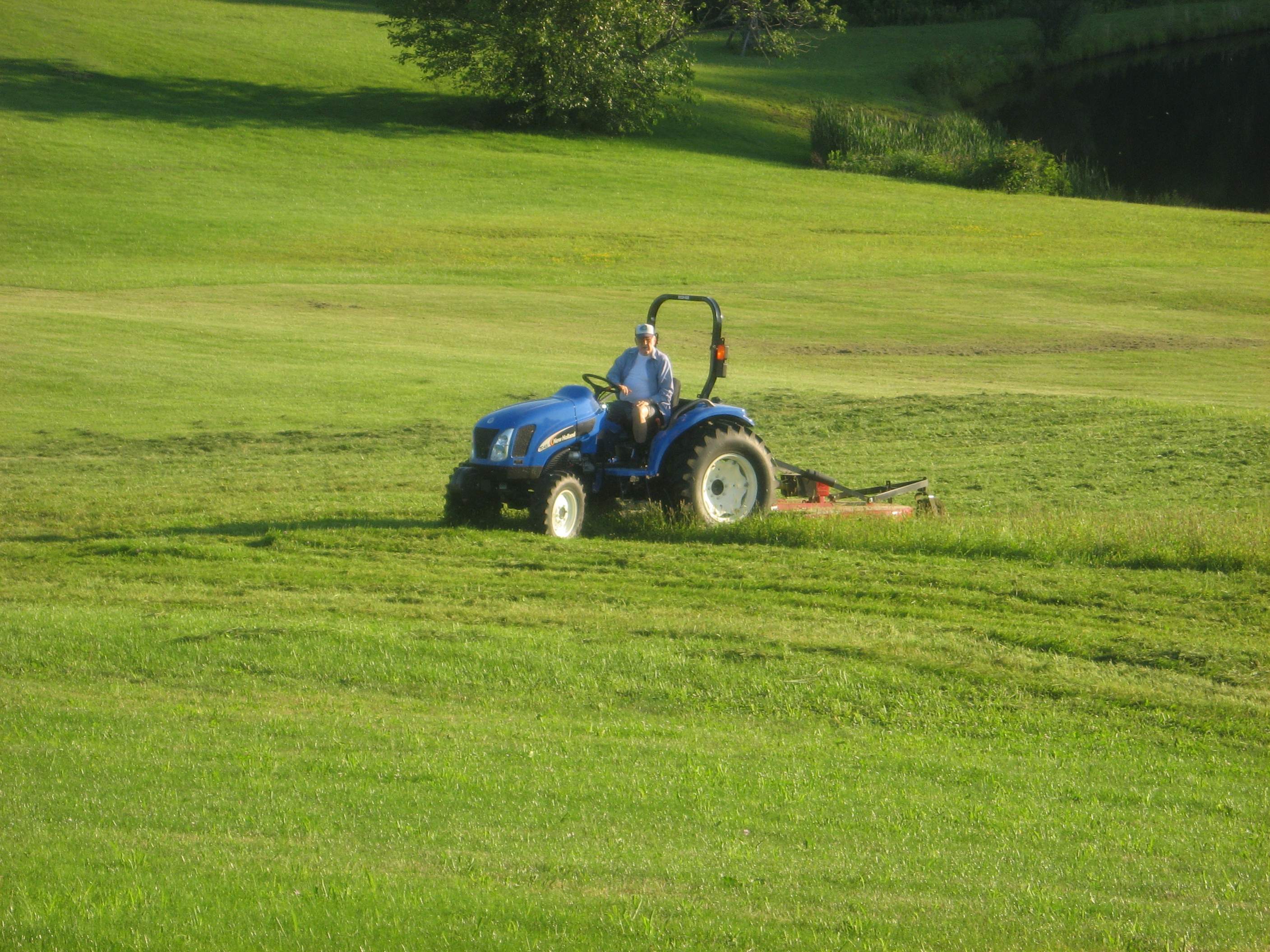

I have R1's and my uncle has R4's and he has 7 more HP. I can flat out work him any day of the week in the woods, snow, or fields. As for loader work we both have them and I can not tell any difference in 8 years for me and 7 years for him. We both mow our yards and I can honestly say my R1's do no more damage than his R4's and the few times he has gotten stuck in the woods or trails he has done lots of damage. I have yet to be stuck.
I would go for R1's unless cost of rims becomes a factor. Yes, R4's look cool but that is where it ends for me. Just look at what real farmers use, that tells the story for me.....
Chris
I have R1's and they do not do any damage to the ground. Been brushogging that field for 6 years now.
The first pic is my dad brush hogging wet ground. They are great for blading snow also. They really dig in.
