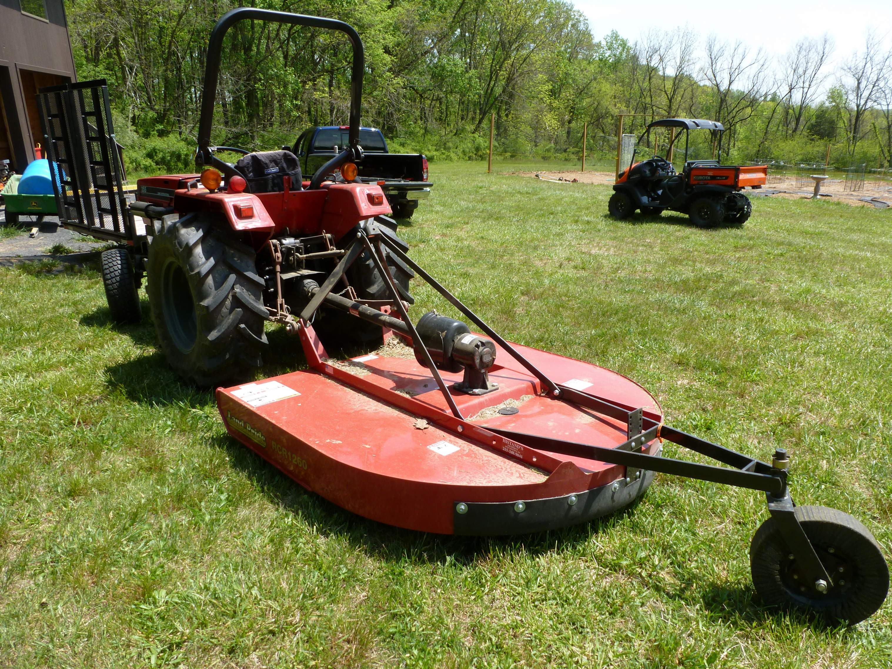

I have a helpful story here, I hope. The oem turf tires on my Case IH were on twenty inch rims, not twenty four like the Ag versions.
I wanted to go ag R1 and did, but it took a lot of studying to figure out the right conversion size. I wound up with pretty wide tires on the tractor which
are simply marvelous for traction and stability. And I made sure the tire height was within a tenth of an inch, so that worked out fine too.
BKT tires, largest tire mfg in India, had what I wanted, where there were few other options.

Daugen,
Did you have to buy new rims as well?

Daugen,
no, which was a big savings; the challenge was finding a twenty inch diameter tire that had a sidewall large enough to make up the
overall height requirement.
