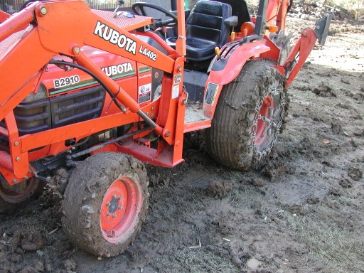

Attached is a picture of my R4s, with 2-link ladder type chains on the rear. The leave a lot to be desired in wet clay. Could be that gumbo mud is different.
The picture shows what clay will do when the ground is wet. Very hard moving around on a slight slope, even with ladder chains on, when your tires morph into slicks. Without the chains "very hard" would change to "just about impossible."
By the way, how does gumbo mud compare to clay?
R1s are to some degree self cleaning. I often wonder if R4s are not self filling... /forums/images/graemlins/shocked.gif /forums/images/graemlins/blush.gif /forums/images/graemlins/grin.gif

Just to add a little more rain to your mud, if you are looking at a small tractor like the CK20 or B7100 then there is no way that you will get through that 18" of mud to get to firm ground. The frame or bell housing will make contact with the ground long before the tires hit firm ground under the mud. I don't know what gumbo mud is but I suspect it is similar to clay and as Henro so aptly illustrated with his photo, an R4 in clay is something similar to a racing slick on a F1 Ferrari. The obvious solution is to wait for the ground to drain before treading on those areas of your property.
