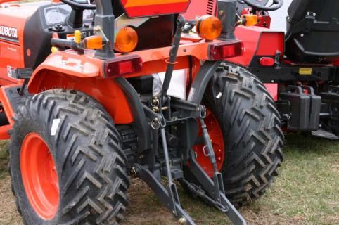

There's a compromise tire that some Kubota dealers are offering called "Bar Turf" tires. I nailed this photo off Carver Equipment's site. The reson I didn't go with these is that:
1) I was concerned they'd wear quickly
2) I figured my regular turfs would be easier on the lawn and I bought chains for the winter and mud

a better photo of bar turf tires

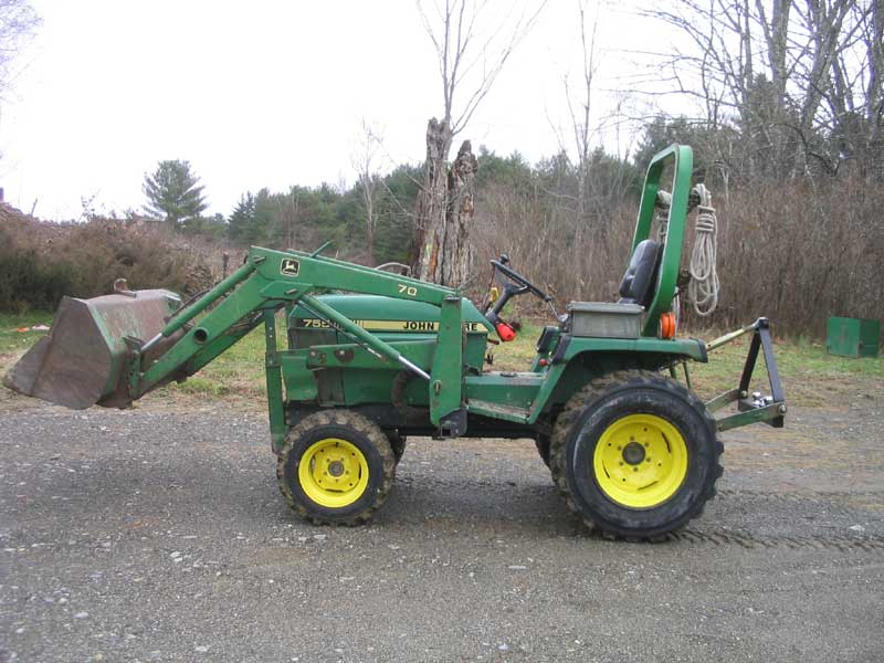

Funny you should mention this. I just replaced the original turf tires on my 1987 JD 755 with new R4s and new rims. I wanted the better tread and the stronger tire construction, and I was having some problems with the tiny front turf tires when using my FEL for heavier work. I went through my JD dealer because I knew that the R4s weren't a standard option on the 755, and it did take some research on their part to determine the correct rim and tire sizes.
Since the R4s have different sizing, you will probably require new rims as well. My new R4s are 23x8.5/12 front and 12x16.5 rear. My old turfs were 20x8.00-10 front, 33x12.5/15 rear.
The new R4s look great, and should preform well too. I don't expect to need tires again for this tractor. See attached photo.
