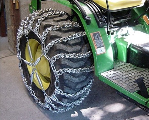

These were only $650 3 years ago.

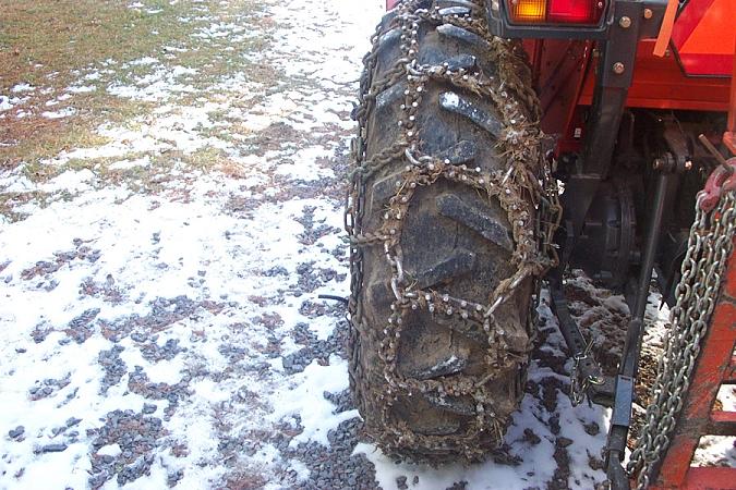

I have a JD 4115, which I believe is the same size as your NH. I had the same problem looking for the right chains to use.
I purchased chains from Tirechains.com like the ones in your second picture. I thought the cross pattern would stop the chains from falling into the lugs. Well take it from me, do not buy this style of chain for your size tractor. This pattern might be great on a much bigger tire, but our tires are to small. This setup leaves to much space between the chains, and it will shake the S**T out of you and your tractor. It was like I had square wheels.
I looked again at tirecahins.com and decided to go with the ladder style for my tractor. I wanted more cross pieces and I wanted the ones with the V-bars. I called them and explained what I needed, and they made up a set for me and I had them in a couple of days. This setup works great because you ride mostly on the chain, so the up and down motion is gone. Very smooth ride and lots of traction. Don't worry about the chains falling into the lugs, these chains are very heavy duty and stick out even when part of them is in between the lug. /forums/images/graemlins/grin.gif

Thanks alot for the reply! I think you just saved me some cash! Your pic is exactly what I'm looking to do.
Obviously you get more snow than I do, besides that what else to you do with the chains on. Do they help? What made you decide to get chains in the first place?

I only use the chains in the winter. I have a long and steep driveway that gets a good bit of ice build up. I would be all over the place without them on. If you do get a set like mine, go with the V-Bar they are great on ice.
When you get your set, it will need to be shortened a bit. I cut the stock fasteners off cause i thought they were a pain in the A**. I went out and bought 4 C-Links with screw closures. These work great as long as you have enough slack to work with. You can see them in my pic.
The first time you put them on, it will take you a little time, at least it did me. Now I can have them both on in less then 15 minutes.
