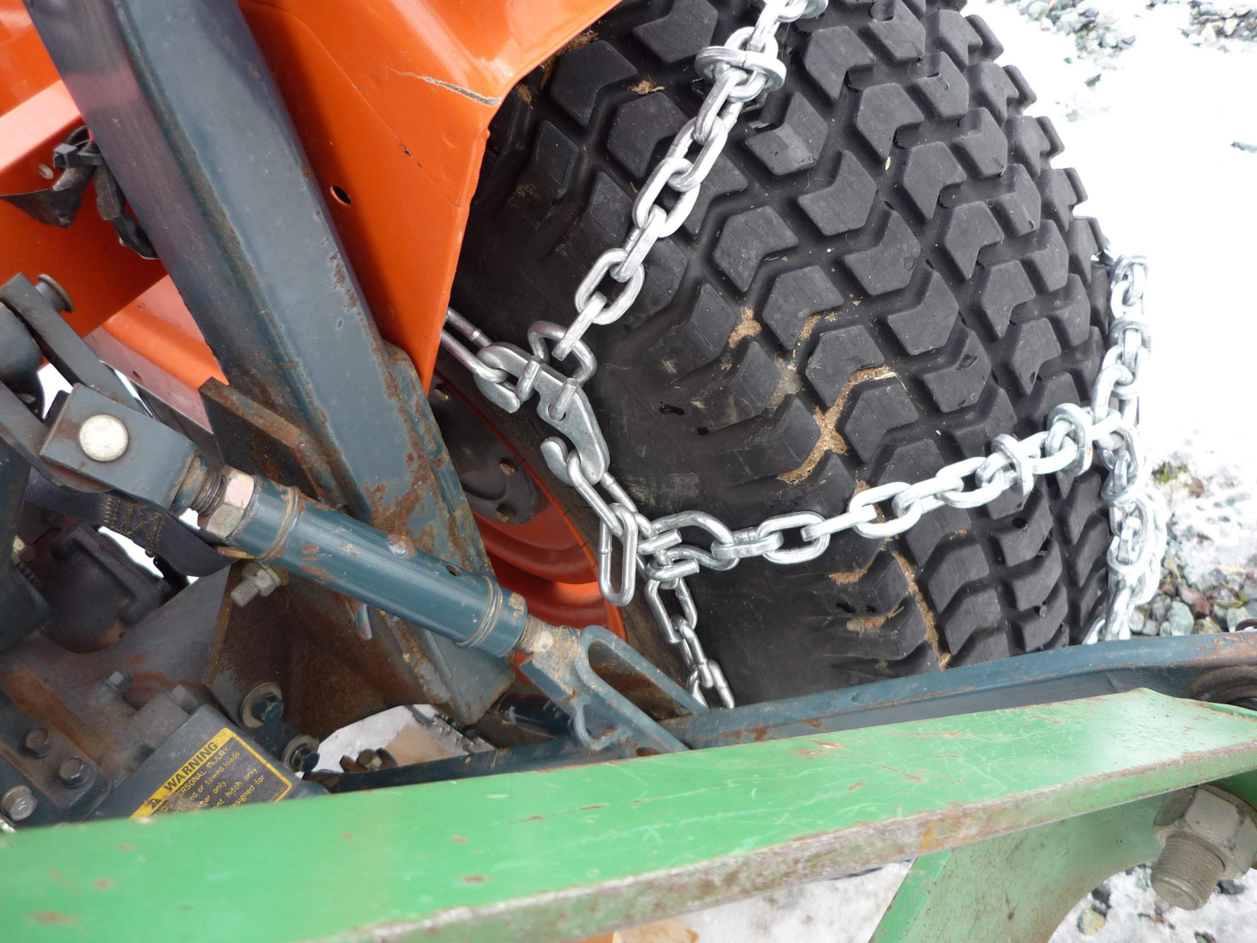

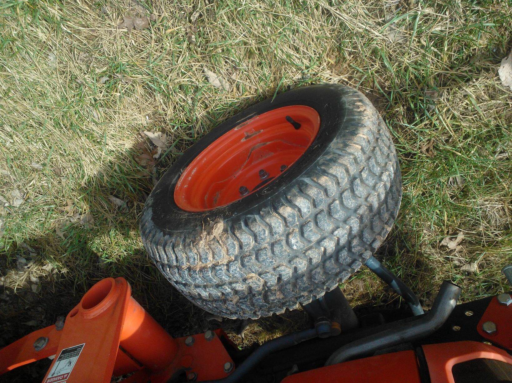

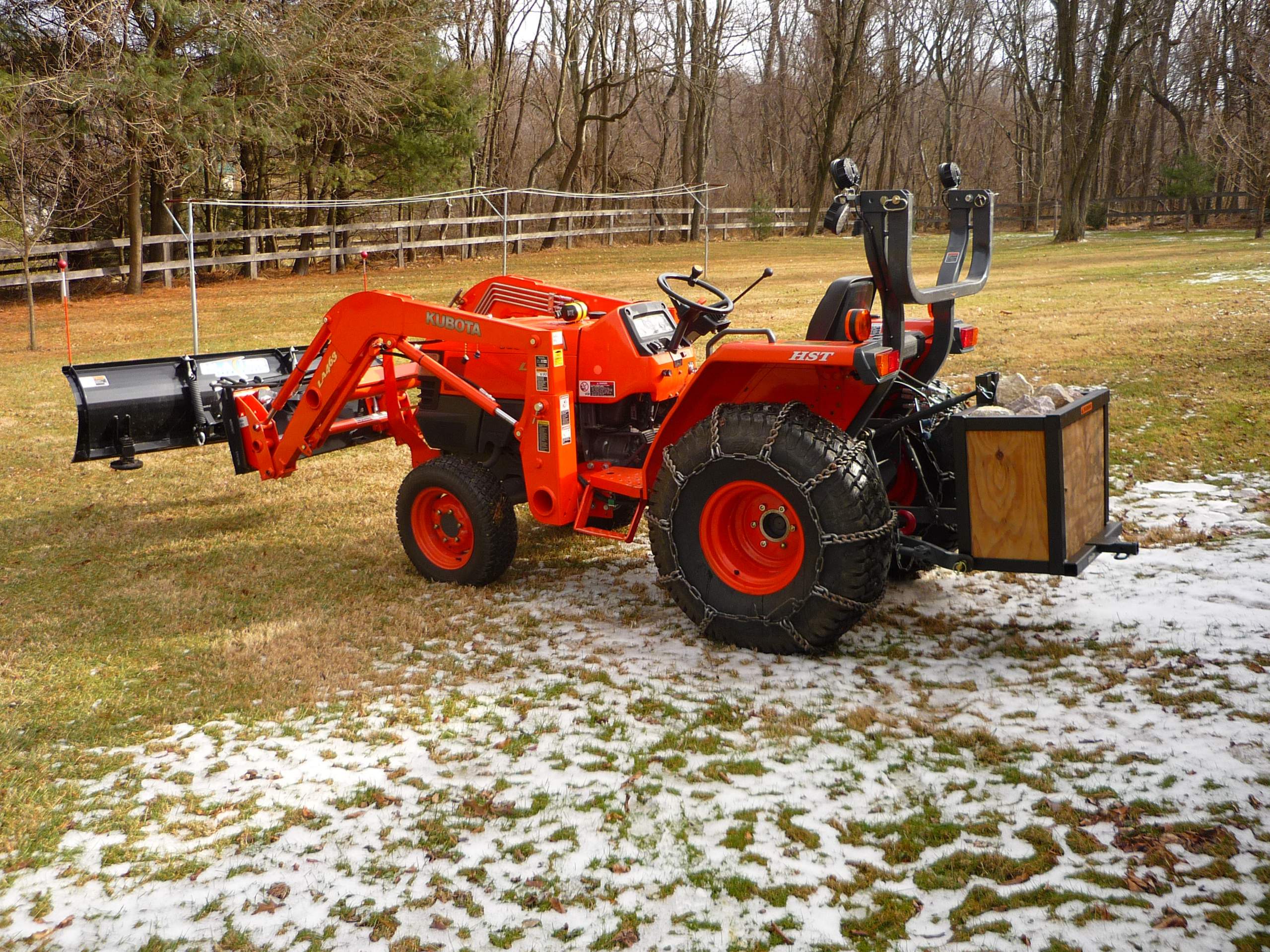

I was thinking of the center photo tires, "turf tires" which is more or less what I had on my B8200 and now on my L3400. Like threepoint said, great for grass, snow and rough ice. Your front tires are similar to my present turfs, front and rear. Not that it would help, but I can add a photo- sorry it isn't more clear on the tread. The photo of the chained tire is from the old B8200. I find I need chains when the packed snow turns into ice, especially partially melted, wet ice.

BTW, with snow clearing, you'll want weight on the 3PH (unless you're going to use a 3PH snow blower). Any tractor will lose traction if there's not enough weight on the back for tires to get a good bite.
