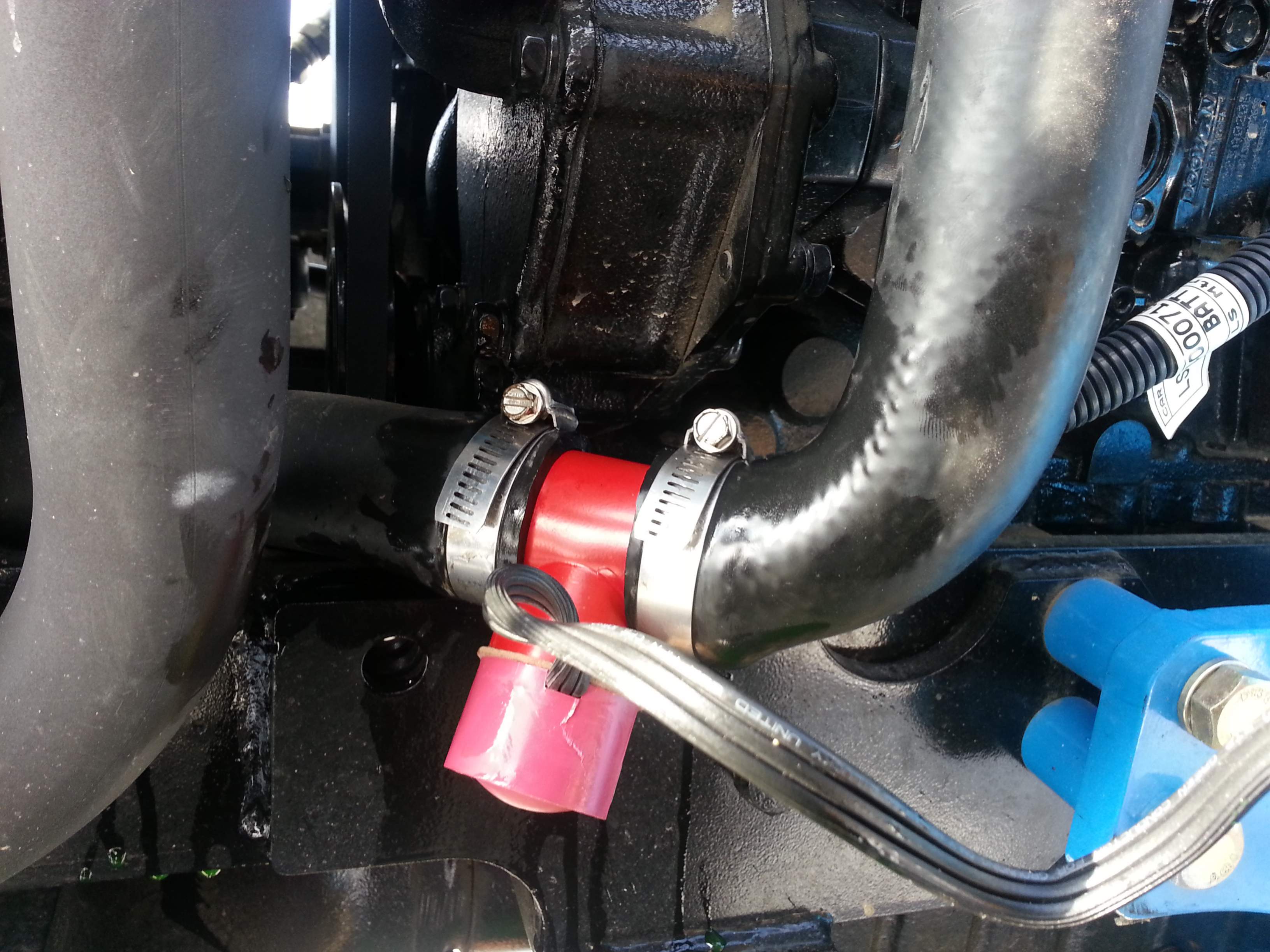

Thought I would post some pics of the radiator hose heater install on my R4041. Looks like no one has installed one since I didn't get any replies to my post, maybe this will help anyone else thinking about a lower radiator hose heater.

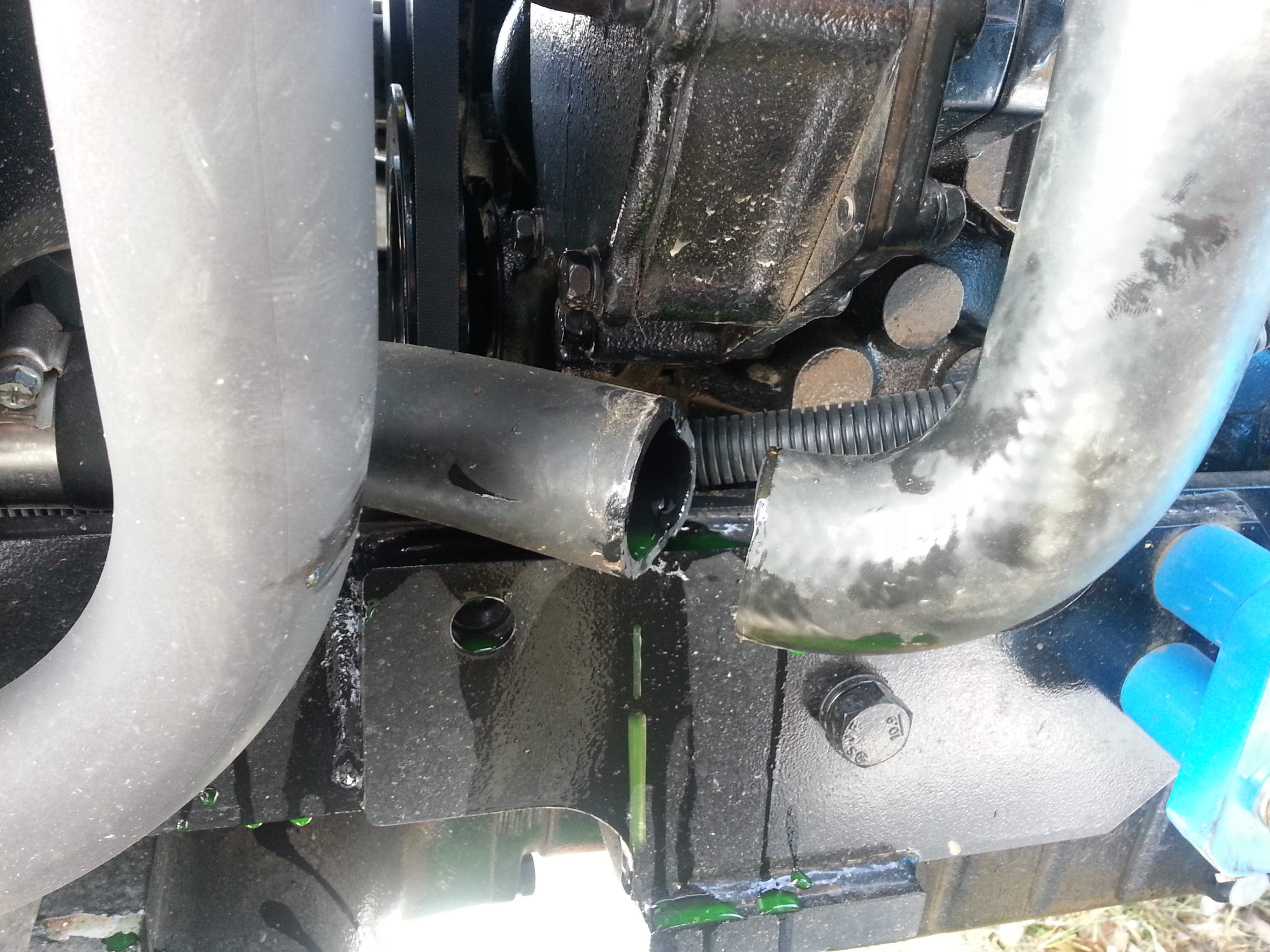

Best spot looked like just past the frame rail before the hose turned up to the water pump
1" Cut out of hose

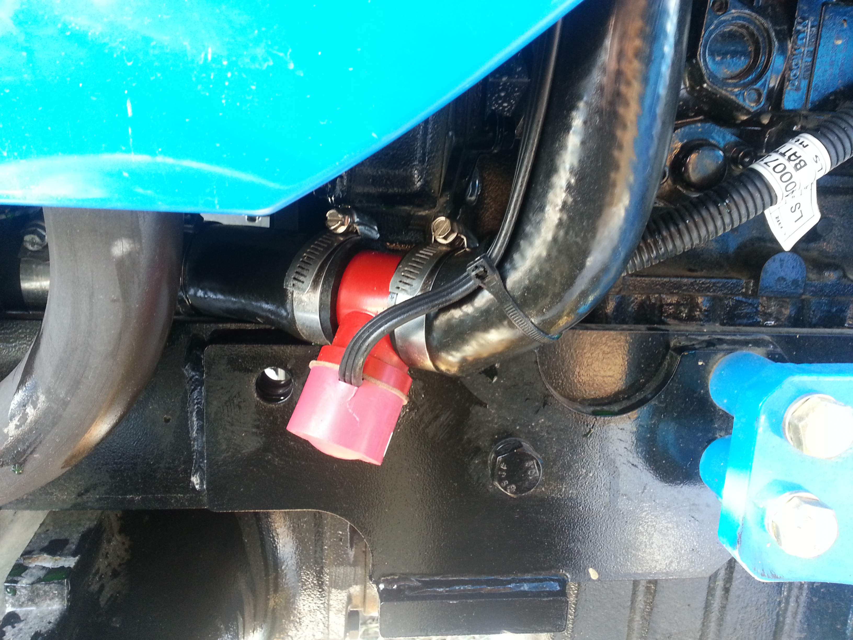

Heater installed
With the hood closed. Wire tied cord up hose than over the air intake and water separator to back of engine compartment.

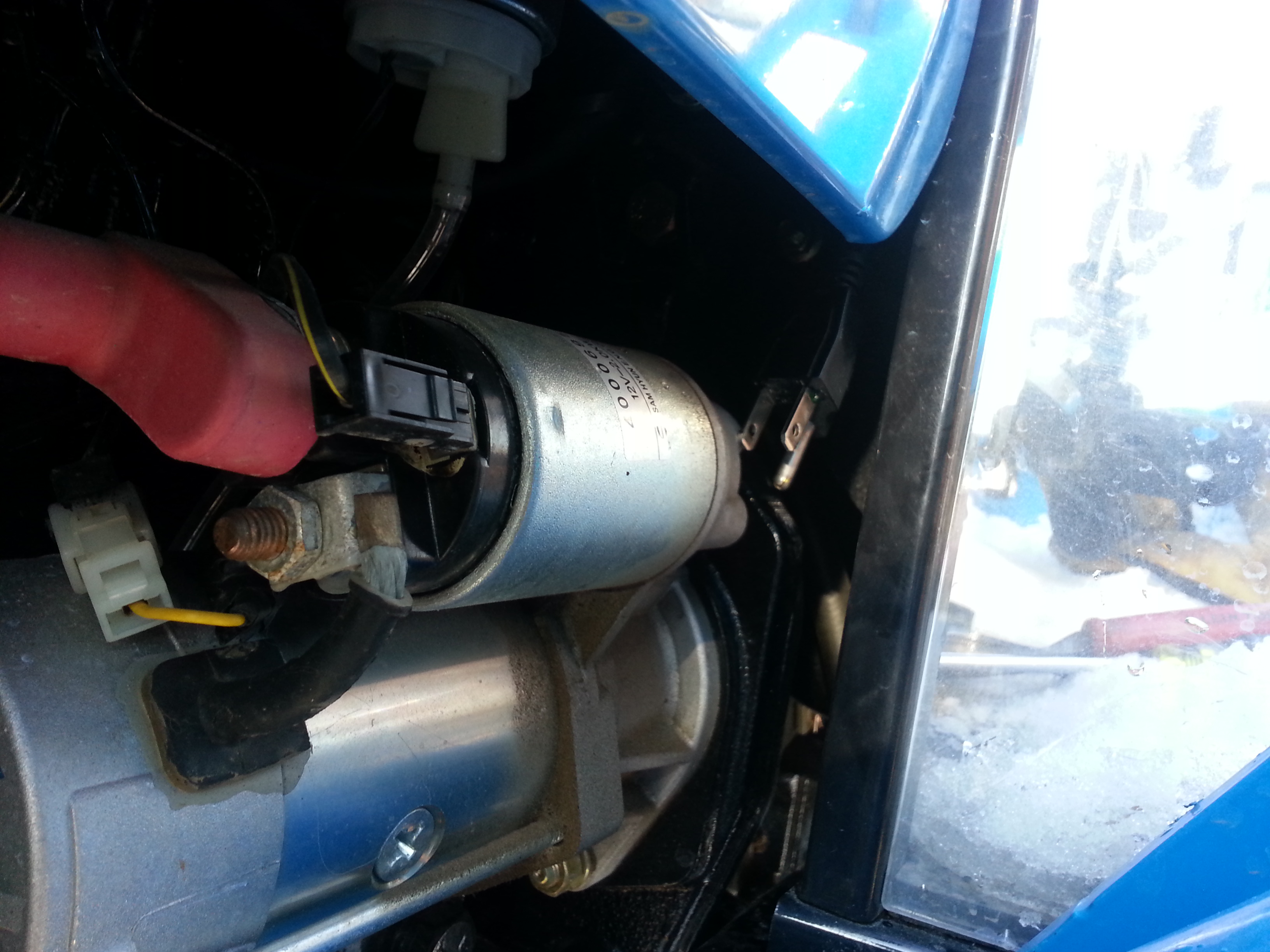

Plug tucked in just above starter and out of the way from any snags.

Finally had a chance to test the heater today, it was below freezing for the first time in days (20F). Had the heater plugged in for 2 hours and the lower hose was more than warm but not quite to hot to touch and the block at the goose-neck (T-stat) was warm. In the video you can see and hear there was no smoke and only normal knocking. So far very pleased with how the heater worked. Will have to wait and see how durable it is. @ Gale; there was nothing in the instructions about the placement of the plug, that was just what worked best for my application.
